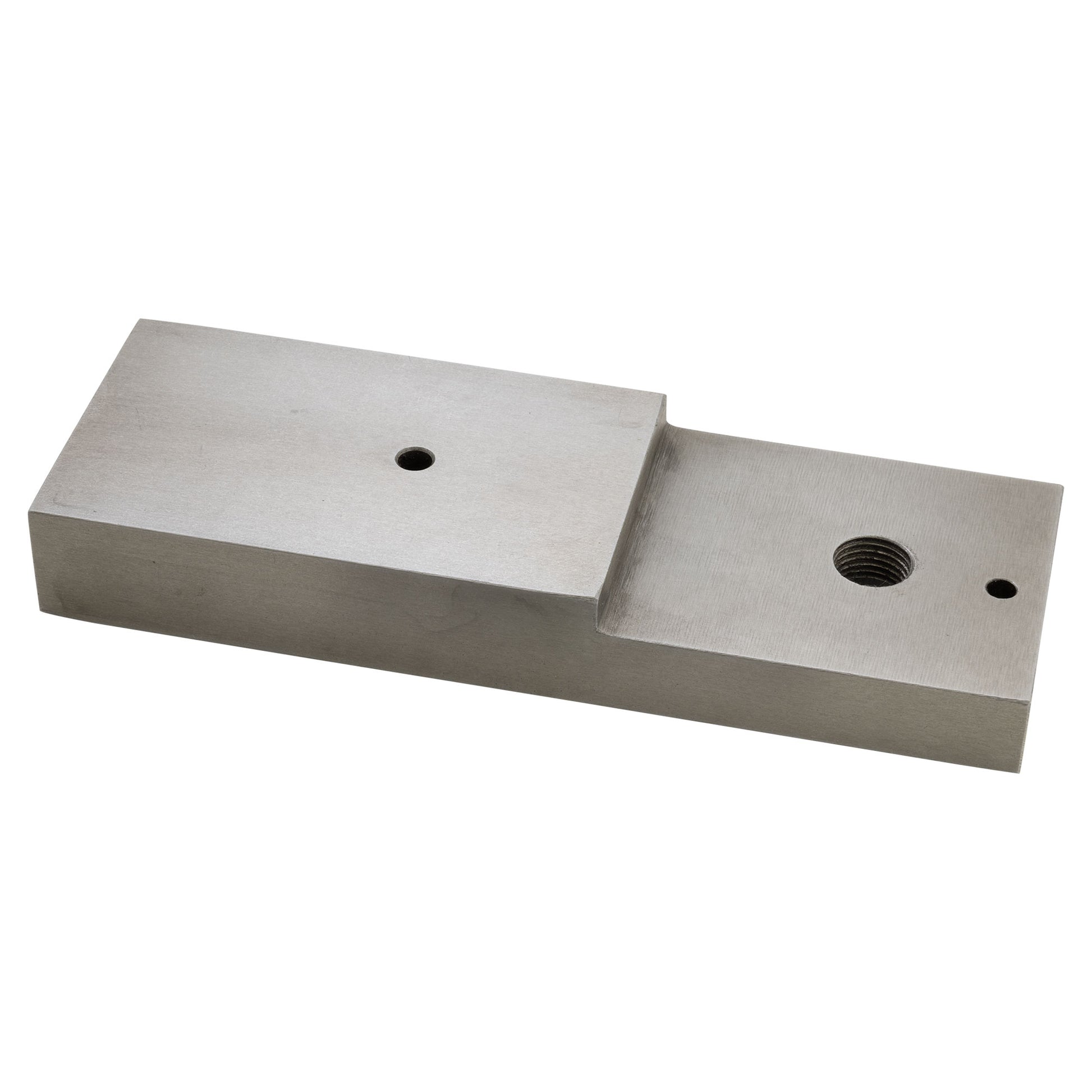

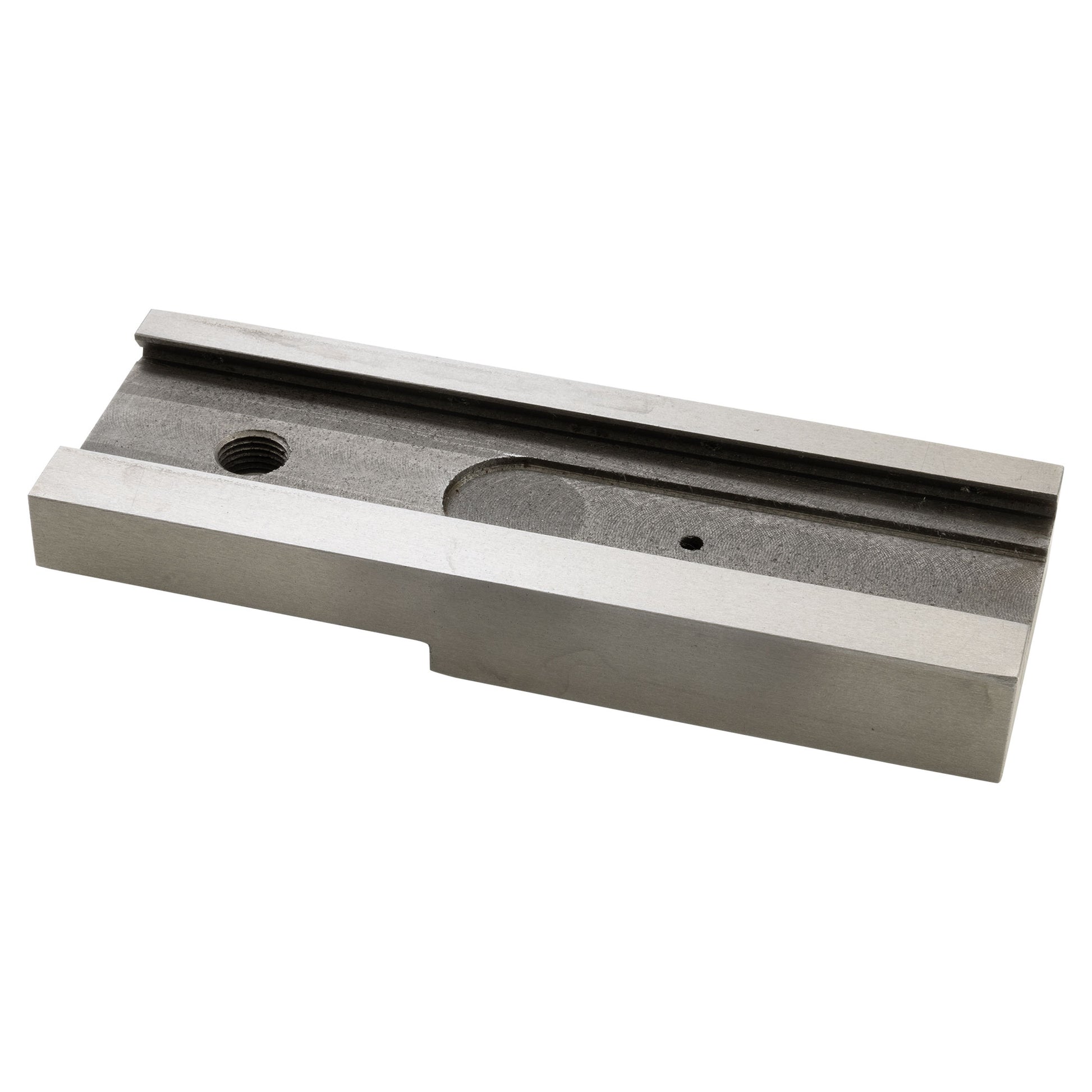

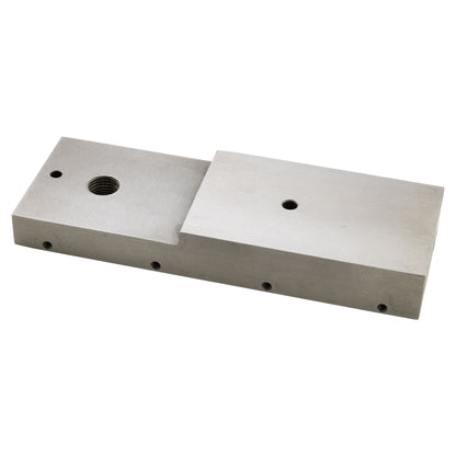

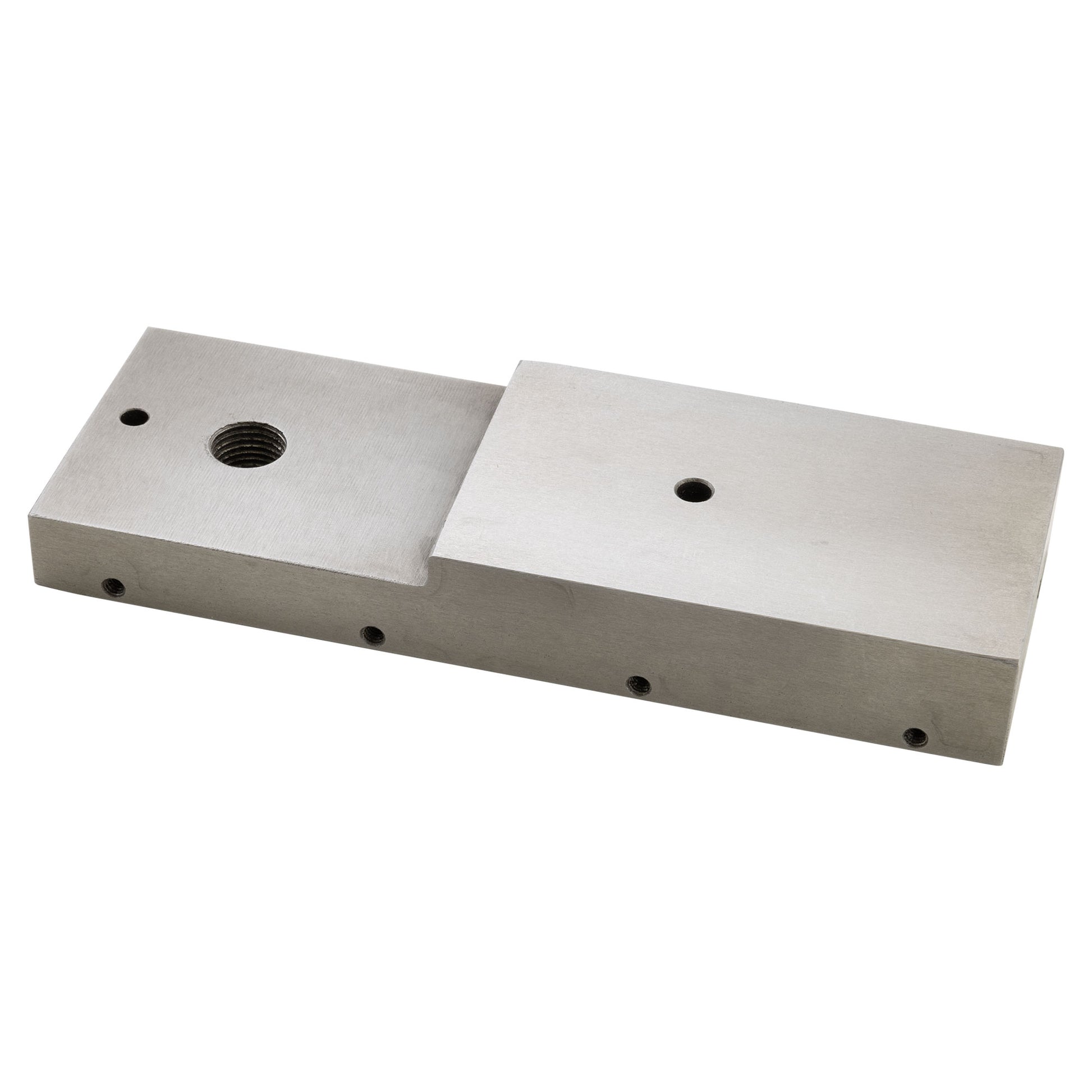

  • Bench lathe compound rest to hold a AXA QCTP
  • Threaded 9/16-18 for AXA quick change tool post
  • Fits SIEG C4, SC4, and HiTorque bench lathes
  • 6mm oil fitting (Not Included)
This is the compound rest top that comes equipped on the HiTorque Deluxe bench lathes.
This compound rest top is specially modified to mount the AXA quick change tool post on a HiTorque 8.5x16 or 8.5x20 Bench Lathe or a SIEG C4 or SC4 lathe. The threading is 9/16-18 to support an AXA quick change tool post.
If replacing a bench lathe standard tool post with an AXA QCTP, see the compatibility tab for reference to machines that are compatible with this product.
*NOTE: If you have a newer 9x20 HiTorque Bench Lathe please order part 6573 (http://lmscnc.com/6573)
Length: 6.693" (170 mm)
Width: 2.362" (60 mm)
Tall Section Length: 3.937" (100 mm)
Narrow Section For Tool Post - Length: 2.756" (70 mm)
Tall Section Height: 0.945" (24 mm)
Narrow Section For Tool Post - Height: 0.669" (17 mm)
Threaded Hole: 9/16"-18
