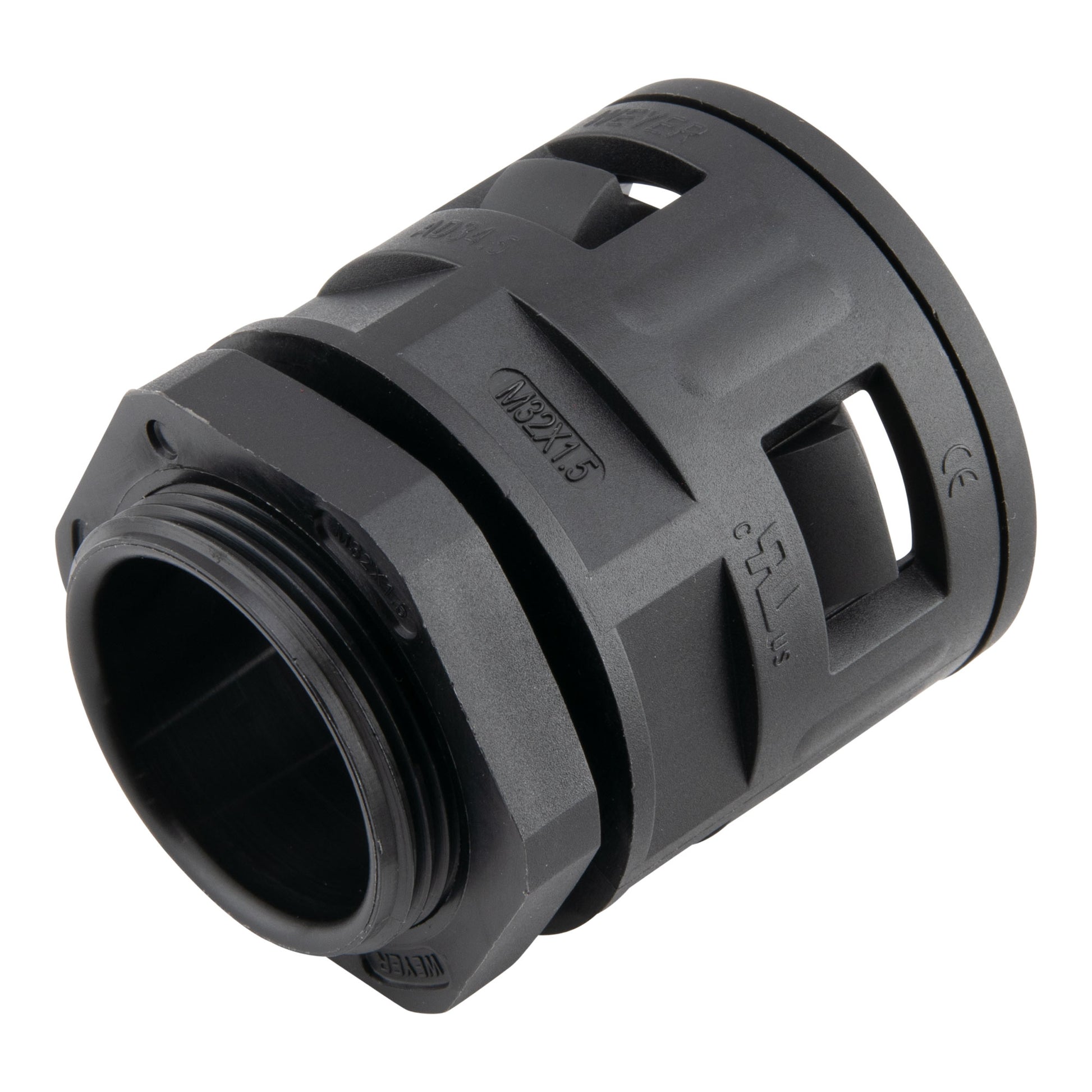

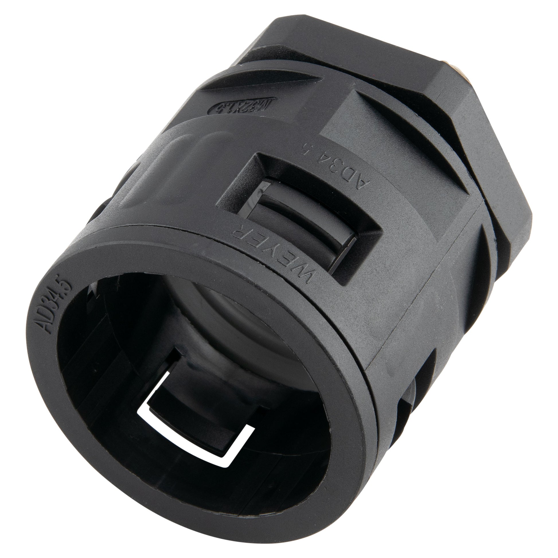

  • Flexible tube quick connector, fits 34.5 mm tubing
  • Thread size M32 x 1.5
  • Threaded stem is 15 mm, overall length 51 mm
  • Easy to install
  • Made of flame-retardant Polyamide, black
Flexible conduit connector for HiTorque Bench Mill power line. This piece fits bench mills with the newer control box such as model 6500 and 6550. For the older control box on models 5500 and 5550, use the 28.5 mm connector part #5777.
Quick screw connector. Thread size M32x1.5, fits tubing size AD34.5. Threaded stem is 15 mm, overall length 51 mm. Wrench size 40 mm.
Easy installation, no need for welding, gluing or tools, resulting in a good seal that is safe and reliable. Can be quickly disassembled or reused.
Made of flame-retardant Polyamide, black. Temperature range is -40°C to 100°C. Self-extinguishing, free of halogen, phosphor and cadmium, passed RoHS. Protection degree is IP66.
Model: WQG1-M32B/AD34.5
Thread Dimensions: M32×1.5
Outside Dimensions: 1.732" (44 mm)
Internal Diameter Threaded Section: 1.024" (26 mm)
Fits Tubing Size: AD34.5
Thread Length: 0.591" (15 mm)
Total Length: 2.008" (51 mm)
