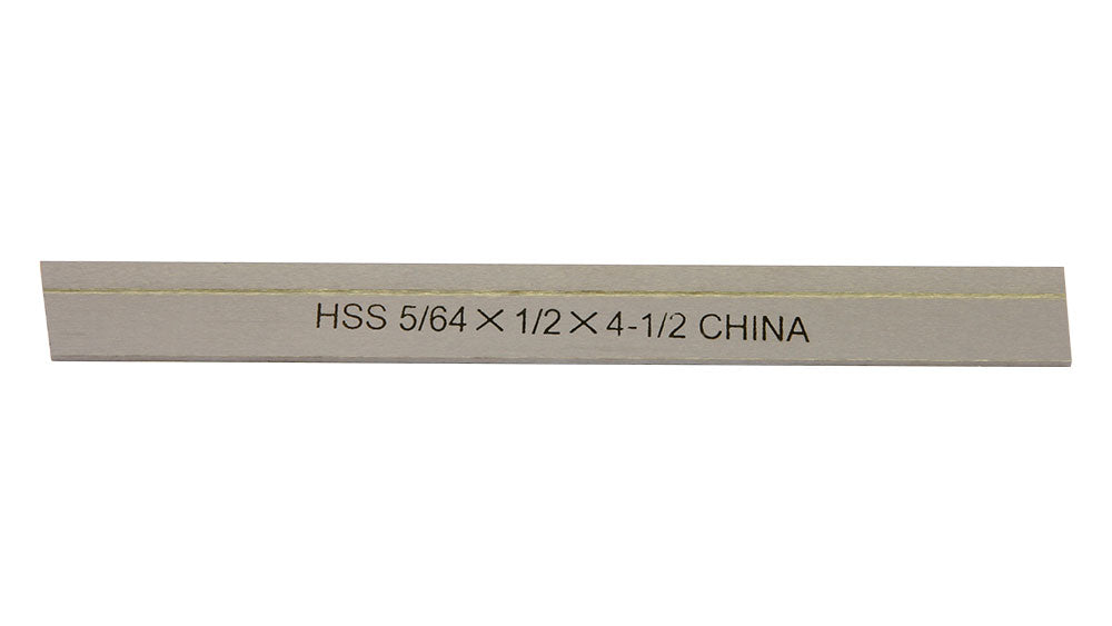

  • This blade is size P1X
  • High speed steel
  • Width: 5/64", Height: 1/2", Length: 4-1/2"
Our Lathe Cut-Off Blade is made with M2 high speed steel, ensuring a long-lasting and reliable performance.
It measures 5/64" x 1/2" x 4-1/2" and is perfect for all your lathe cutting needs.
These blades are considered T-Shaped and provide great side clearance while the M2 high speed steel provides excellent wear resistance. Whether you're a professional machinist or a DIY enthusiast, you can trust in the quality of our Lathe Cut-Off Blade for all your machining tasks.
M2 high speed steel is a popular choice for cutting tools due to its ability to maintain a sharp edge at high temperatures and its resistance to wear and deformation. It is made by adding molybdenum and tungsten to a basic high carbon steel alloy, resulting in a tool material that is tough and durable. Our Lathe Cut-Off Blade is made with this top-quality material, ensuring that it can handle even the most demanding machining tasks.
P-type cut-off (or parting) blades are T-shaped (don't ask). Because the body of the tool is narrower than the cutting tip, friction is reduced making the difficult task of parting off somewhat easier.
Size P1 blades are 1/16" wide and are the most commonly-used size. P1N blades are 0.040" wide. These thinner blades are good for small work. P1X blades are 5/64" wide. Use these thicker blades for parting off larger diameters where you need additional stiffness.
It is easier to part off large diameters if you cut a groove that is wider than the cut-off blade. First, make a cut about 0.100" deep. Now back out and move over at least 0.010". Cut in again, widening the slot. Continue with this cut until you are 0.100" deeper than the first slot. Repeat this process, moving back and forth, until you are through.
