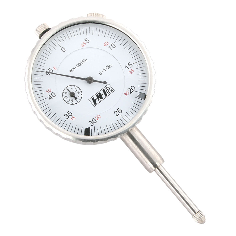

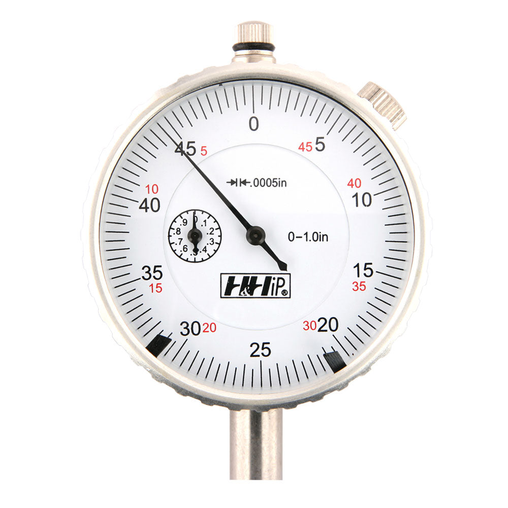

  • 0-1" dial indicator with 0.0005" resolution
  • AGD Group 2
  • 2.25" Diameter face, 0.375" shank, #4-48 tip thread
This 1" stroke dial indicator features large, easy to read numbers and crisp graduations. Each revolution is 0.050", indicated by the revolution counter. The resolution is 0.0005". There is a mounting lug on the back of the case.

At rest, an indicator’s needle points at a random position, usually in the 10 o’clock range. This is completely normal, as the needle’s position at rest is irrelevant to the use of an indicator.
An indicator is only useful when the tip is bearing against a surface to be measured. The action of pressing the tip against the surface moves the needle, also to some random position. But this position is relevant; turn the bezel so that the needle is pointing at zero. Now you can make measurements, both positive and negative, relative to the starting position.
Range: 0" - 1" (0.000 mm - 25.400 mm)
Resolution: 0.0005" (0.013 mm)
A.G.D. Group: 2
Face Diameter: 2.25" (57.150 mm)
Shank Size: 0.375" (9.525 mm)
Thread Tip: #4-48
Dial Reading: 0-50-0
Revolution: 0.050" (1.270 mm)
Type: Lug backing
Dial Face: Continuous Dual Reading
