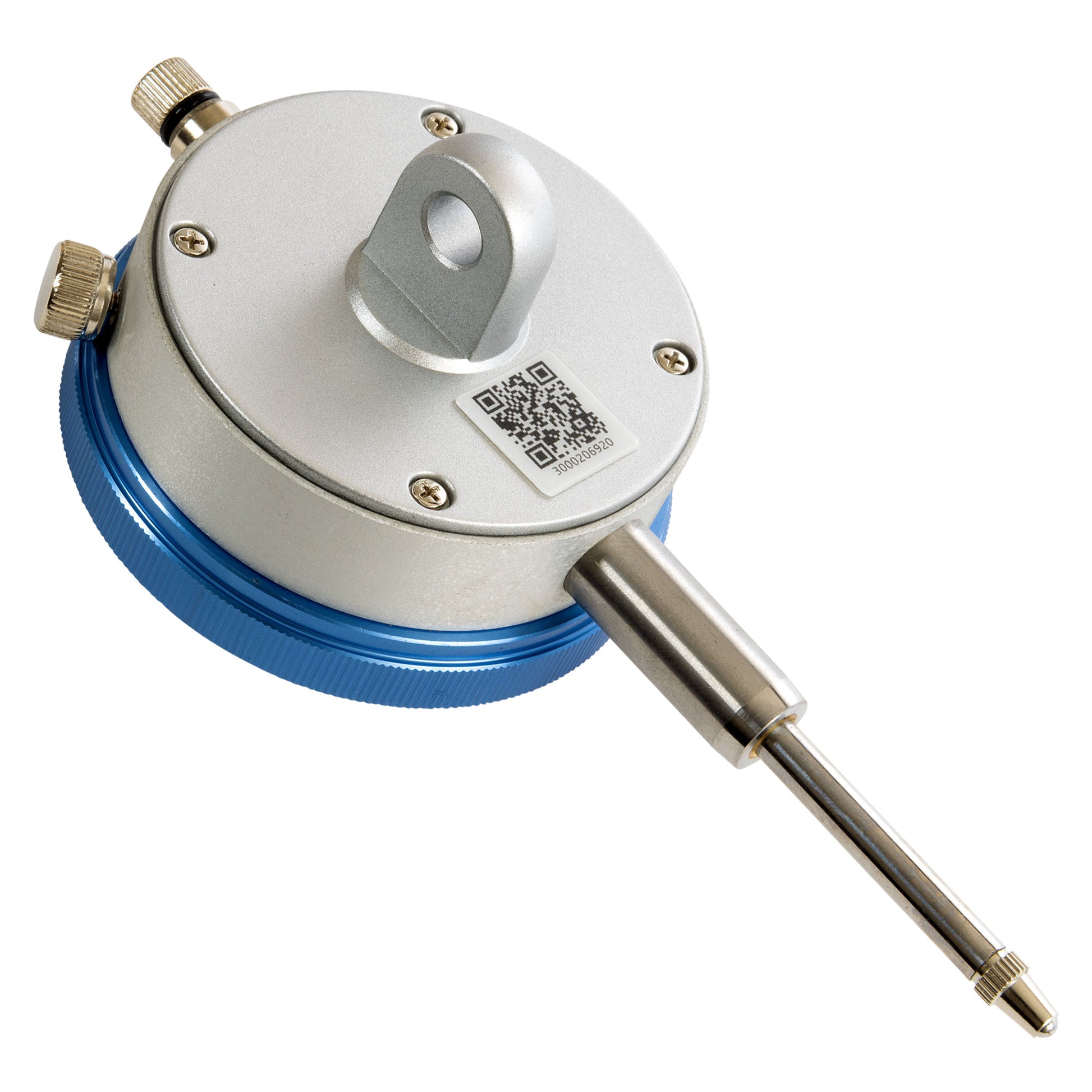

  • Lug Back

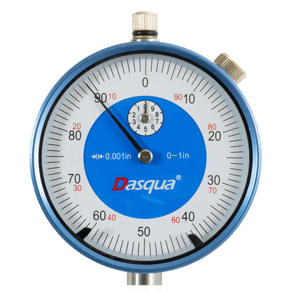

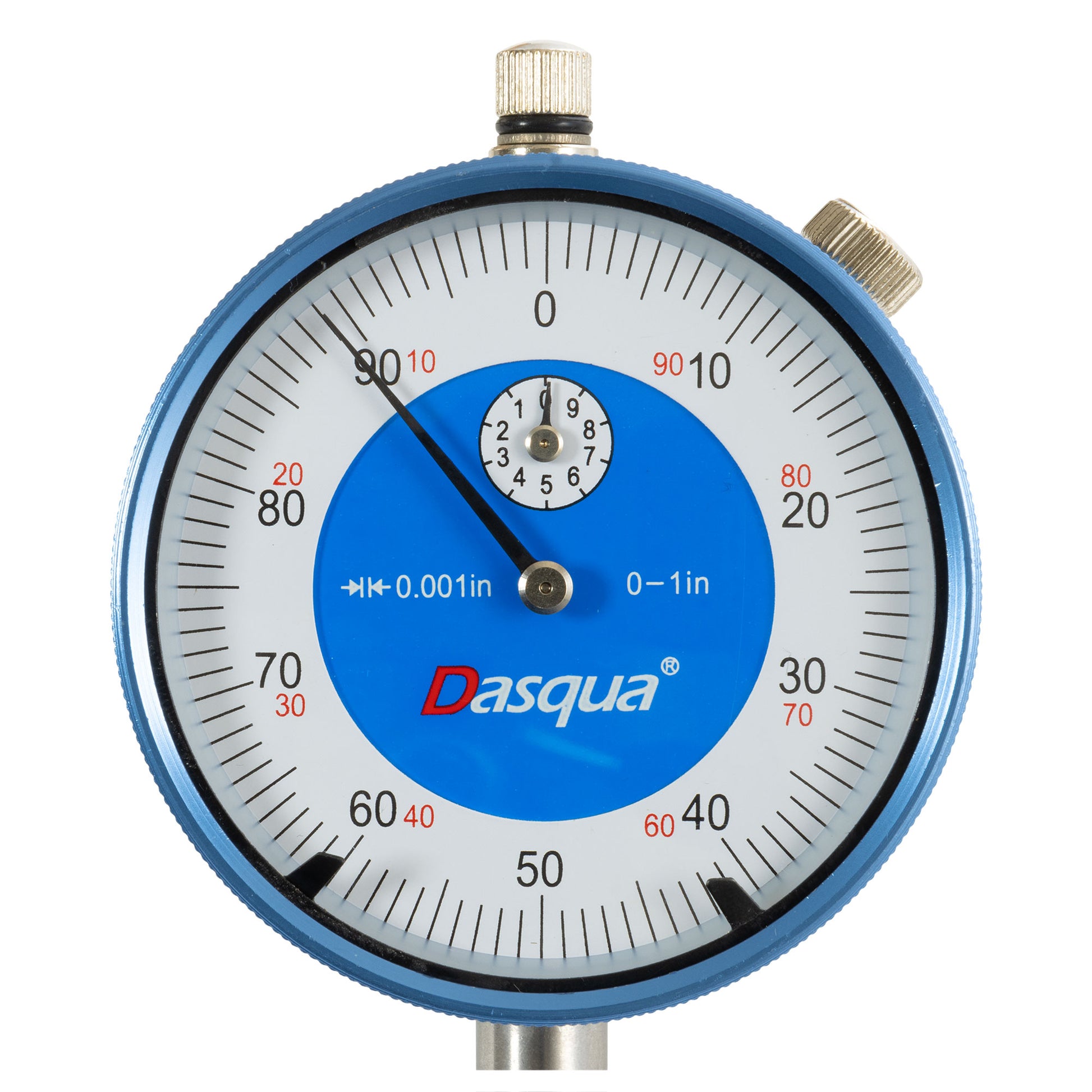

Dasqua 1" Lug Back Large Measuring Range Dial Indicator. This 1" stroke dial indicator features large, easy to read numbers and crisp graduations. Each revolution is 0.100", indicated by the revolution counter. The resolution is 0.001".

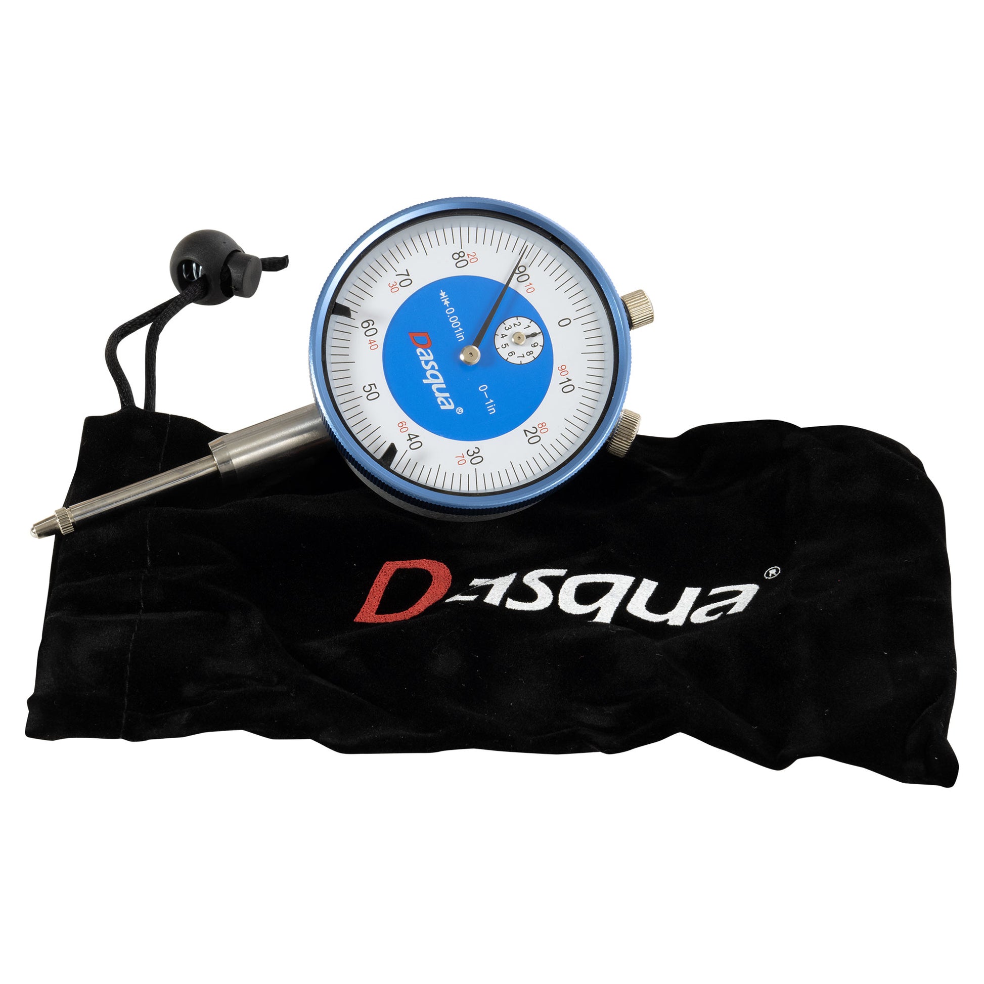

At rest, an indicator’s needle points at a random position, usually in the 10 o’clock range. This is completely normal, as the needle’s position at rest is irrelevant to the use of an indicator.
An indicator is only useful when the tip is bearing against a surface to be measured. The action of pressing the tip against the surface moves the needle, also to some random position. But this position is relevant; turn the bezel so that the needle is pointing at zero. Now you can make measurements, both positive and negative, relative to the starting position.

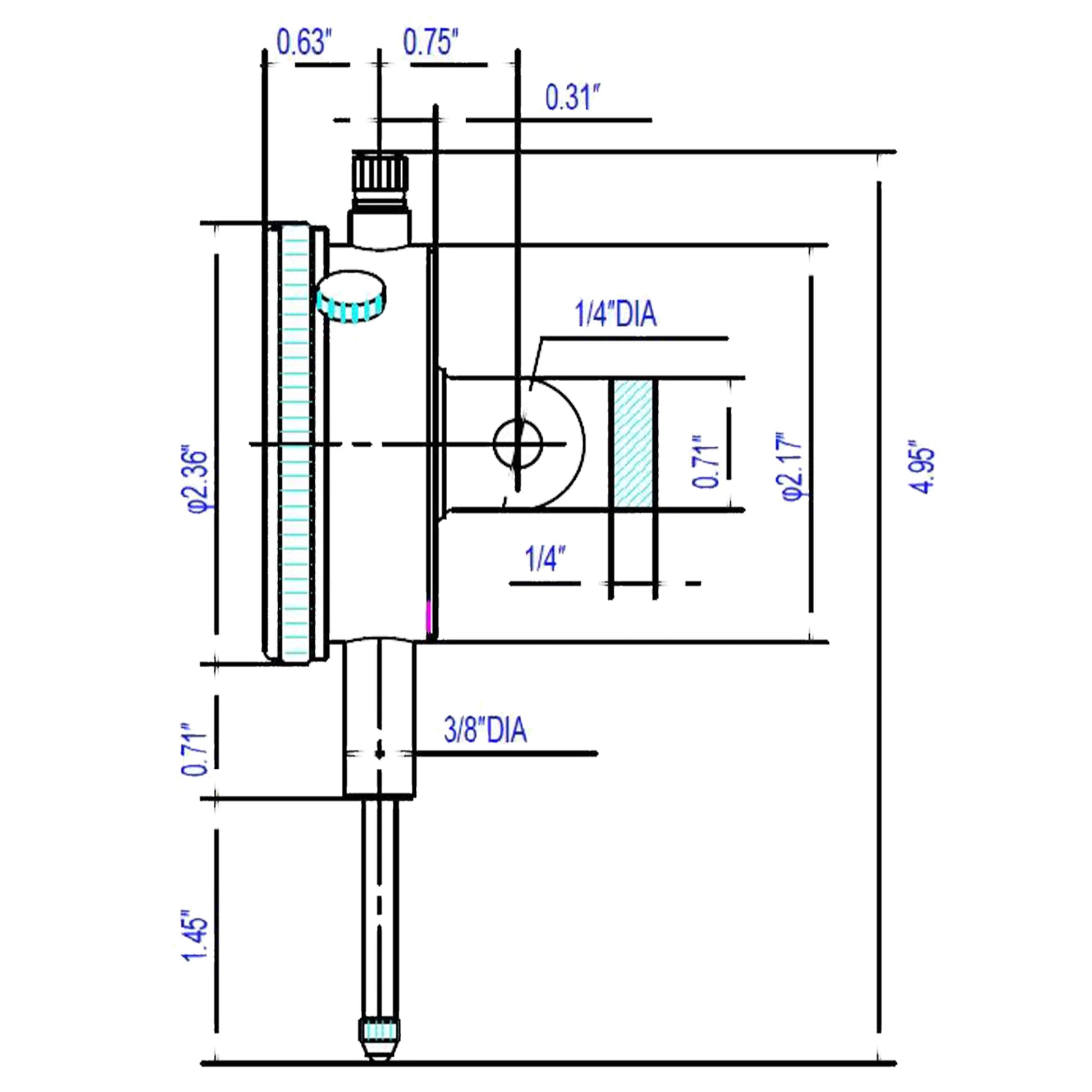

Range: 0" - 1" (0.000 mm - 25.400 mm)
Resolution: 0.001" (0.025 mm)
Face Diameter: 2" (50.800 mm)
Shank Size: 0.375" (9.525 mm)
Thread Tip: #4-48
Dial Reading: 0-100-0
Revolution: 0.100" (2.540 mm)
