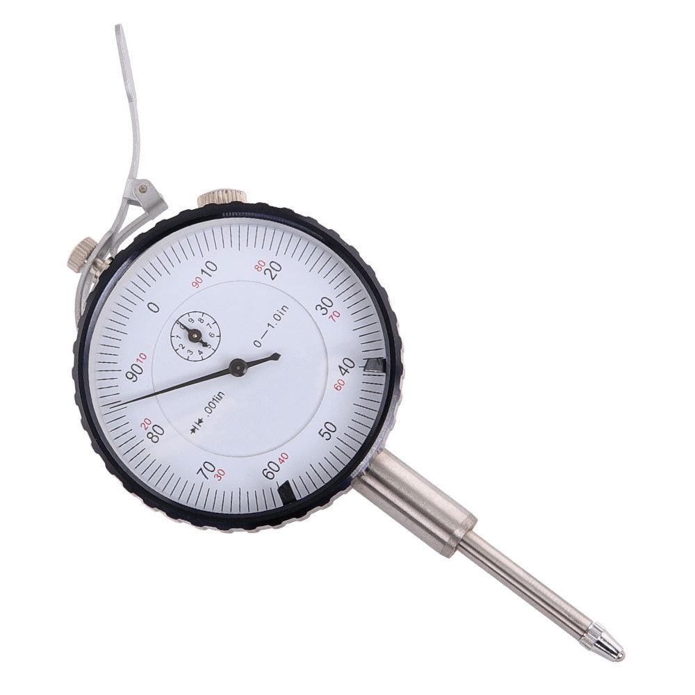

  • 0-1" Dial Indicator with 0.001" Resolution
  • ADG Group 2 - 2" Diameter Dial Face

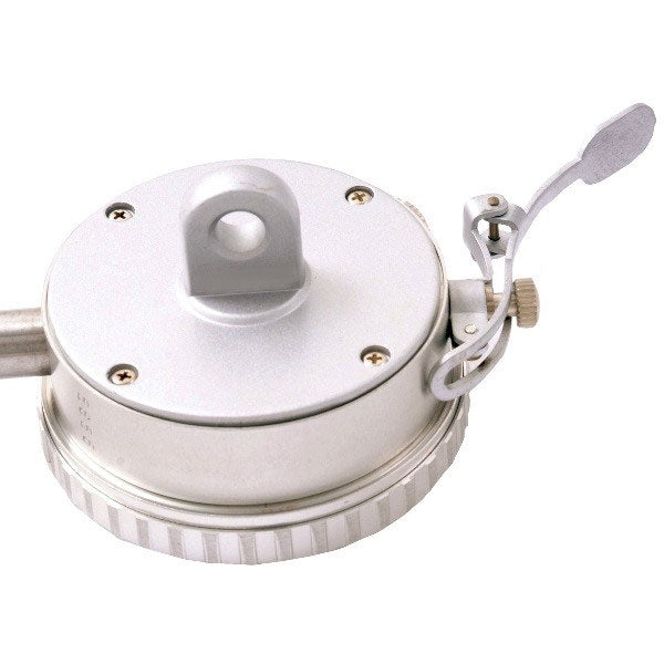

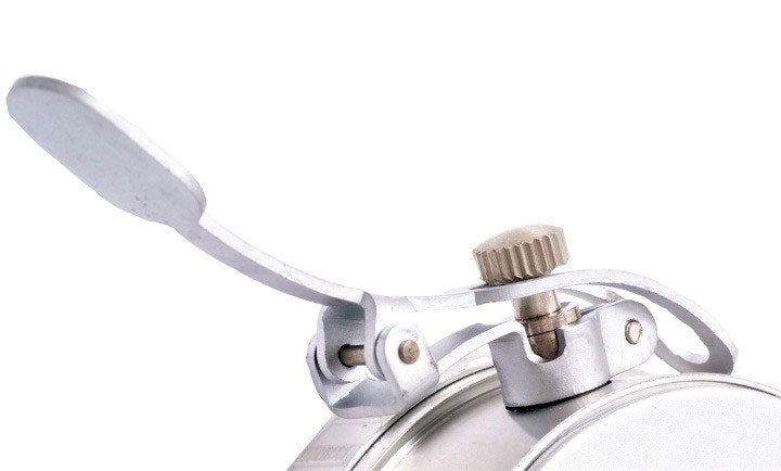

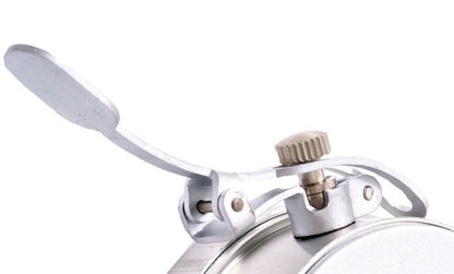

  • Lifting Lever, 0.375" Shank, #4-48 Tip Thread
  • Lug Back
  • Jeweled Movement

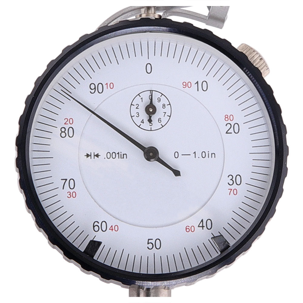

This 1" stroke dial indicator features large, easy to read numbers and crisp graduations. Each revolution is 0.100", indicated by the revolution counter. The resolution is 0.001". There is a mounting lug on the back of the case.
The indicator comes with an equipped lifting lever attached to the top end of the spindle. This improves inspection efficiency and accuracy when using the indicator on a mounted stand. With a lifting lever, the spindle can easily be raised in small increments as material is moved under the spindle.

Range: 0" - 1" (0.000 mm - 25.400 mm)
Resolution: 0.001" (0.025 mm)
A.G.D. Group: 2
Face Diameter: 2" (50.800 mm)
Shank Size: 0.375" (9.525 mm)
Thread Tip: #4-48
Dial Reading: 0-100-0
Revolution: 0.100" (2.540 mm)
