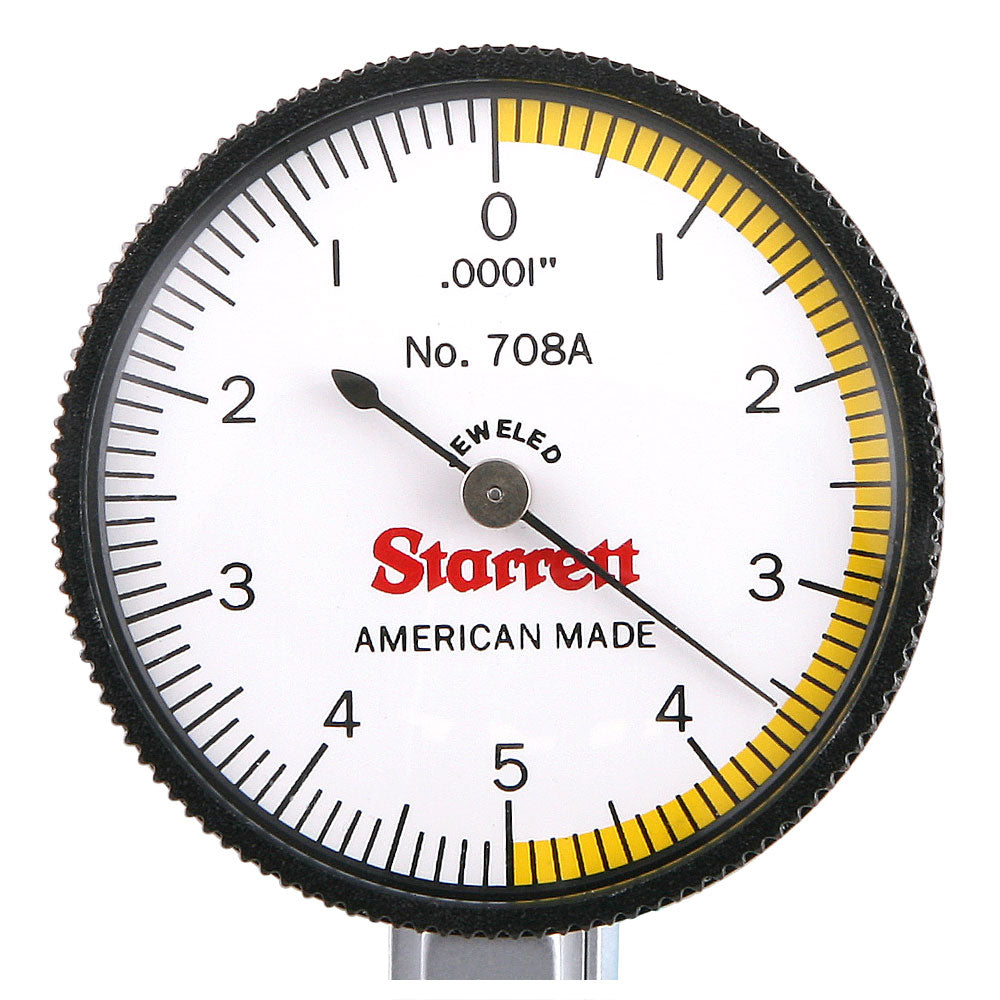

  • Starrett dial test indicator with dovetail mount
  • Starrett catalog number 708AZ
  • Dial test indicator with 0.0001" graduations
  • Range is 0.010"

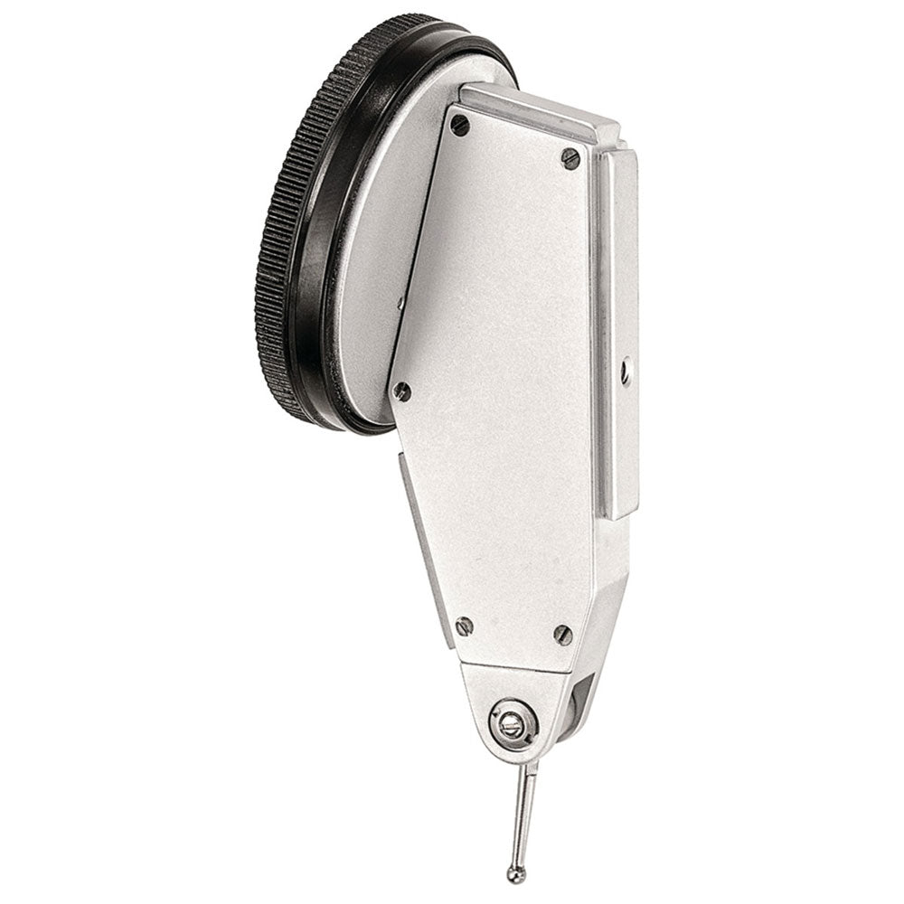

These precision test indicators were designed to be positioned for easy and accurate readability. The versatility of the angled head, combined with the three dovetail mounts eliminates the need for having both vertical and horizontal style test indicators. These are the features that make this series of test indicators superior to ordinary types.
  • Angled head for better reading position
  • Large 1 3/8" (35mm) dial diameter
  • Precision gear-driven design with smooth, jeweled movement
  • Meet or exceed ISO accuracy specification
For extreme accuracy we recommend positioning the lever contact so that it is approximately 15° from being horizontal with the workpiece. Three dovetail positioning mounts work with existing test indicator accessories
  • Contact point reverses automatically, always maintaining clockwise hand rotation
  • Narrow body for inreach ability
  • Satin chrome finish for durability
  • Long carbide contacts 13/16" (20mm) are furnished as standard.
  • Contacts are frictionally adjustable and replaceable
Inch reading indicators are available with easy-to-read, shaded white, solid red, or solid black dials - millimeter reading indicators with solid yellow dials
At rest, an indicator’s needle points at a random position, usually in the 10 o’clock range. This is completely normal, as the needle’s position at rest is irrelevant to the use of an indicator.
An indicator is only useful when the tip is bearing against a surface to be measured. The action of pressing the tip against the surface moves the needle, also to some random position. But this position is relevant; turn the bezel so that the needle is pointing at zero. Now you can make measurements, both positive and negative, relative to the starting position.
Range: 0" - 0.010" (0.000 mm - 0.254 mm)
Resolution: 0.0001" (0.003 mm)
Dial Reading: 0-5-0
