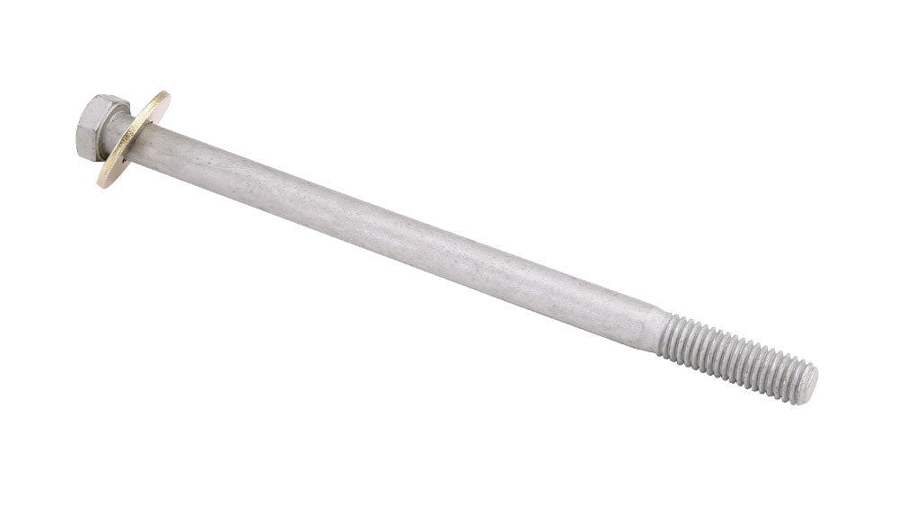

  • Mini lathe drawbar
  • 3MT x 3/8"-16 x 6.5"
  • Hardened
  • Fits HiTorque mini lathes with 3MT spindle
  • Fit SIEG SC2 and C3 mini lathes
This is the 3/8"-16 drawbar for HiTorque mini lathes with the 3 Morse Taper spindle. Also fits SIEG SC2 and C3 mini lathes.
This drawbar is a 3/8"-16 x 6.5" cap screw and a flat washer. They are both hardened for long life.
Made from Grade 8 steel, these screws can be used in high-stress applications, such as valves, pumps, motors, and automotive suspension systems. They are at least 25% stronger than medium-strength steel screws. Grade 8 steel hex head screws are marked with six radial lines. Length is measured from under the head.
Zinc-flake-coated steel screws are about five times as corrosion resistant as zinc yellow-chromate plated screws and have good resistance to salt water and acids. Also known as ultra coat and armor coat. To maintain corrosion resistance, use these screws with zinc-flake-coated nuts and washers.
See Specifications Tab for more information on this product.
Length: 6.5" (165.100 mm)
System of Measurement: Inch
Head Type: Hex
Drive Style: External Hex
Thread Direction: Right Hand
Thread Size: 3/8"-16
Screw Size Decimal Equivalent: 0.375"
Thread Type: UNC
Thread Fit: Class 2A
Threading: Partially Threaded
Min. Thread Length: 1.25" (31.750 mm)
Thread Spacing: Coarse
Head Width: 9/16"
Height: 15/64"
Fastener Strength: Grade 8
Material: Steel
Finish: Zinc-Flake Coated
Tensile Strength: 150,000 psi
Hardness: Rc 33
---- Washer Specs: --------
Washer Type: Flat
For Screw Size: 3/8"
Od: 1.000"
Thickness: 0.064" to 0.104"
Strength Grade/Class: SAE Grade 8
Strength Rating: High
Hardness: Rc 38
Performance: High Strength
Product Compatibility
  • SIEG C3 7x14 Mini Lathe
