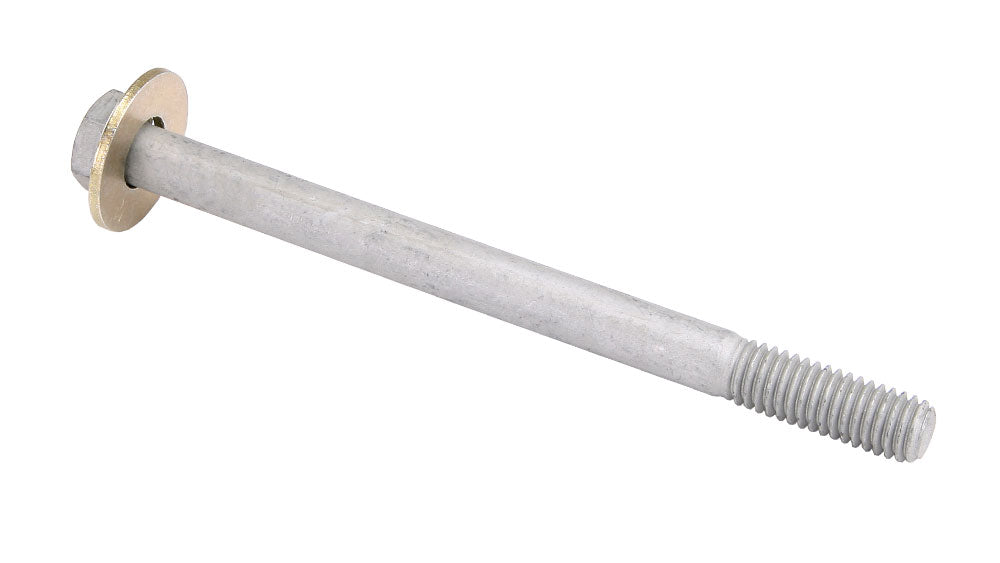

  • Mini lathe drawbar
  • 3MT x 3/8"-16 x 5"
  • Hardened grade 8
  • Fit SIEG C2 and SC2 class of mini lathes
  • Includes washer
This is the 3/8"-16 drawbar for the 7x10 and 7x12 mini lathe with the 3 Morse Taper spindle.
This drawbar is a 3/8"-16 x 5" cap screw and a flat washer. They are both hardened for long life.
Made from Grade 8 steel, these screws can be used in high-stress applications, such as valves, pumps, motors, and automotive suspension systems. They are at least 25% stronger than medium-strength steel screws. Grade 8 steel hex head screws are marked with six radial lines. Length is measured from under the head.
Zinc-flake-coated steel screws are about five times as corrosion resistant as zinc yellow-chromate plated screws and have good resistance to salt water and acids. Also known as ultra coat and armor coat. To maintain corrosion resistance, use these screws with zinc-flake-coated nuts and washers.
