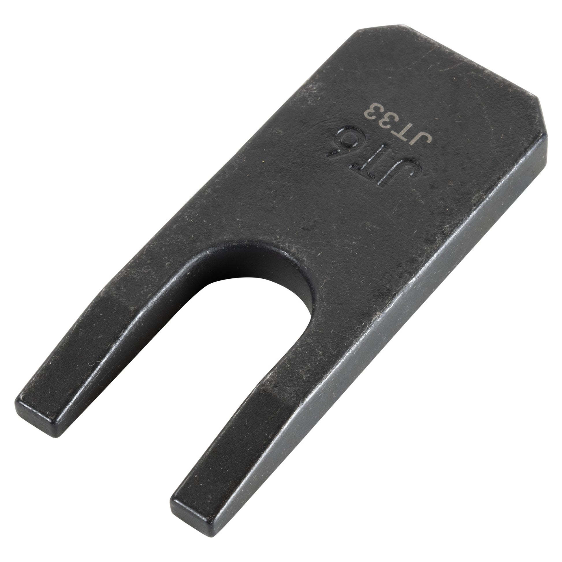

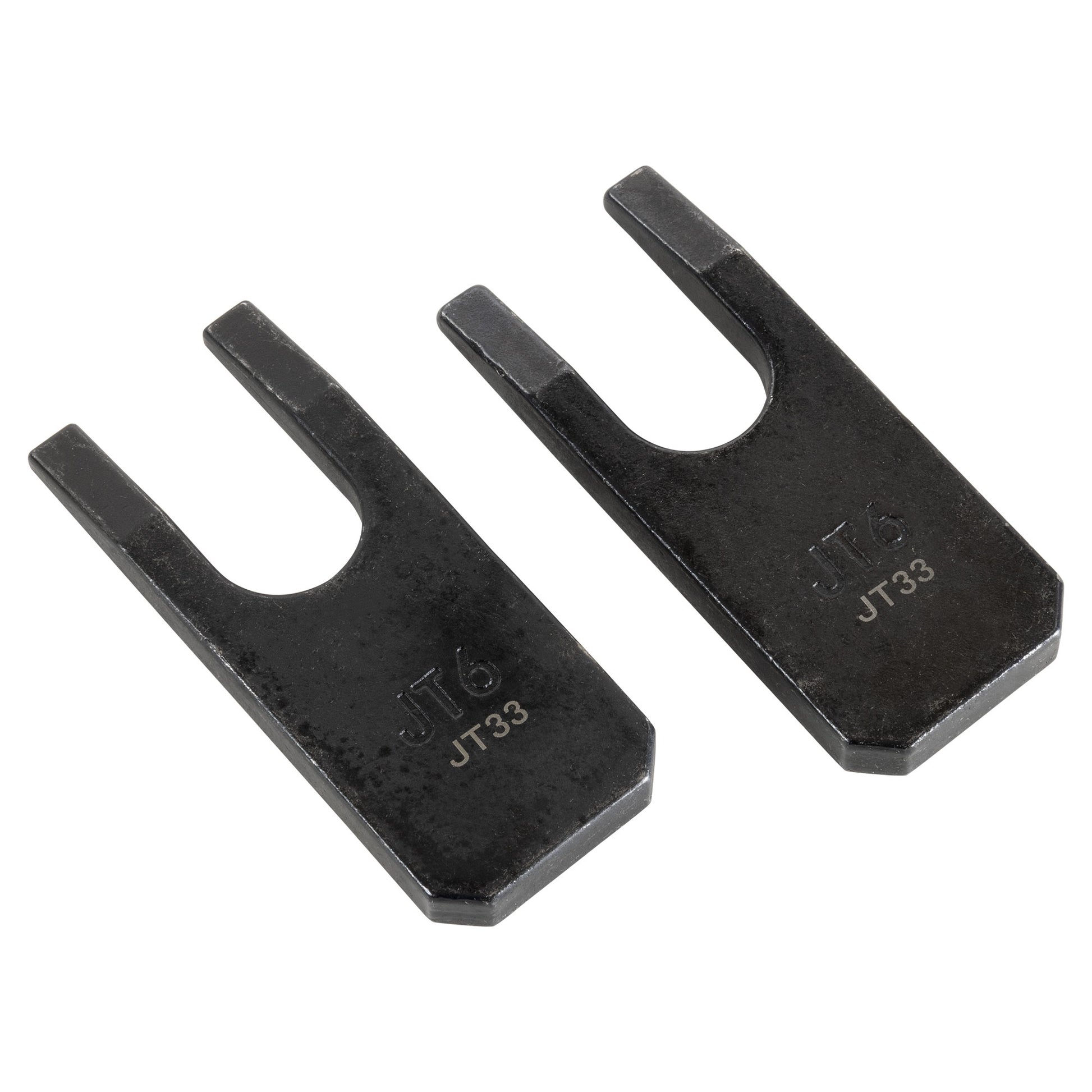

  • Removes taper mount drill chuck from arbor
  • For #6 and #33 Jacobs tapers
Remove chucks from arbors with these handy wedges. Designed for Jacobs Taper #6 and #33 arbors.
2-piece set for removing taper mount chucks from arbors or spindles. These drill chuck removal tools are made to work with your JT6 & JT33 drill chucks. Thick and durable for reliable performance.

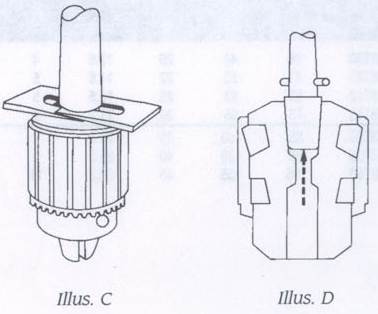

To remove a chuck from an arbor, insert the wedges between the back of the chuck and the shoulder of the arbor (Illus. C). If the mounting taper of the arbor does not provide a shoulder, drill a cross hole through the neck of the arbor (illus. D.) and insert a cross pin. Then the wedges can be used between the chuck back and the cross pin.
