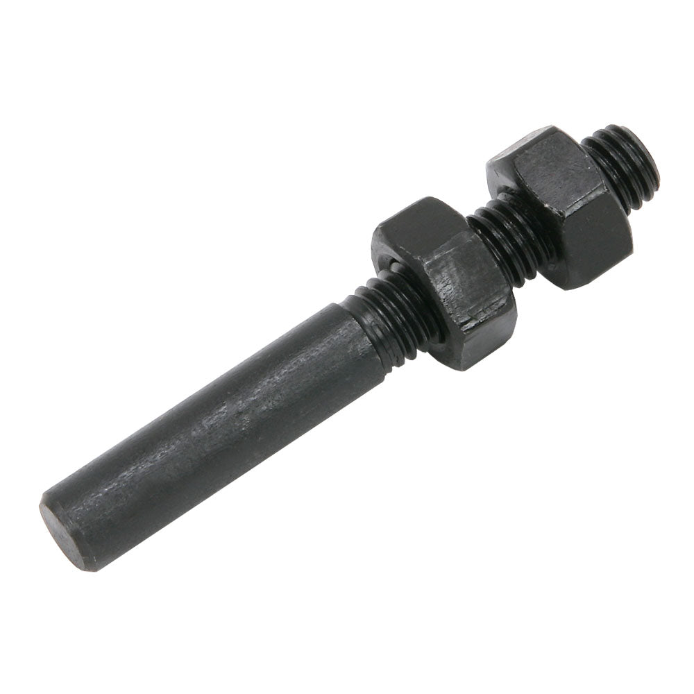

  • Lathe Dog Driving Pin
  • For lathes with 100 mm (4") chuck mounting flanges
  • Fits M8 bolt holes
M8 lathe dog driver acts as a holding pin when using a lathe dog that has a straight tail. Bolt into 100 mm (4") faceplates that have M8 mounting holes.
The photo shows how to use a lathe dog and drive pin with the mini lathe.
Lathe Dog Use
Lathe dogs are the perfect solution for turning between centers. (That's where you mount a dead center in the headstock and another center -- usually a live center -- in the tailstock. (see our live and dead centers here!)You then mount the workpiece, which has a small divot machined into each end, between the centers.
To drive the workpiece, you place a lathe dog on it; the lathe dog is pushed around by a driver pin screwed in to a faceplate or the spindle.
