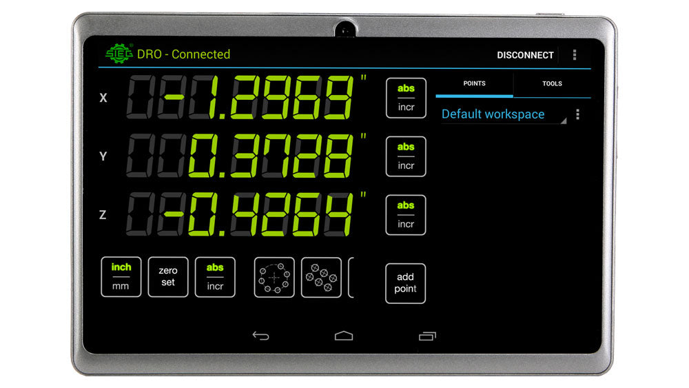

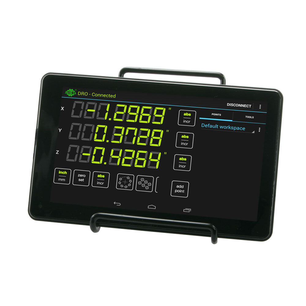

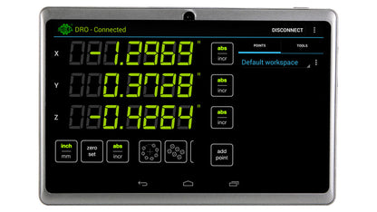

  • 7" screen size
  • Bluetooth capable
  • 1024x600 resolution
  • Up to 6 hours of battery life
These REFURBISHED Android DRO tablets are for our Bluetooth DROs. Some may have slight blemishes on the case but are otherwise in excellent condition.
Bluetooth digital readout software is installed on this tablet, which comes with complete instructions. The software is a customized and fully-licensed version of TouchDRO.
While we sell an Android Tablet with the DRO software installed, you can use most any Android tablet that supports Bluetooth with the Bluetooth DROs that we sell.
Here's how to get going:
  1. On your Android tablet, go to Bluetooth Settings and Pair the DRO to your tablet. The name of the DRO is HC-06 or BT04-E. The PIN is 1234.
  2. Go to the Google Play Store and install Yuriy's Toys TouchDRO.
  3. When you launch TouchDRO and tap Connect in the upper right corner.
