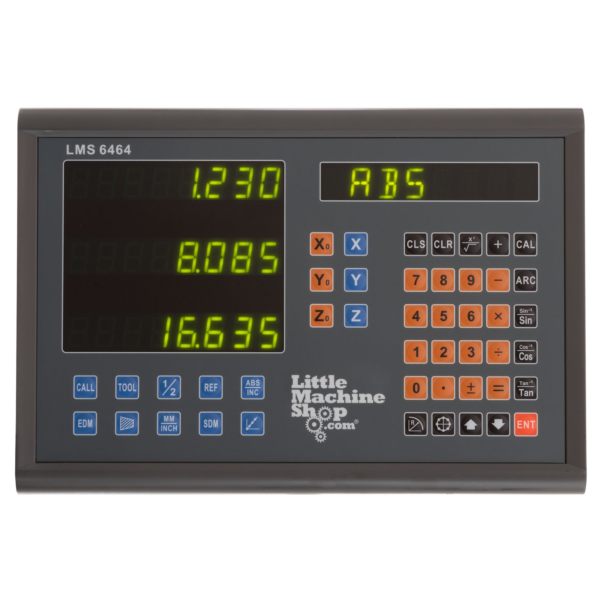

  • DRO Display for hard wired DRO kits
  • Made for HiTorque bench mills and lathes
  • Comes with protective cover and can be used with cover on or off

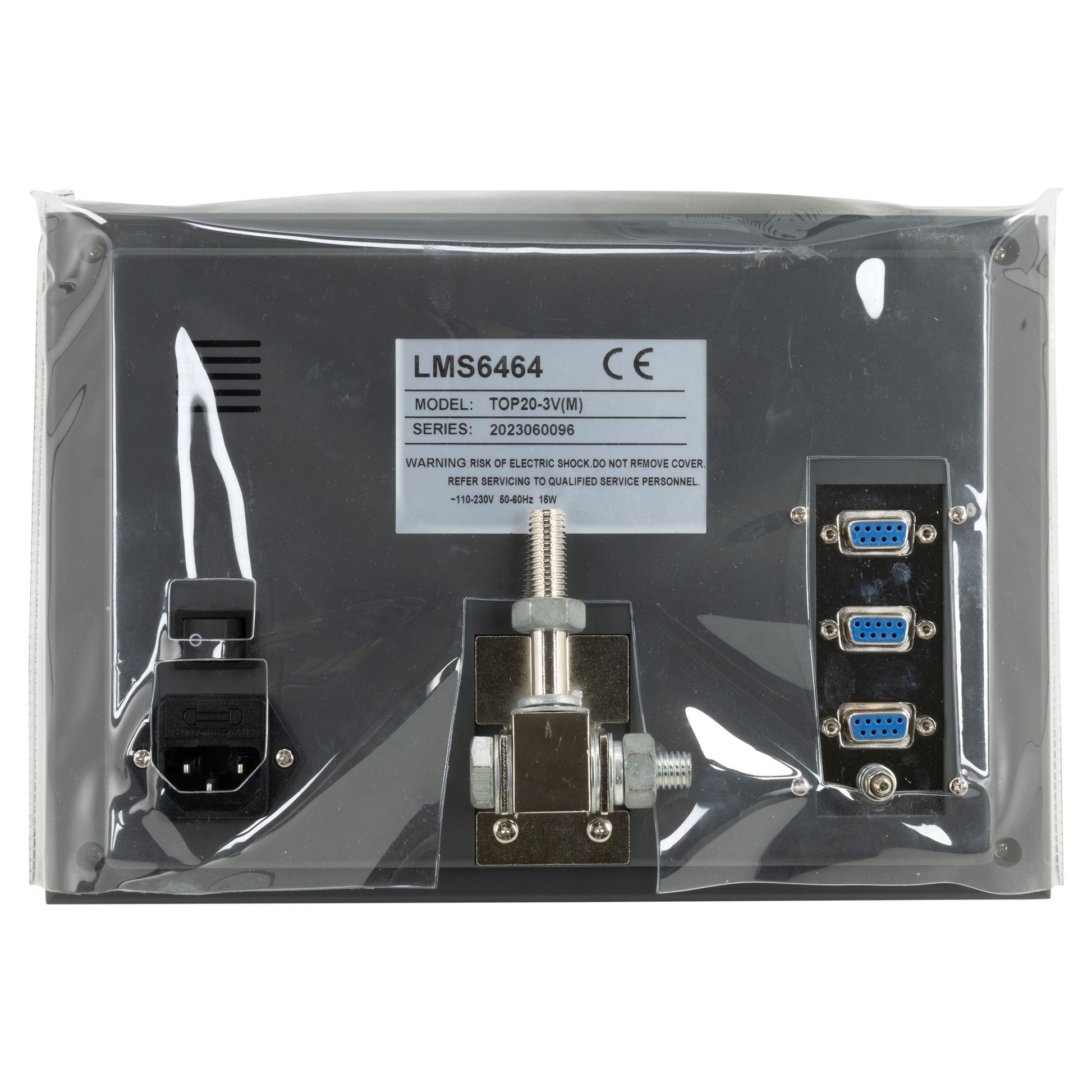

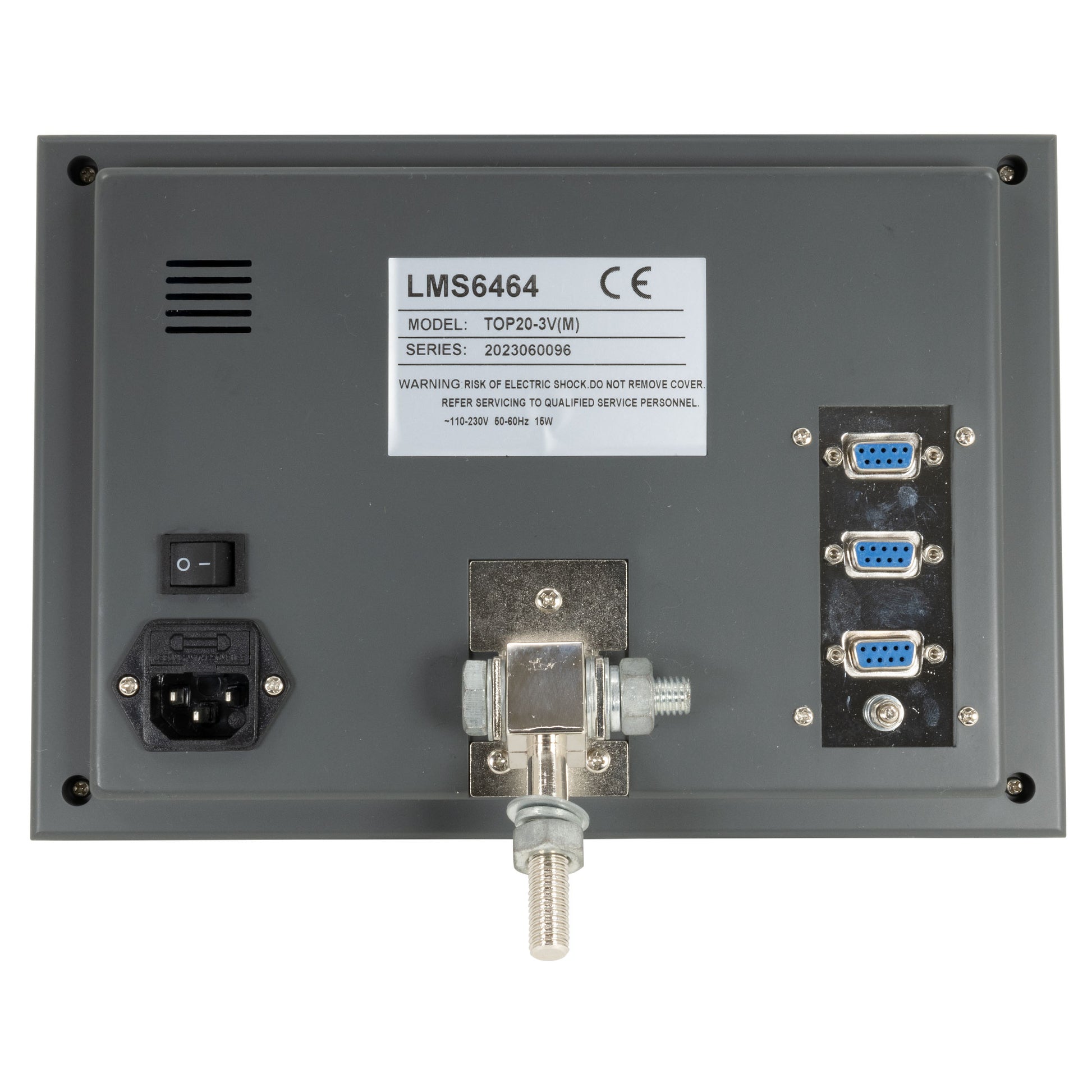

  • Three 9-Pin connection ports allow use in both 3-axis and 2-axis application
DRO display for the hard wired 2-axis and 3-axis DRO kits for HiTorque bench mills and bench lathes.

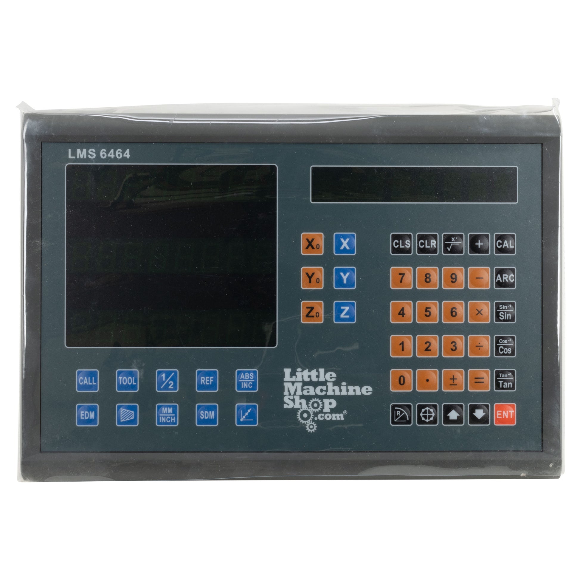

This display comes with a protective cover which can be kept on the display during use. It is designed to be used with either a vertical or horizontal stand for mill or lathe.
The display comes with three 9-Pin ports for constant connection to the machine.
Here is the Users Manual for the DRO display unit.
Repeatability: 0.000" (0.005 mm)
Resolution: 0.000" (.005 mm)
Specified Accuracy: 0.002" / 1 m travel, 0.05 mm
Accuracy / Foot: 0.002" (.05 mm)
Accuracy / 100 Mm: 0.002" (.05 mm)
Scale Technology: Magnetic
Scale Protection: Coolant & dust resistant
Voltage: 120-240 V
Clear to Zero: YES
Direct Entry of Position: YES
Inch/mm Display: YES
Power Off Memory: YES
Reversible Count Direction: YES
Find Center: YES
Bolt Circles: YES
Bolt Lines: YES
Preset Points: YES
Tool Offsets: YES
Radius/Diameter: YES
Incremental/Absolute: YES
Calculator: NO
Arc Machining: NO
Linear Error Compensation: NO
Made In: China
Warranty: 1 years
Warranty: 1 year
Phone Tech Support: Free
