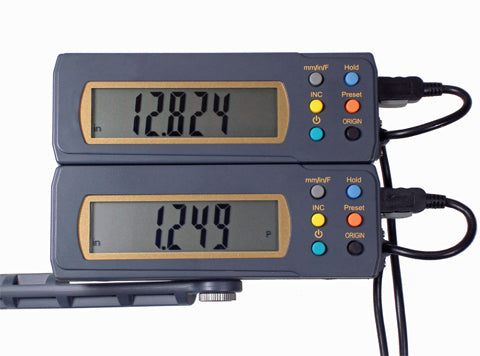

  • Articulating arm allows stacking of multiple displays

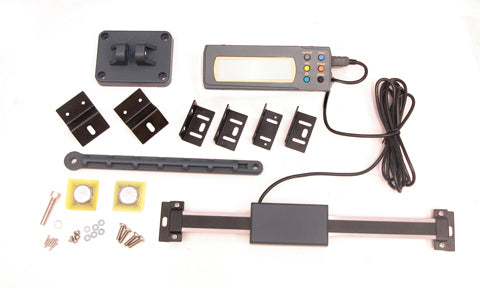

Twelve inch (300 mm) DRO scale with display and mounting bracket.

Displays are equipped with magnets to allow easy attachment to steel surfaces. The articulating arm allows stacking of multiple displays (see Chris' Tips). Kit includes 2 different types of mounting brackets for flexibility of installation.

These readouts are great. They stack if you have more than one on your machine.
Stackable DRO
Here are the pieces you get with each DRO unit.
Stackable DRO Parts
