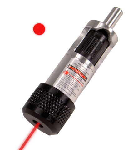

  • 10 mm shank fits collets and end mill holders
  • 3.375" overall length
  • Uses common SR44 batteries (included)
  • Accuracy to 0.001"
  • Includes polarizing attachment to adjust dot size
The Laser Center/Edge Finder™ is a new tool for your mill that saves setup time. It eliminates the frustrations and doubts of using the century-old indirect method with a conventional edge finder or wiggler.
The Laser Center/Edge Finder projects a fine laser beam that directly indicates the edge of the workpiece. Move the beam to the edge of the work and set your dial to zero. It is that easy. No more calculating half the diameter of the edge finder.
You can also use the Laser Center/Edge Finder to locate scribed or center-punched locations. Simply move the laser beam to the location on the workpiece and the spindle is aligned.
The Laser Center/Edge Finder is easy to align so you can be sure it is always accurate.
The batteries last for over 3 hours of continuous operation. That's 6 months to a year of normal use.
How fine a dot can you make? As fine as frog's hair (so fine you can't see it). To obtain the smallest dot size for your most precision work, try coating the material with Blue Dykem.  This coating will absorb a bit of the laser dot making it appear smaller.
Besides our uses for finding edges, finding centers, and aligning things, these Laser Center/Edge Finder are used for a variety of industrial uses. A Laser Center/Edge Finder is shipped with each Flow International waterjet cutting machine. They are used by Boeing to assemble wings for 737 jetliners. They are used to test the main engine exhaust on the Space Shuttle. And the GM Crash Div uses them to set up crash tests. These are examples of the over 500 commercial and industrial customers that have purchased Laser Center/Edge Finders.
The Laser Center/Edge Finder™ not as accurate as a mechanical edge finder. But it is a whole lot more convenient to use. So don't think of it as a replacement, but as an additional tool for those times where 1/2 thou accuracy is not required. The laser edge finder will get you within about 0.002"
And in some applications, like finding the intersection of scribed lines, I can't think of many tools that are more accurate.
