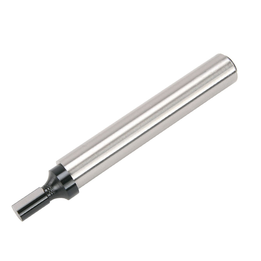

  • Audible Edge Finder, clicks when finder hits edge
  • 3/8" Shank, 0.200" tip
  • Maximum RPM for use: 1500 RPM
  • Black tip makes it easier to see.
  • Made in USA by Fisher Machine Shop
This 3/8" diameter edge finder helps you locate work on your mill. When you reach the edge of the work it not only jumps to the side, but it clicks too.
The edge finder has a 0.200" diameter cylinder to quickly find the edge of a work piece.
Not for use in high speed spindles.
The edge finder is hardened and ground all over and is furnished with a quality vinyl case.
This is a quality American-made product from Fisher Machine Shop.
The click produced by an audible edge finder is not very loud. I have to put my ear pretty close to hear it over the gear noise from my mini mill.
