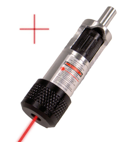

  • 3/8" shank fits collets and end mill holders
  • 3.375" overall length
  • Uses common SR44 batteries (included)
  • Accuracy to 0.001"
  • Includes polarizing attachment to adjust to normal dot
The Laser Center/Edge Finder™ is a tool for your mill that saves setup time. It eliminates the frustrations and doubts of using the century-old indirect method with a conventional edge finder or wiggler.
This Laser Center/Edge Finder projects a crosshair, making it easy to align a workpiece on the table.
The Laser Center/Edge Finder projects a fine laser beam that directly indicates the edge of the workpiece. Move the beam to the edge of the work and set your dial to zero. It is that easy. No more calculating half the diameter of the edge finder.
You can also use the Laser Center/Edge Finder to locate scribed or center-punched locations. Simply move the laser beam to the location on the workpiece and the spindle is aligned.
The Laser Center/Edge Finder is easy to align so you can be sure it is always accurate.
The batteries last for over 3 hours of continuous operation. That's 6 months to a year of normal use.
How fine a dot can you make? As fine as frog's hair (so fine you can't see it). To obtain the smallest dot size for your most precision work, try coating the material with Blue Dykem.  This coating will absorb a bit of the laser dot making it appear smaller.

The Laser Center/Edge Finder™ not as accurate as a mechanical edge finder. But it is a whole lot more convenient to use. So don't think of it as a replacement, but as an additional tool for those times where 1/2 thou accuracy is not required. The laser edge finder will get you within about 0.002"
And in some applications, like finding the intersection of scribed lines, I can't think of many tools that are more accurate.
