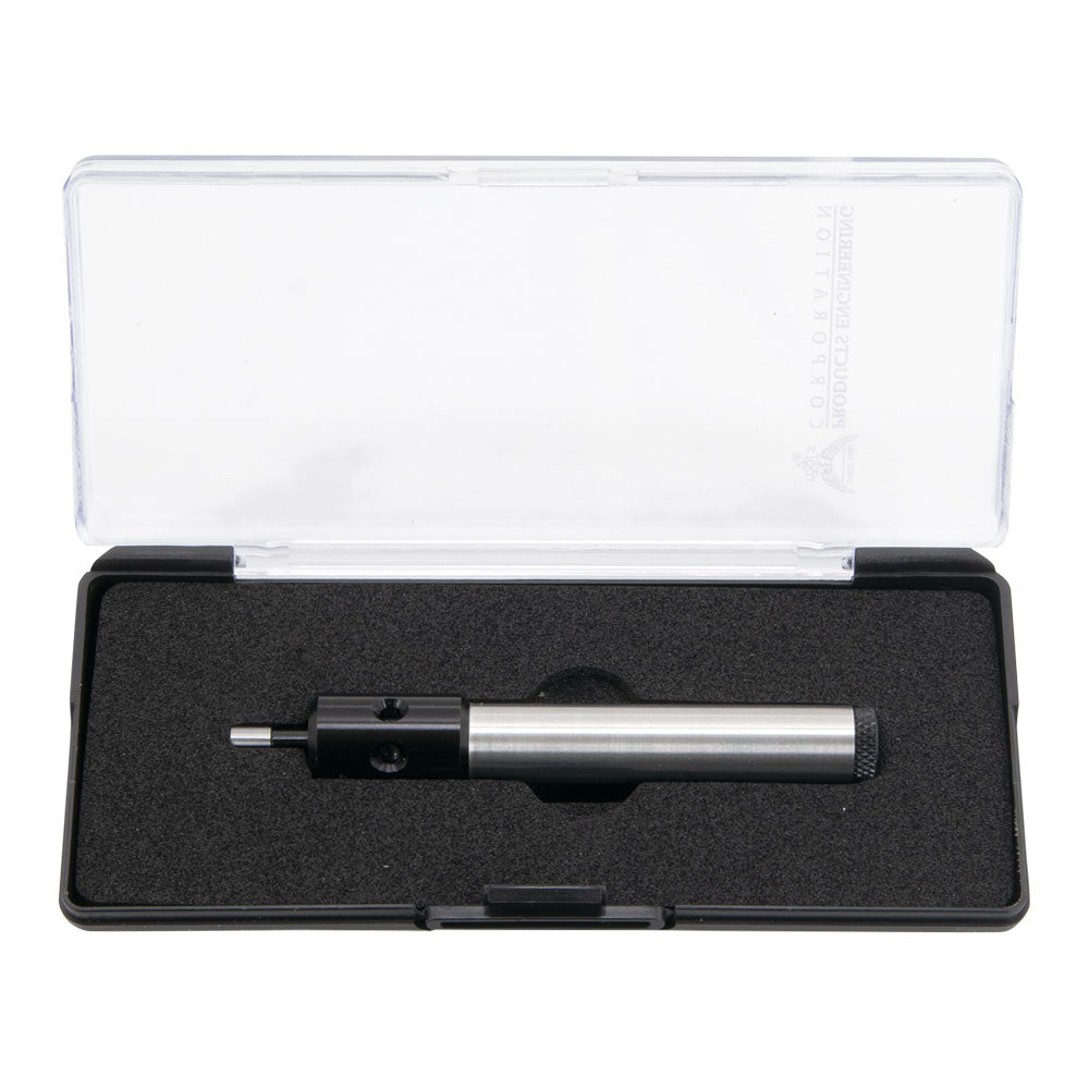

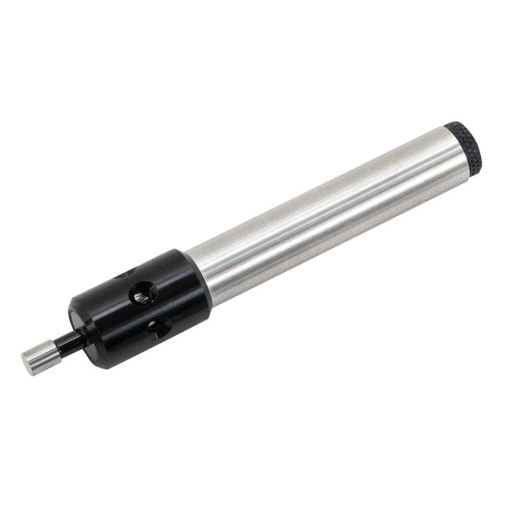

  • Lights up when it contacts the edge of the work
  • Repeatable to 0.0002"
  • Works on any conductive metal
  • Includes LED light and battery
  • Made in USA
This electronic edge finder has a 1/2" shank. It is 4" long overall.
Manufactured in the USA by Products Engineering Corporation, a respected company established in 1960, known for its high-quality measurement instruments. Ensures top-notch quality, exceptional craftsmanship, and adherence to high industry standards
  • EXCEPTIONAL ACCURACY: Provides a repeatability of .0002" with a cylinder tip stylus diameter of 0.200", ensuring precise edge alignment and reliable performance.
  • LED VISUAL INDICATOR: LED light with 360-degree view provides clear and immediate visual confirmation from any angle when the stylus contacts an edge. This feature is particularly useful in low-light conditions or within complex setups, ensuring no misreads or errors in edge detection.
  • DURABLE CONSTRUCTION: Built from high-quality, durable carbon steel, the PEC Electronic Edge Finder is designed to withstand rigorous use and provide long-lasting reliability in demanding machining environments.
  • USER-FRIENDLY OPERATION: Designed with simplicity in mind, this edge finder provides clear electronic feedback to help users quickly and accurately identify edges, making it a reliable tool for both novice and experienced machinists.
*NOTE: This device uses an A23 battery that may also be called 1811A, 23A, 8F10R, 8LR32, 8LR932, A21, A23, BAT012, E23A, EL12, GP23A, K23A, L1028, LRV08, MN21, MN23, MS21, N21, N21, PX32A, PX32AB, PX32B, RV08, RVO8, S21, V23GA, VR22, 23AE, or L1028F.
Here's what Jim Donnelly says about the PEC Electronic Edge Finder:
"For years I've been using a battery-and-light bulb edge finder, and the problem with it was that under some conditions it was difficult for enough voltage to light up the bulb enough to give you confidence about when you hit an edge.  The PEC edge finder seems to connect the edge discovery to the base of a switching transistor, because the LED turns on brightly with full confidence when you make even the slightest contact.  Sometimes electrical resistance within the milling machine prevents enough current to flow to light a bulb, but there's always enough to switch a transistor to light up the LED."
