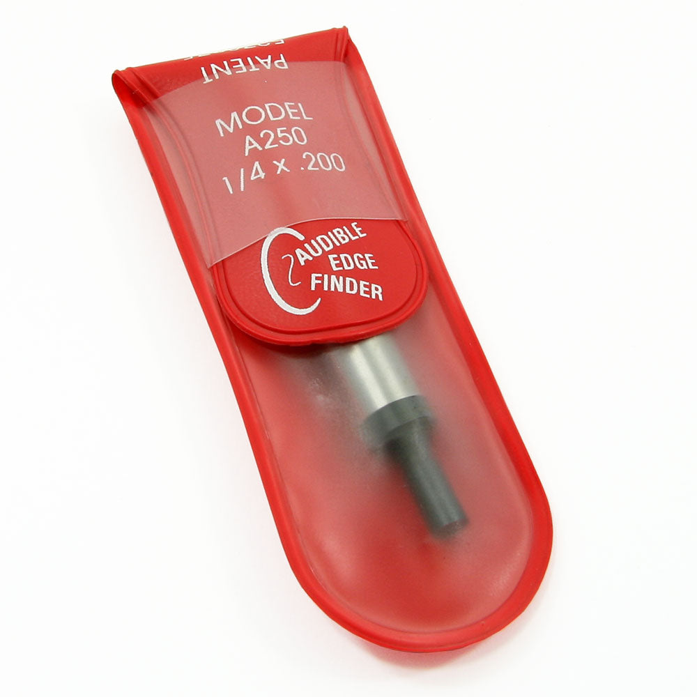

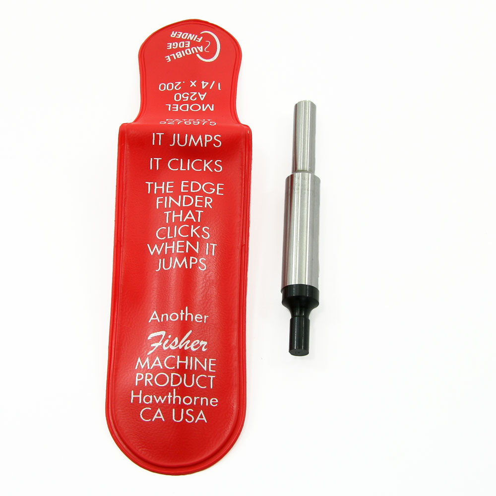

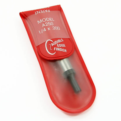

  • Audible Edge Finder, clicks when finder hits edge

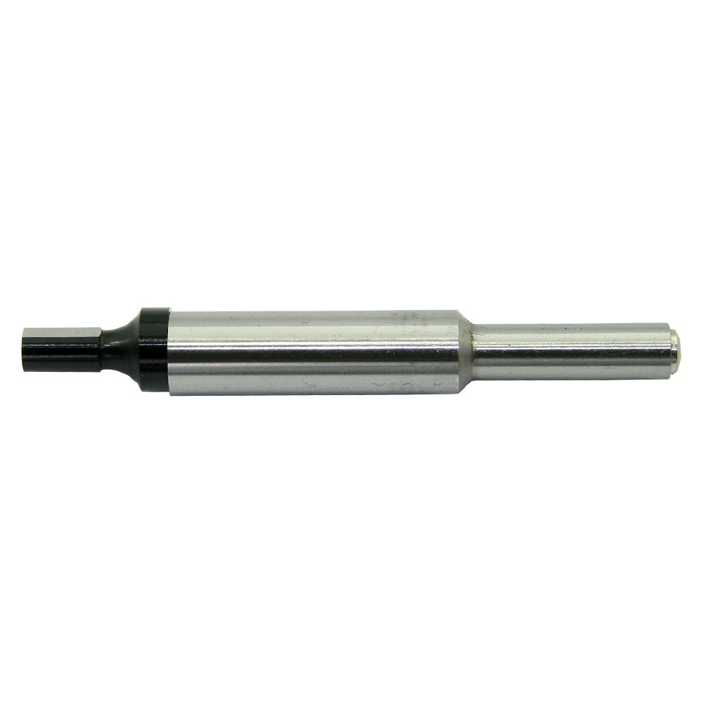

  • 1/4" diameter, 0.200" diameter cylinder
  • Maximum RPM for use: 1500 RPM
  • OAL 2-7/8", 1/4" shank is 7/8" long
  • Made in USA by Fisher Machine Shop
This 1/4" diameter Fisher edge finder helps you locate work on your mill. When you reach the edge of the work it not only jumps to the side, but it clicks too.
The edge finder has a 0.200" diameter cylinder to quickly find the edge of a work piece.
The edge finder is 2-7/8" long. the 1/4" shank is 7/8" long.
The edge finder is hardened and ground all over and is furnished with a quality vinyl case.
This is a quality American-made product from Fisher Machine Shop.
