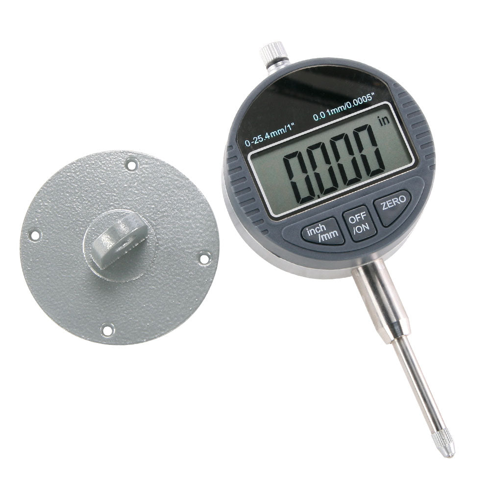

  • Measurement range is 0-1"
  • Resolution is 0.0005", accuracy is 0.0012"
  • Measures in inches or mm
  • Set to zero at any position
  • Relative and absolute measurement
This is an AGD Group 2 indicator with a 0.375" diameter shank and a #4-48 thread for tips.
There are three buttons; ON/OFF for power, RESET to zero the display, and R/A to switch between absolute and relative measurement.
Pressing R/A zeros the indicator at any position so you can make comparative readings between two parts. The absolute measurement is not lost, and is displayed by pressing R/A again.

Range: 0" - 1" (0.000 mm - 25.400 mm)
Resolution: 0.0005" (0.013 mm)
A.G.D. Group: 2
Face Diameter: 2.23" (56.642 mm)
Shank Size: 0.375" (9.525 mm)
Thread Tip: #4-48
Accuracy: 0.001" (0.025 mm)
Type: Flat Back
Dial Face: Digital in/mm
