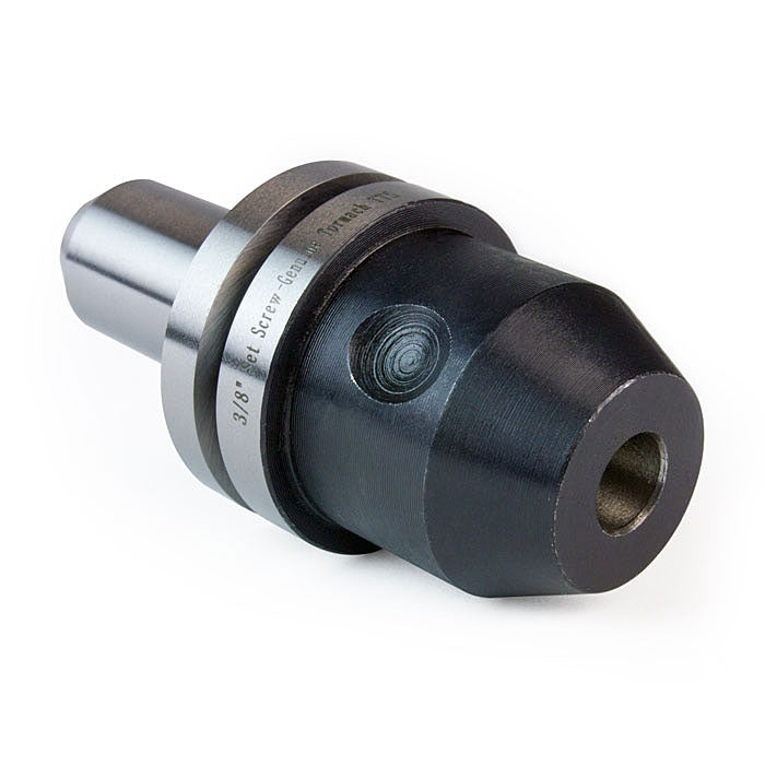

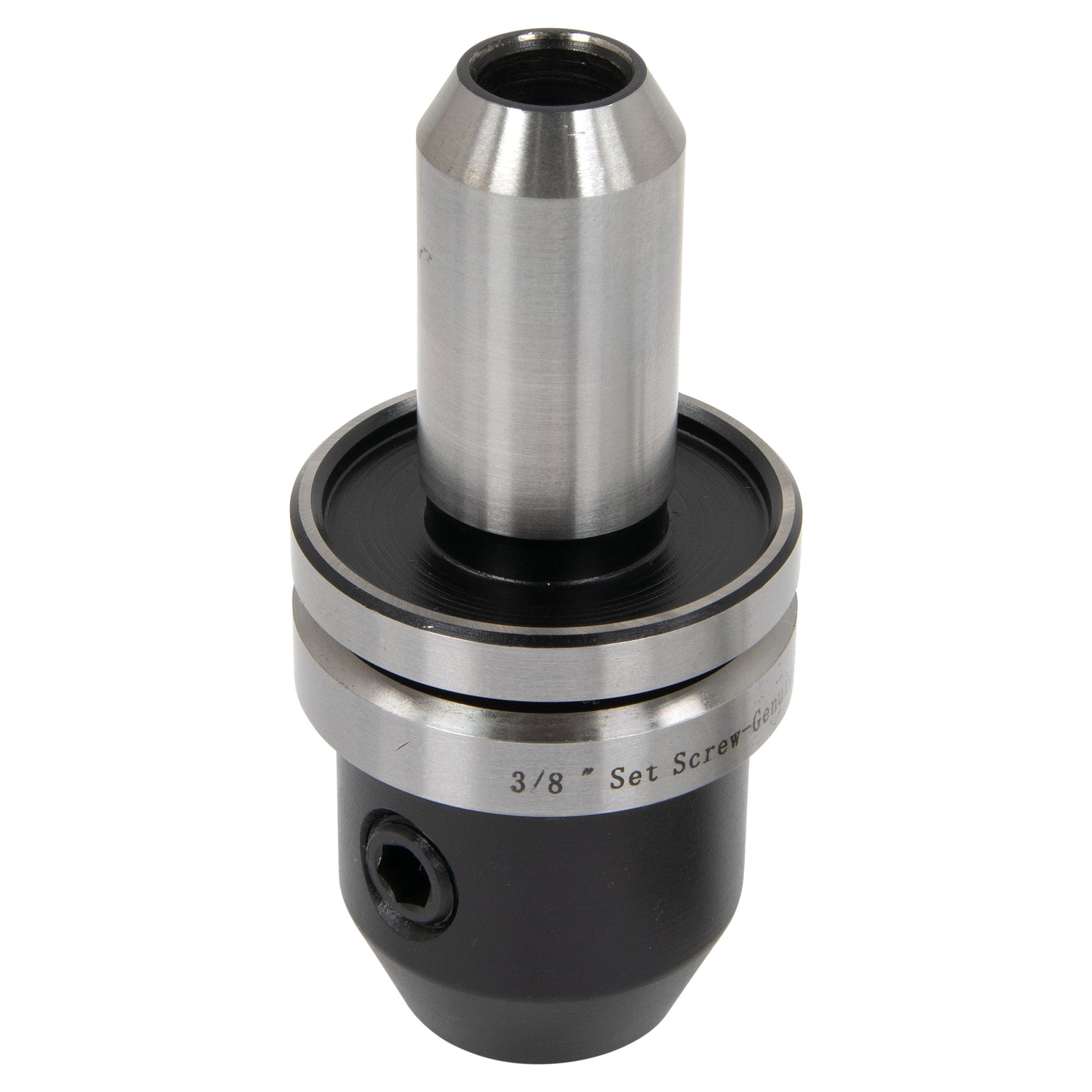

  • Quick change adapter for 3/8" shank end mills
  • Minimal clearance height for tool change
  • Repeatable tool positioning
Quick change Tormach 3/8" suitable for general milling operations and are intended to be used with end mills that have a Weldon shank (flat surface on shank). They can also be used with certain Silver & Deming style drill bits.
The tool holder has a set screw on one side and a balancing dimple on the other side. The balancing dimple reduces vibrations at speeds above 8000 RPM.
