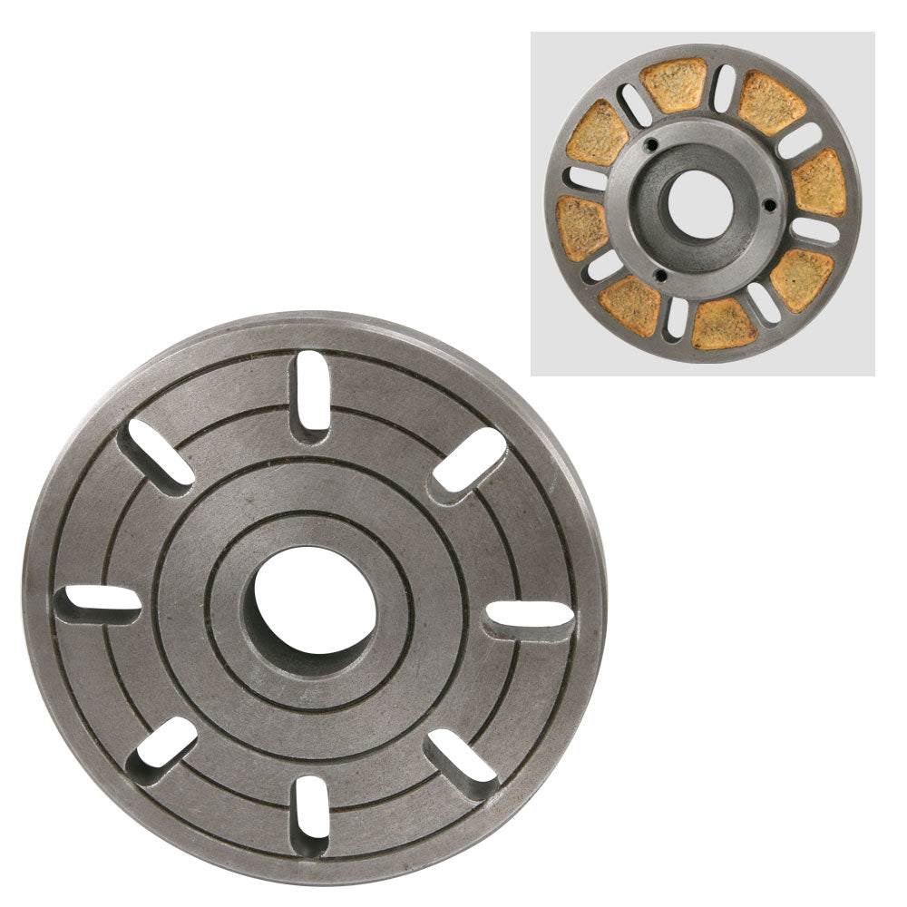

  • 180 mm diameter
  • 8 Slots for mounting work
  • Compatible with lathes with 100 mm flange chuck mount
  • Fits SIEG C4, SC4 and HiTorque bench lathes
The faceplate is 7.1" (180 mm) in diameter and has 8 slots for mounting work. The faceplate is made of cast iron.
This faceplate has a 72 mm registration recess. It requires 3 M8 x 25 studs. It mounts in place of a 100 mm (4") 3-jaw lathe chuck.
*NOTE: Bench lathe faceplate that fits SIEG C4, SC4 and LittleMachineshop.com HiTorque 8.5x20 bench lathes.
