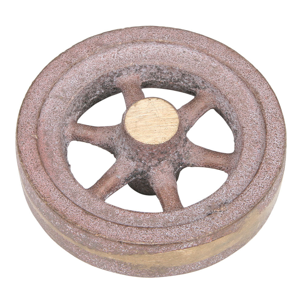

- Cast bronze flywheel
- Highest quality made by Martin Model & Pattern
- Fully Annealed
The flywheel casting is oversize so you can finish it to the specified diameter.
Photo shows the flywheel partly machined. This flywheel has a rim width of 0.779", a rim thickness of 0.285", a hub diameter of 0.715", and an overall hub length of 1.212".
All Martin Model & Pattern castings are fully annealed for easier machining.
