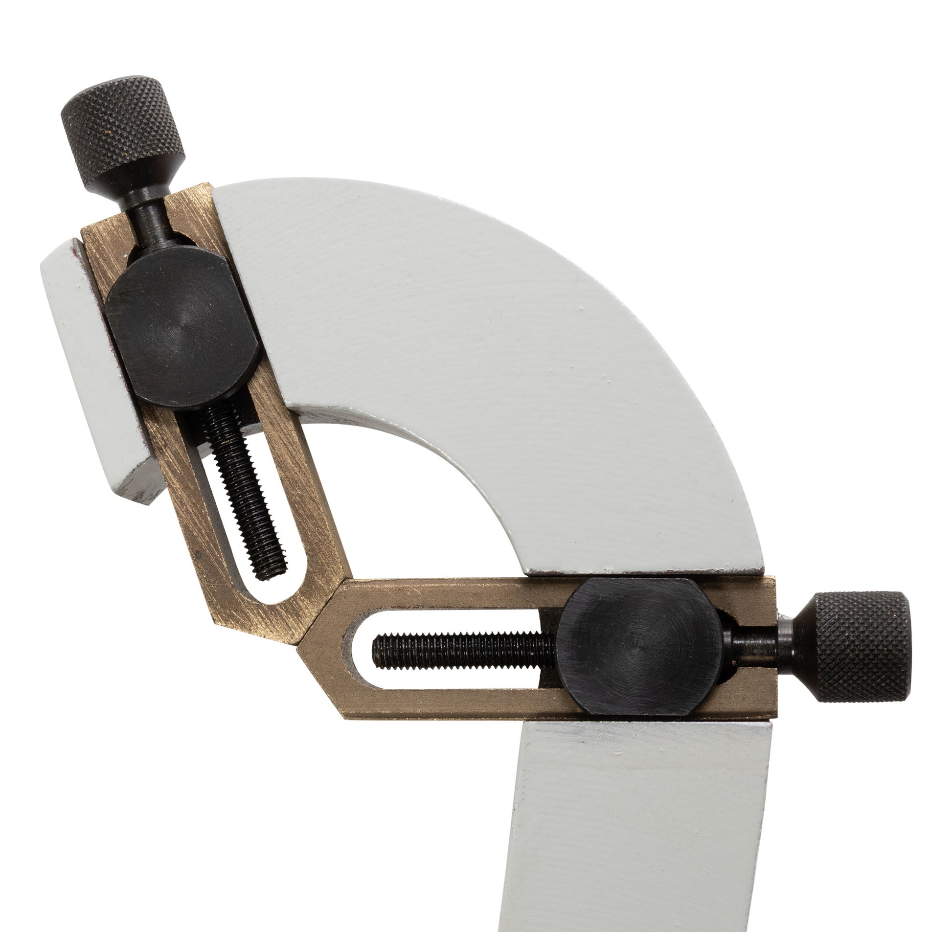

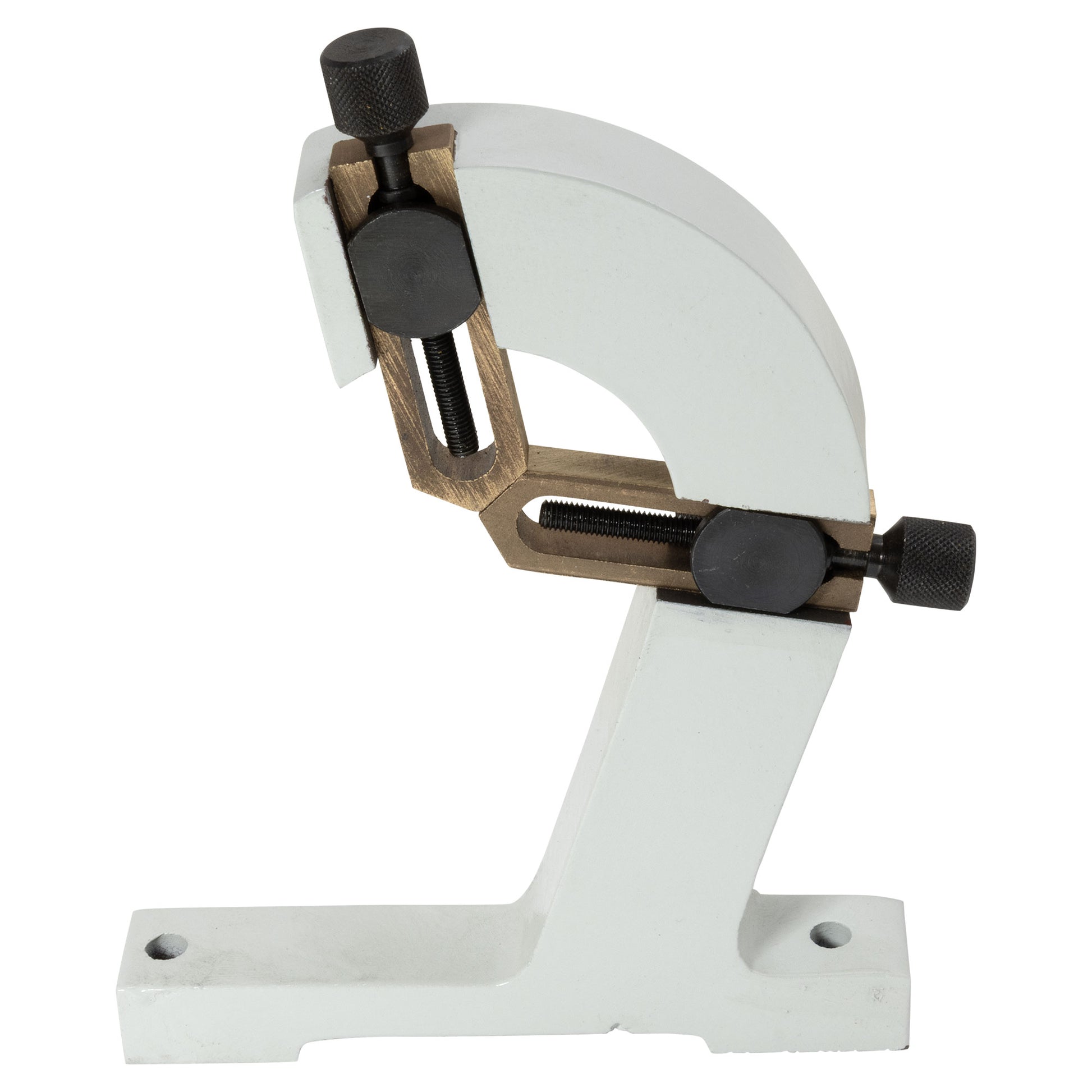

  • Follower rest, bench lathes
  • Supports work up to 2.2" in diameter
  • Fits HiTorque 9x20 and SIEG SC50 bench lathes
This follower rest fits the HiTorque 9x20 and SIEG SC50 bench lathes.
The follower rest can support work up to 2.2" in diameter.
See compatibility tab for reference to machines that are compatible with this part.

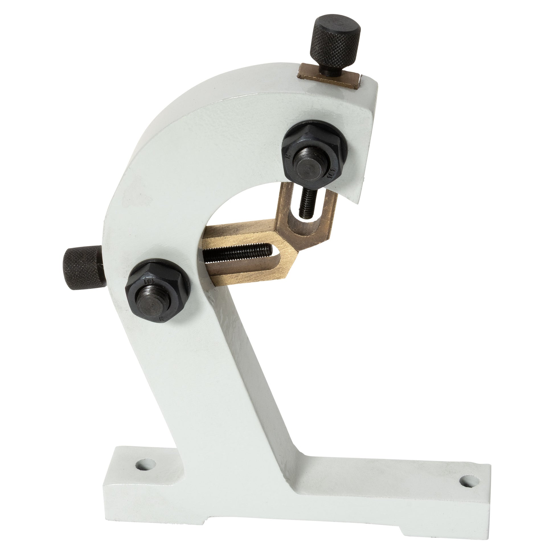

The follower rest mounts on the saddle and moves with the cutting tool to provide support where it is needed.
On the left side of the carriage (the part that actually slides on the ways) there are two threaded holes with set screws in them. Remove the set screws (that are there to keep the holes clean) and bolt on the follower rest.
