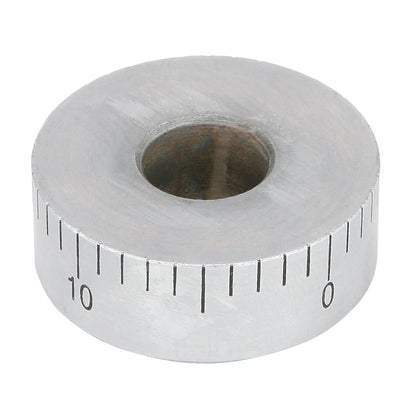

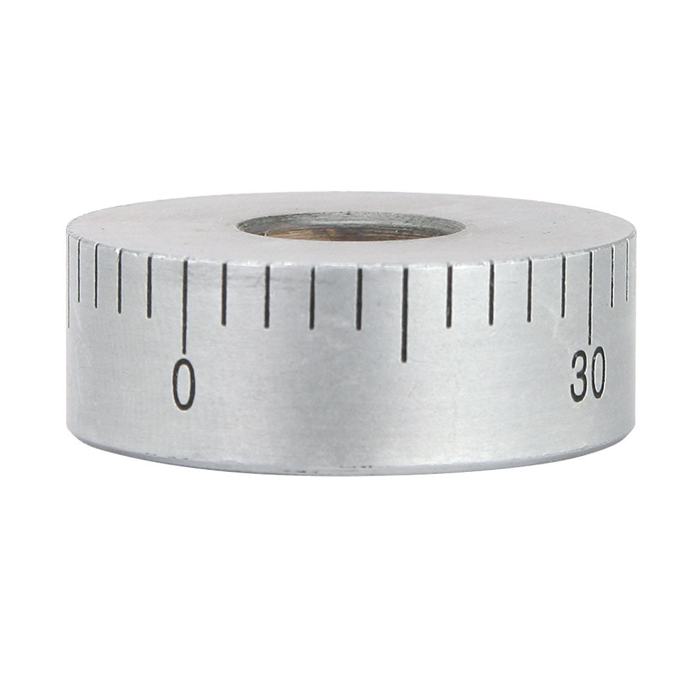

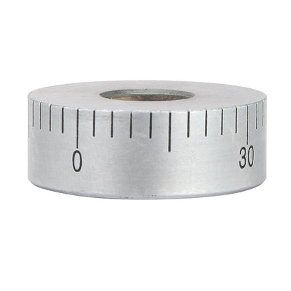

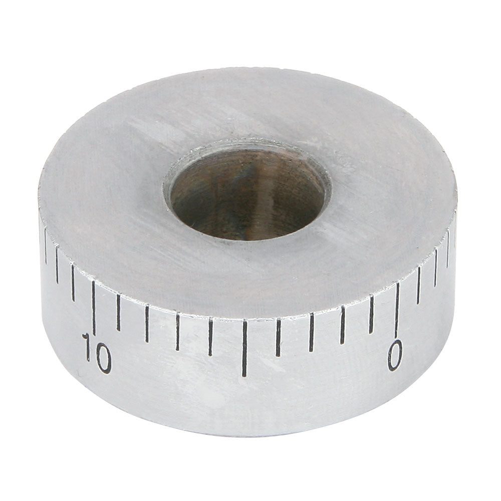

  • Graduated dial, 40 divisions
  • Mini lathe cross slide and compound rest
  • OD: 33 mm
  • ID: 12 mm
  • Width: 12 mm
This dial is used on the cross slide and the compound rest. It works with screws with a 1 mm pitch (approximately 0.040" per revolution).
The dial is 33 mm OD, 12 mm ID, and 12 mm wide.
