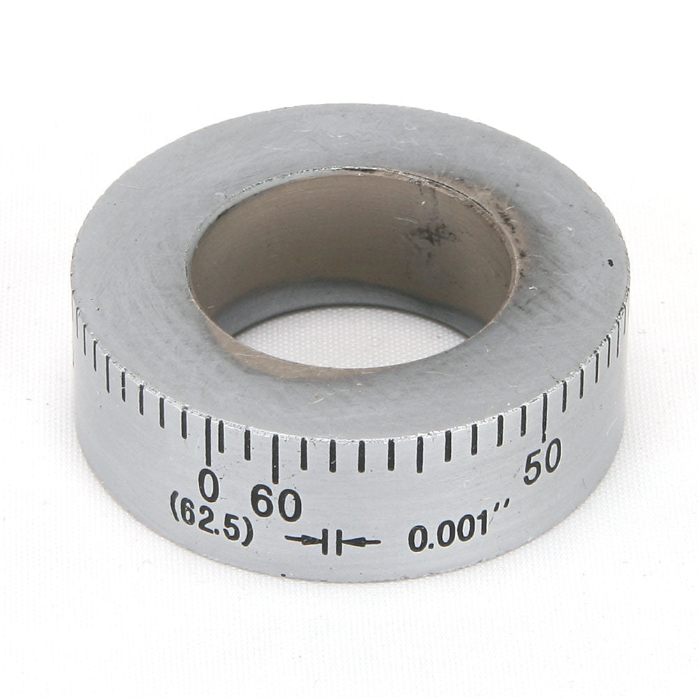

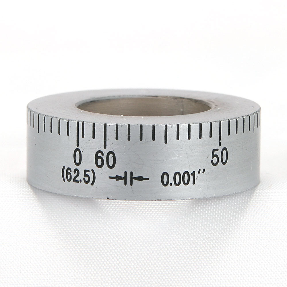

Graduated Dial, 62.5 Divisions, Mini Mill
Regular price $11.95
Regular price Sale price $11.95
SKU:1483Shelf Location: (B08 - 03)
  • Graduated dial, 62.5 divisions
  • X- and Y-axed mini mills
  • OD: 35 mm
  • ID: 20 mm
  • Width: 11.2 mm
This dial is used on both the X- and Y-axes of the mini mill.
This dial is used on mini mills where the table advances 0.0625" per turn of the hand wheel.
The dial is 35 mm OD, 20 mm ID, and 11.2 mm wide.
