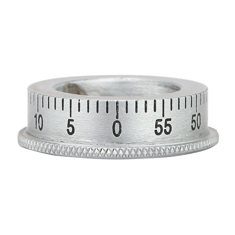

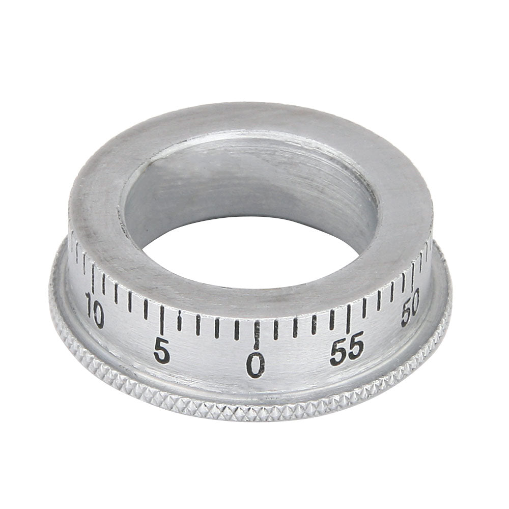

  • Graduated dial, 60 divisions
  • Z-axis mini mill
  • OD: 30 mm
  • ID: 20 mm
  • Width: 9 mm
This is the graduated dial on the Z-axis fine feed on the mini mill.
The dial is 30 mm OD, 20 mm ID, and 9 mm wide.

1517
Dial, Z-Axis Fine Feed
20 mm (0.79")
29 mm (1.14")
9.0 mm (0.35")

The Z-Axis Fine Feed Dial has a knurled ridge that is 33 mm in diameter and 1.7 mm wide.
