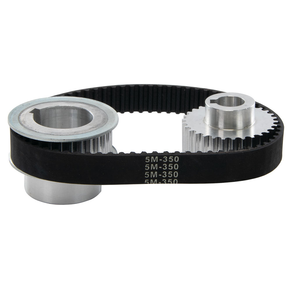

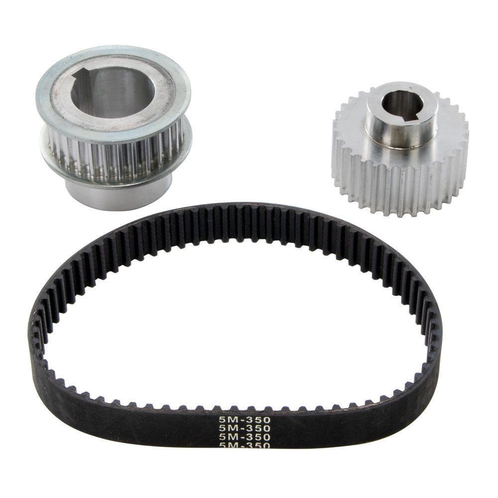

  • Fits HiTorque mini mills
  • 5000 rpm top speed
  • Includes two pulleys and a belt
  • Belt is 350-5M-15, 70 teeth
These pulleys change the spindle speed range to 5000 rpm max. The increased speed is great for small cutters such as those used for engraving. Just remember that doubling the speed will cut the torque in half.
It's important to have high speed bearings. Most LittleMachineShop.com HiTorque Mini Mills have high quality and high-speed bearings BUT the standard bearings on most mills are not rated to 5000 rpm. --see the Chris' Tips tab.
This high-speed spindle kit uses the same belt as the standard drive pulleys. The pulleys are easy, but if you have to change the bearings you have to press the spindle out and back in. A hydraulic press makes it an easy task. Switching pulleys to the original set shouldn't take more than 20 minutes.
*NOTE: We do not have installation instructions completed yet, so you are on your own for installation.
If you have a HiTorque 4190 or a HiTorque 3990 with a serial number greater than 60552 you already have the high speed bearings.
Other SX2 mini mills, including all Micro-Mark 84630 mills, require new bearings. SX2 Mills with an R8 spindle require one each of these two bearings 6206-2RS Bearing and 6007-2RS Bearing.
SX2 mills with an 3MT spindle require two of these 6206-2RS bearings.
