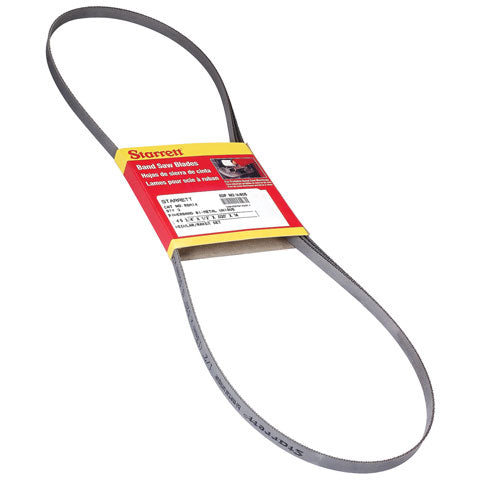

Band Saw Blades, 64-1/2", Intenss PRO-DIE, Individual Sizes, Starrett
Regular price From $34.95Regular priceUnit price / perSale price From $34.95 -
