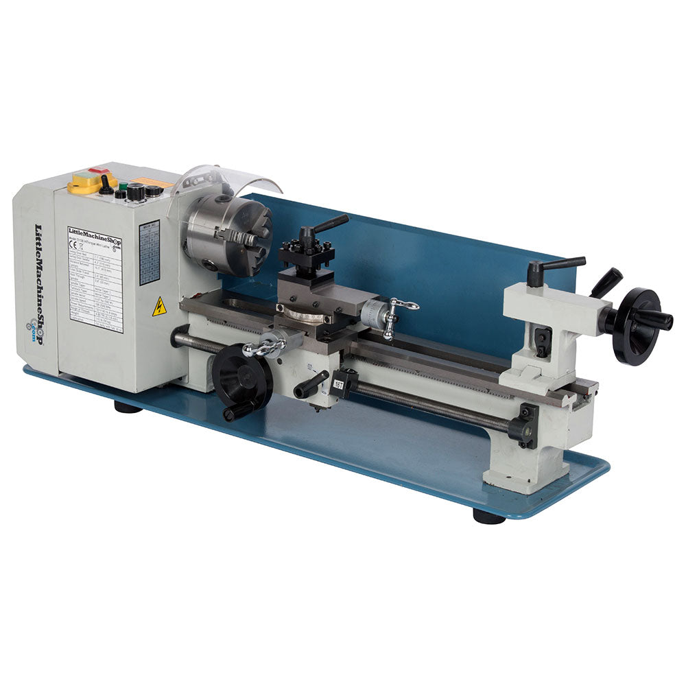

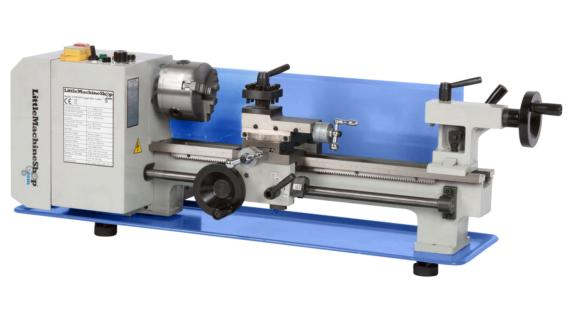

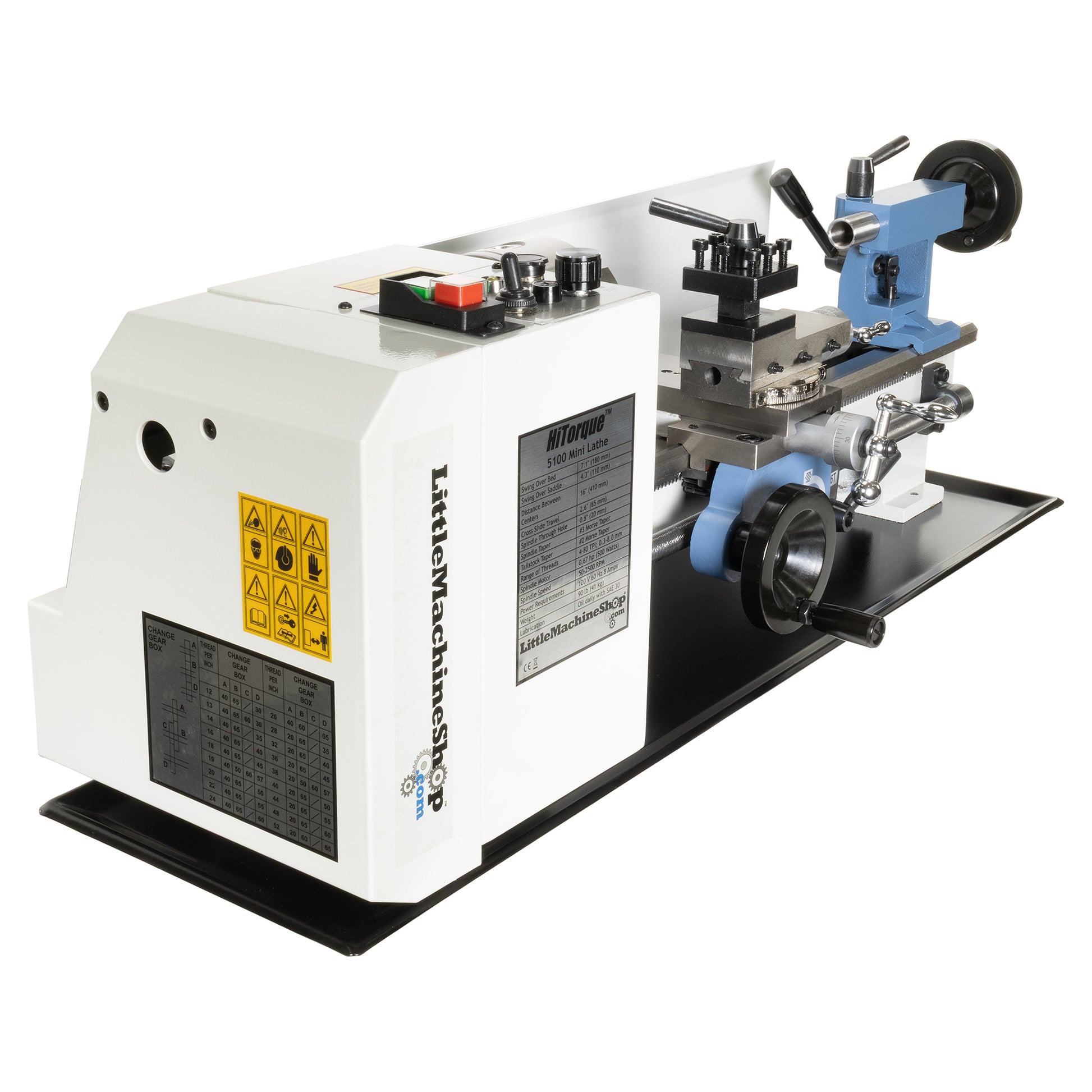

  • Extended bed (16" between centers) provides more working room
  • Most powerful and most low-speed torque in its class. No gears in spindle drive
  • 4" 3-jaw lathe chuck

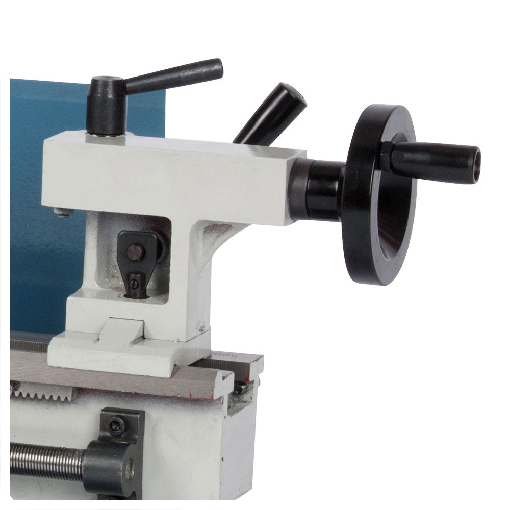

  • Cam lock tailstock

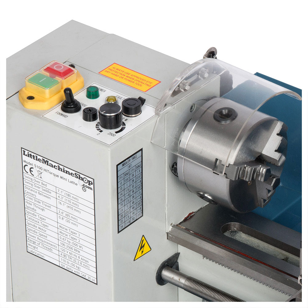

  • CHUCK GUARD HAS NOW BEEN REMOVED
The LittleMachineShop.com HiTorque 7x16 Mini Lathe is the best in its class. It has the most power, most torque, and a longer center distance than other lathes in its class.
The 500-Watt brushless spindle drive motor provides tremendous low-end torque. You can vary the speed from 50 rpm to 2500 rpm continuously in both directions. There are no gears to shift. NSK Bearings ensure years of accurate and reliable life.

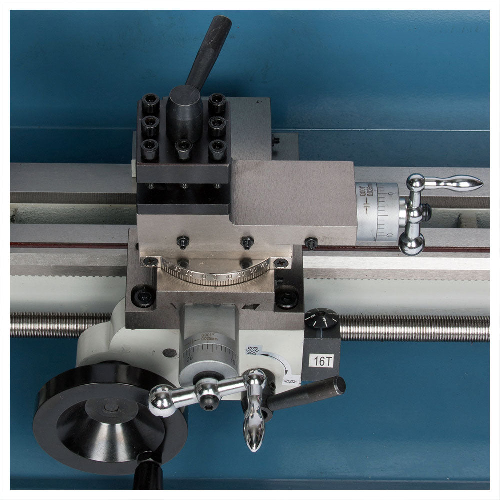

The cross feed and compound rest dials are graduated in 0.001" and 0.025 mm. A 4" 3-jaw lathe chuck is included, and the lathe is equipped with a 4-way indexing tool post set for 5/16" (8 mm) tools.
Real top and bottom half-nuts and a reversible 16 TPI lead screw provide extended threading capability. You can create every American Standard Unified class 2A inch screw thread from 4 to 80 threads per inch, and you can create every American Standard Metric class 6h thread from 0.35 to 8 mm pitch with the extra 21 tooth change gear that is included. Cutting inch threads is made even easier with the factory-installed threading dial.
This machine is shipped completely assembled and adjusted. Machined surfaces are coated with a viscous oil to prevent rust. It wipes off easily with a rag--no solvents necessary.
The LittleMachineShop.com exclusive version of this machine features:
  • Full 14" bed length with a cam-lock tailstock for longer work pieces.
  • 500-Watt spindle motor with 2 Speed ranges for low speed torque
  • NSK brand Japanese bearings
  • Digital spindle speed readout
  • Real top and bottom half-nuts and a reversible 16 TPI lead screw provide extended threading capability.
  • Threading dial
  • The cross feed and compound rest dials are graduated in 0.001" and 0.025 mm.
  • The lathe is equipped with a 4-way indexing tool post set for 5/16" (8 mm) tools.
  • Chip tray and backsplash.
  • User’s Manual
  • Made and inspected in an ISO 9001 compliant factory
The LittleMachineShop.com exclusive version of this machine includes:
  • 4" (100 mm) 3-jaw self-centering lathe chuck with two sets of jaws and a chuck wrench
  • A #2 Morse Taper (2MT) dead center
  • 11-piece Change gear set
  • Two open end wrenches
  • Four hex (Allen) wrenches
  • A plastic oil can
The LittleMachineShop.com model 5100 HiTorque Mini Lathe is a version of the SIEG SC2.
* Our mini lathes do not have a chuck guard on them. Factory guard restricted use of larger chucks, interfered with visibility & workpiece access, and offered little benefit. This decision was made years ago after much feedback from customers. (We are working to update photo)

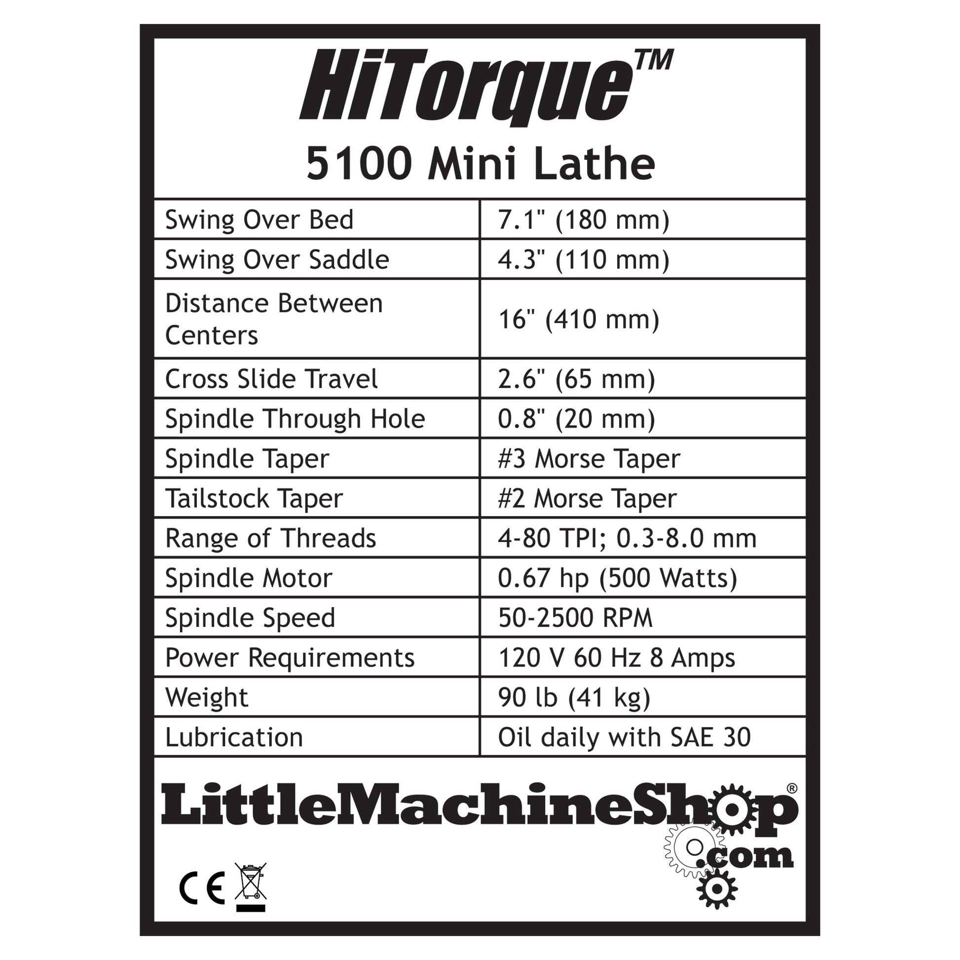

Swing Over Bed: 7.087" (180 mm)
Distance Between Centers: 16.142" (410 mm)
Cross Slide Travel: 2.559" (65 mm)
Swing Over Cross Slide: 2.165" (55 mm)
Spindle Through Hole: 0.787" (20 mm)
Spindle Taper: #3 Morse taper
Tailstock Taper: #2 Morse taper
Range of Threads: 4-80 TPI; 0.35-8.0 mm
Spindle Motor Output: 0.67 hp (500 Watts)
Spindle Speed: 60 to 2500 RPM
Power Requirements: 120 V 60 HZ 8 Amps
Machine Weight: 90 lbs (41 kg)
Crated Weight: 115 lbs (52 kg)
Overall Dimensions (W x D x H): 31.102" x 10.236" x 11.811" (790 mm x 260 mm x 300 mm)
