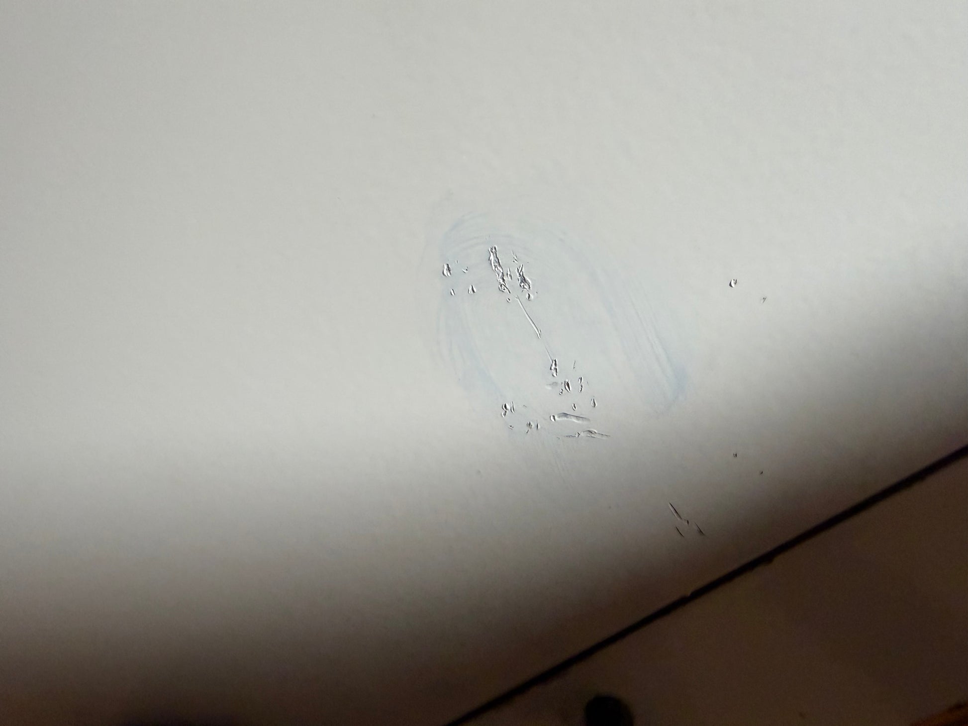

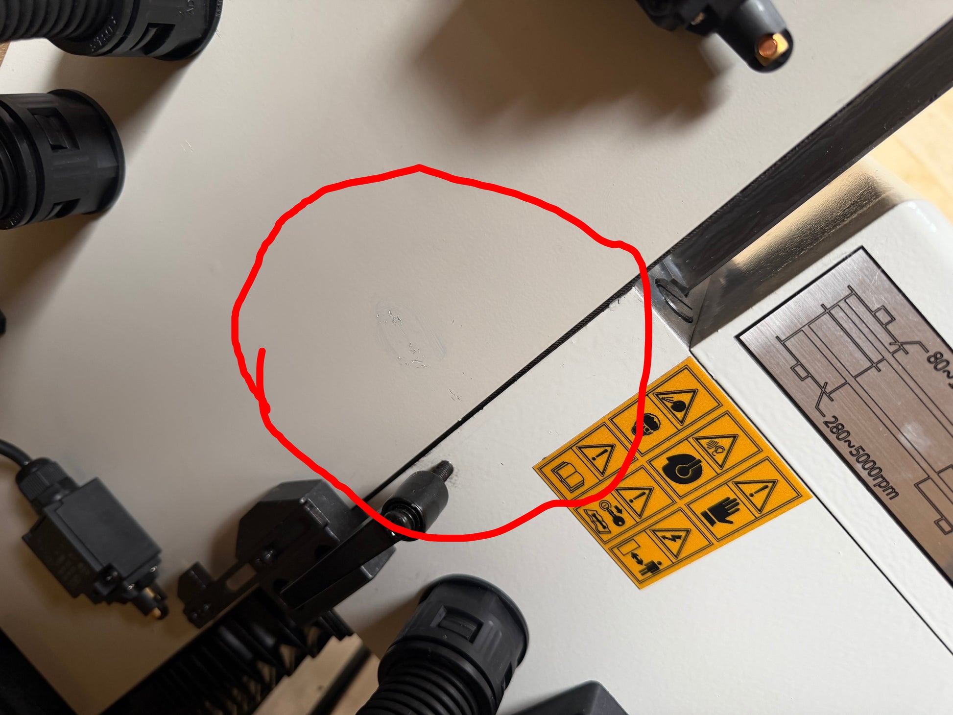

We opened this machine when we received and noticed some paint issues. Nothing functional, but looks like it got scratched in production and the paint touchup wasn't exactly the right color. Can't sell as new, so a great deal if that stuff doesn't matter to you. Put a sticker over it....
