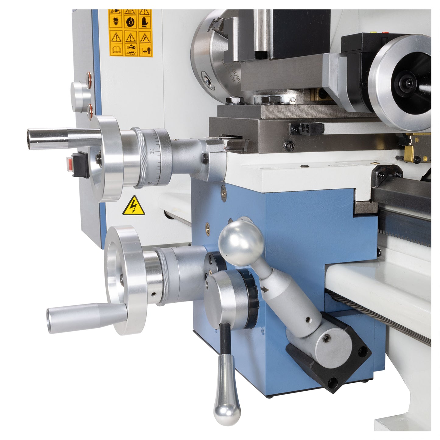

  • Power longitudinal feed and power cross feed

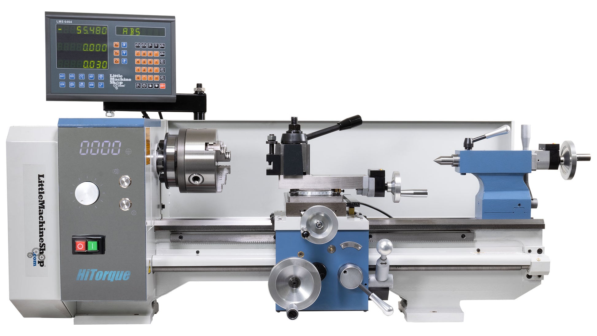

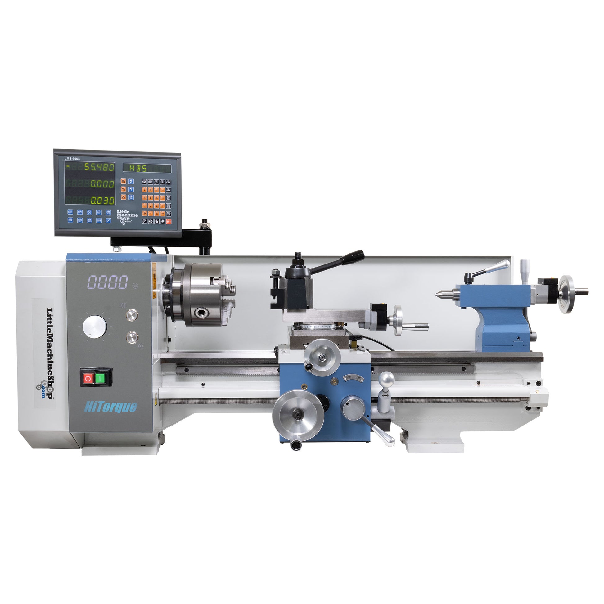

The LittleMachineShop.com model 7650 HiTorque 9x20 Deluxe Bench Lathe is the best in its class. It is a significant step up in size, rigidity, and power compared to a mini lathe. This bench top lathe provides a larger bed, more swing over bed, more horsepower, and more rigidity. Compare our standard features and specs to others in this size and price range.
  • NEW larger spindle through hole - 1.1" (28 mm) accepts 1" stock.
  • NEW greater swing from 8.5" to 9"

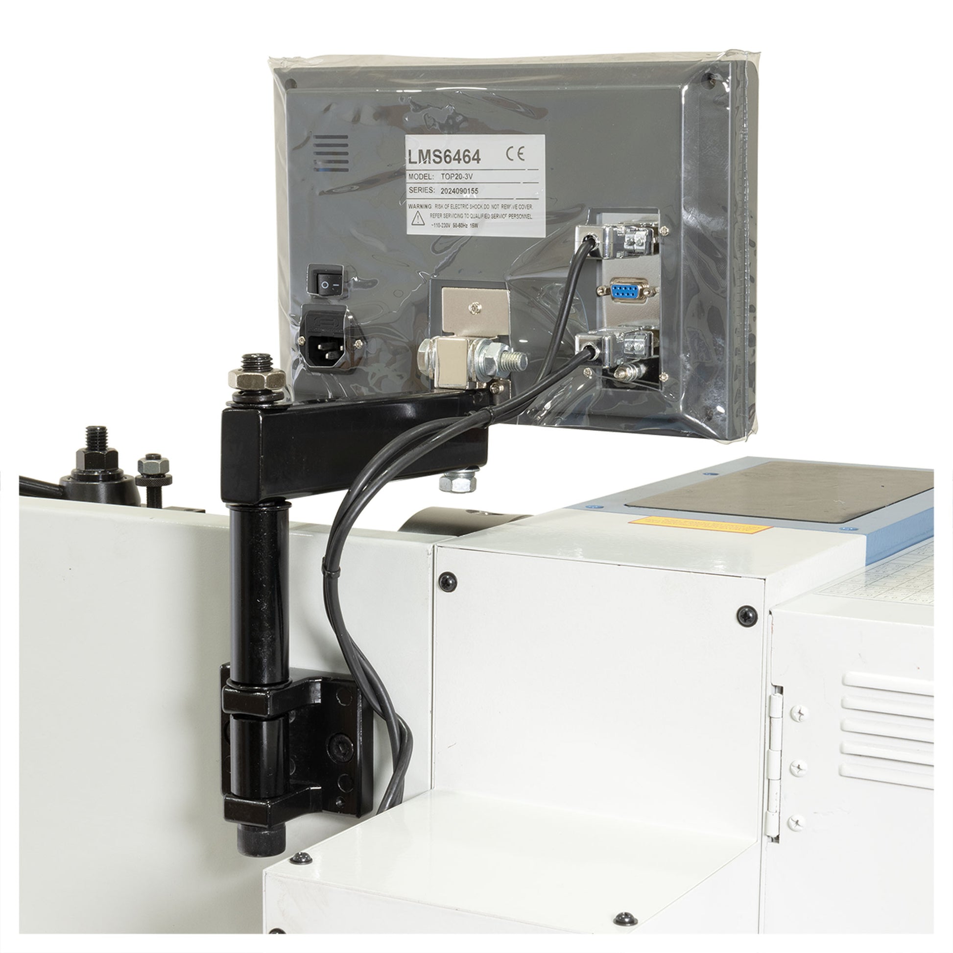

  • NEW easy-to-read LED display with built in speed readout

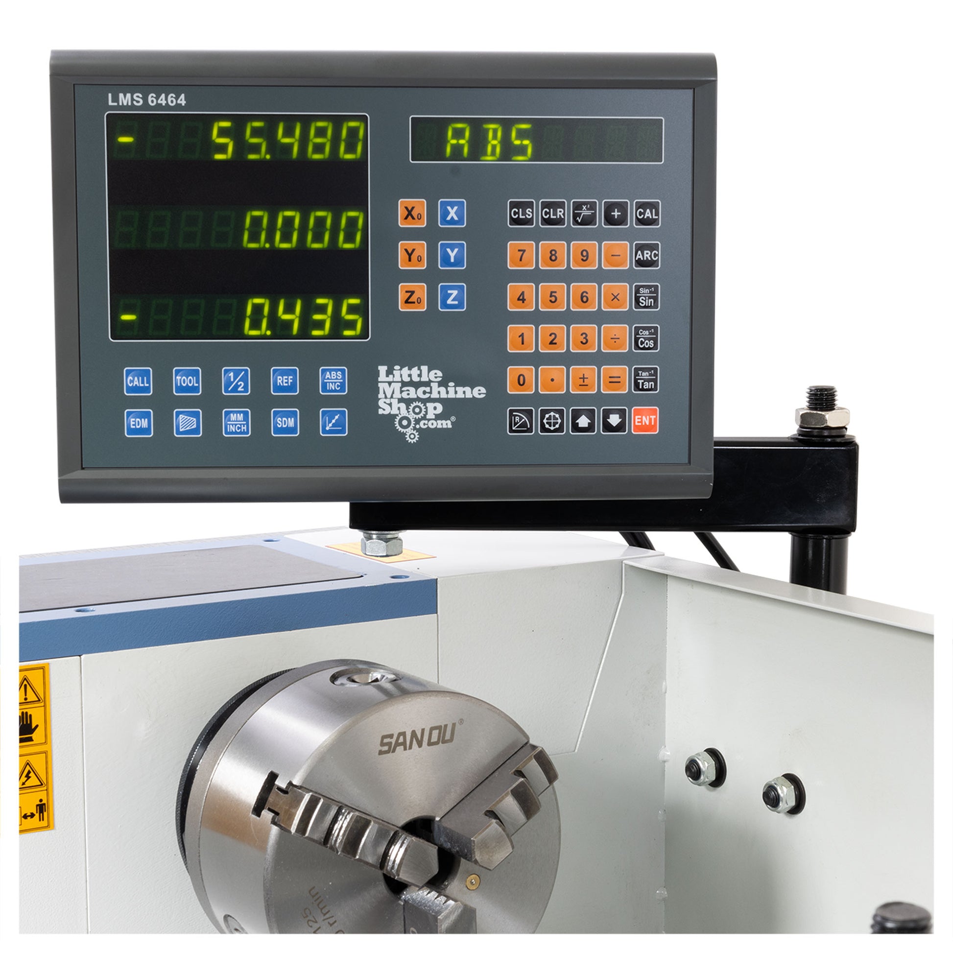

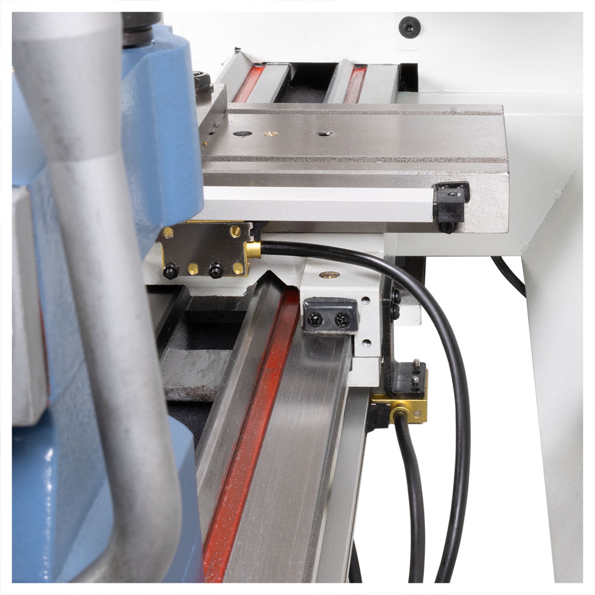

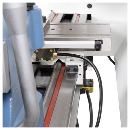

  • NEW factory installed hard-wired DRO on cross slide and carriage

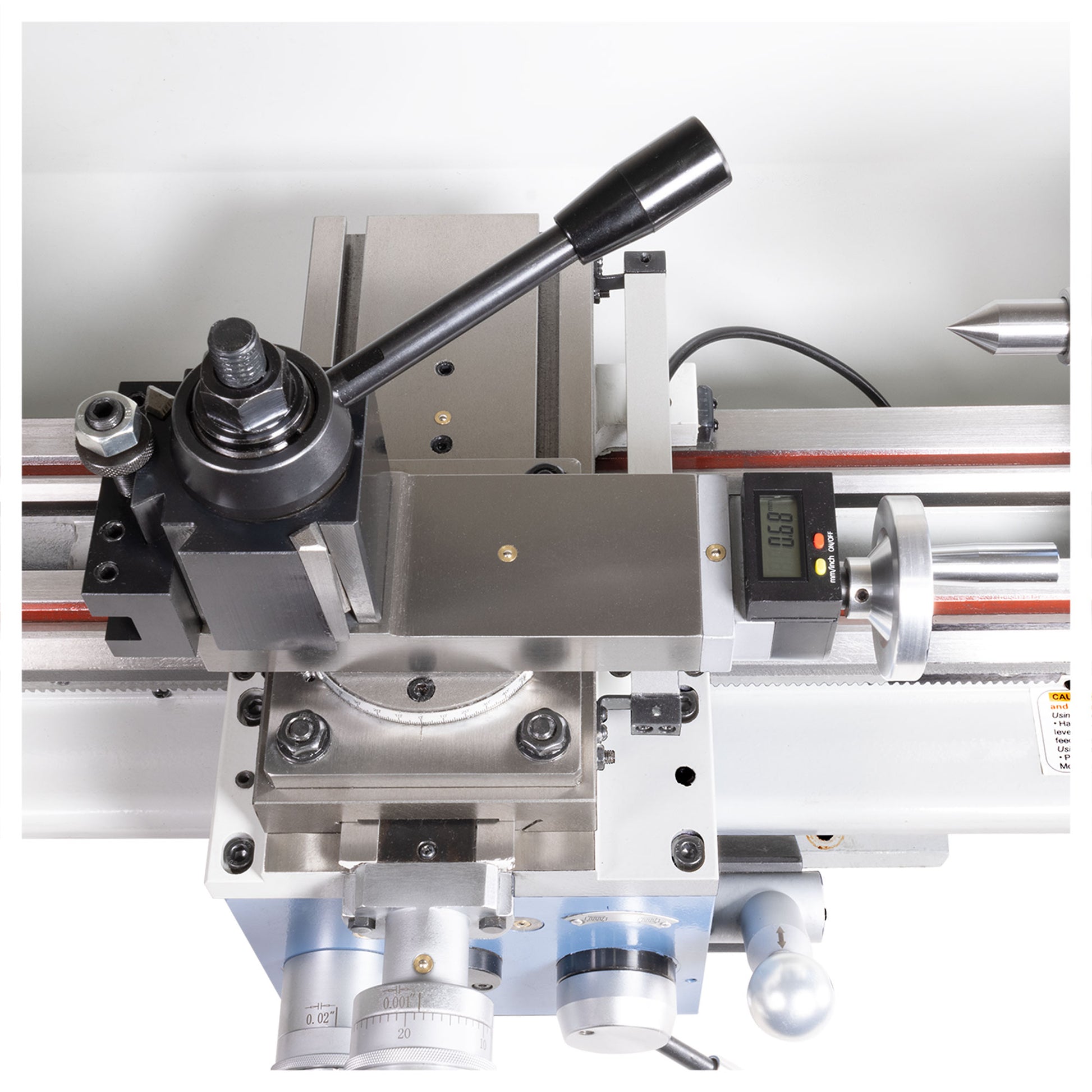

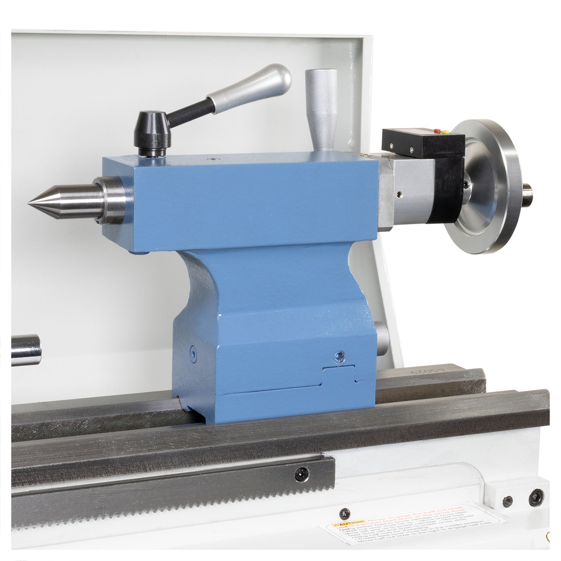

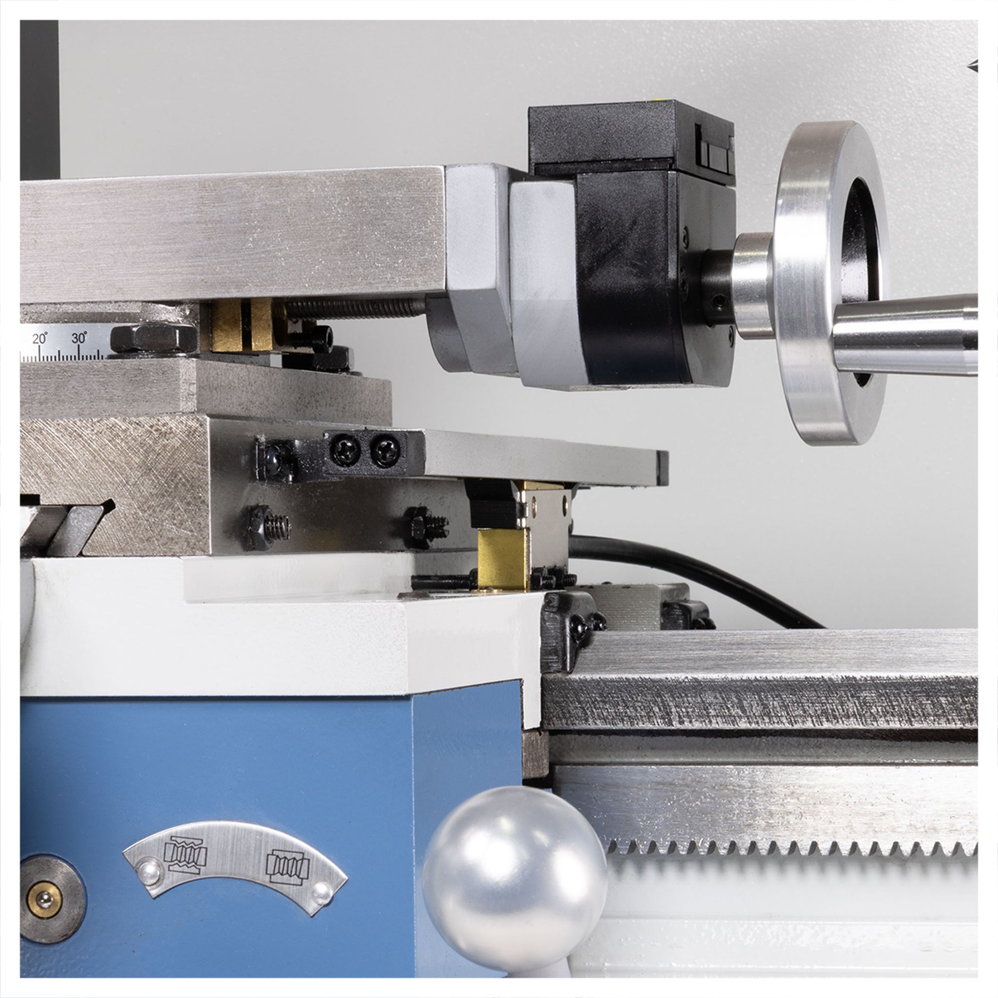

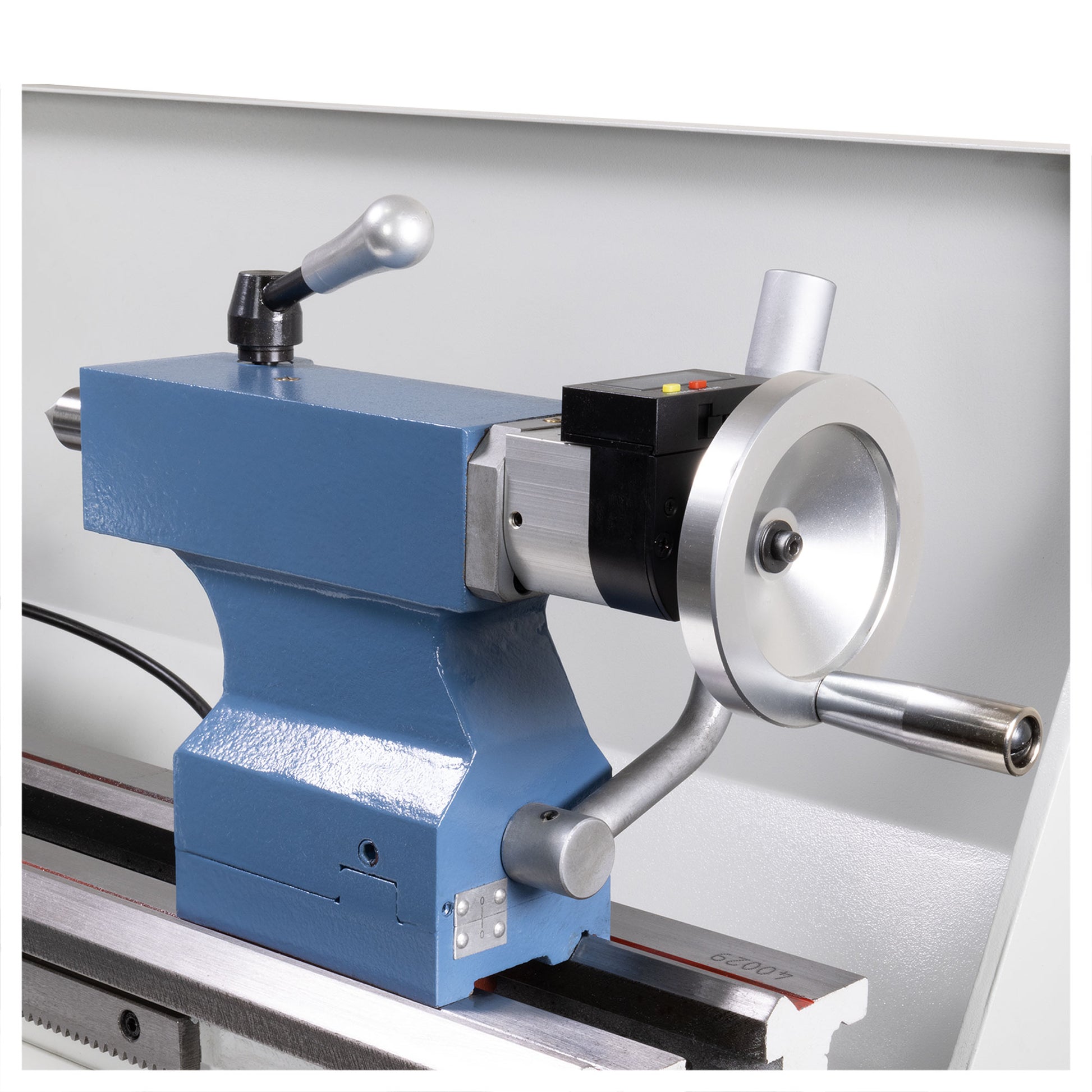

The Deluxe model includes digital readouts (DRO) on the compound rest, cross slide, carriage, and tailstock. Cross slide and carriage DROs feed data from mounted scales to a large display, while compound and tailstock use digital readouts on leadscrews. The DRO system measures in increments .0002" and comes factory installed on the lathe. All DROs read equally accurately in inches and mm.
The Deluxe model also includes an AXA quick change tool post set with five tool holders; anodized aluminum hand wheels; aluminum knobs and levers; and a heavy-duty splash guard that covers the full bed length. In addition, the compound rest is modified to better accommodate the quick-change tool post.
The 1000-Watt brushless spindle drive motor provides tremendous low-end torque. And you can vary the speed from 100 rpm to 2000 rpm continuously in both directions. There are no gears to shift. NSK brand Japanese-quality spindle bearings ensure years of quiet operation.
NEW easy-to-read LED display with built in speed readout allows you to stop and then restart the lathe at a pre-selected speed.

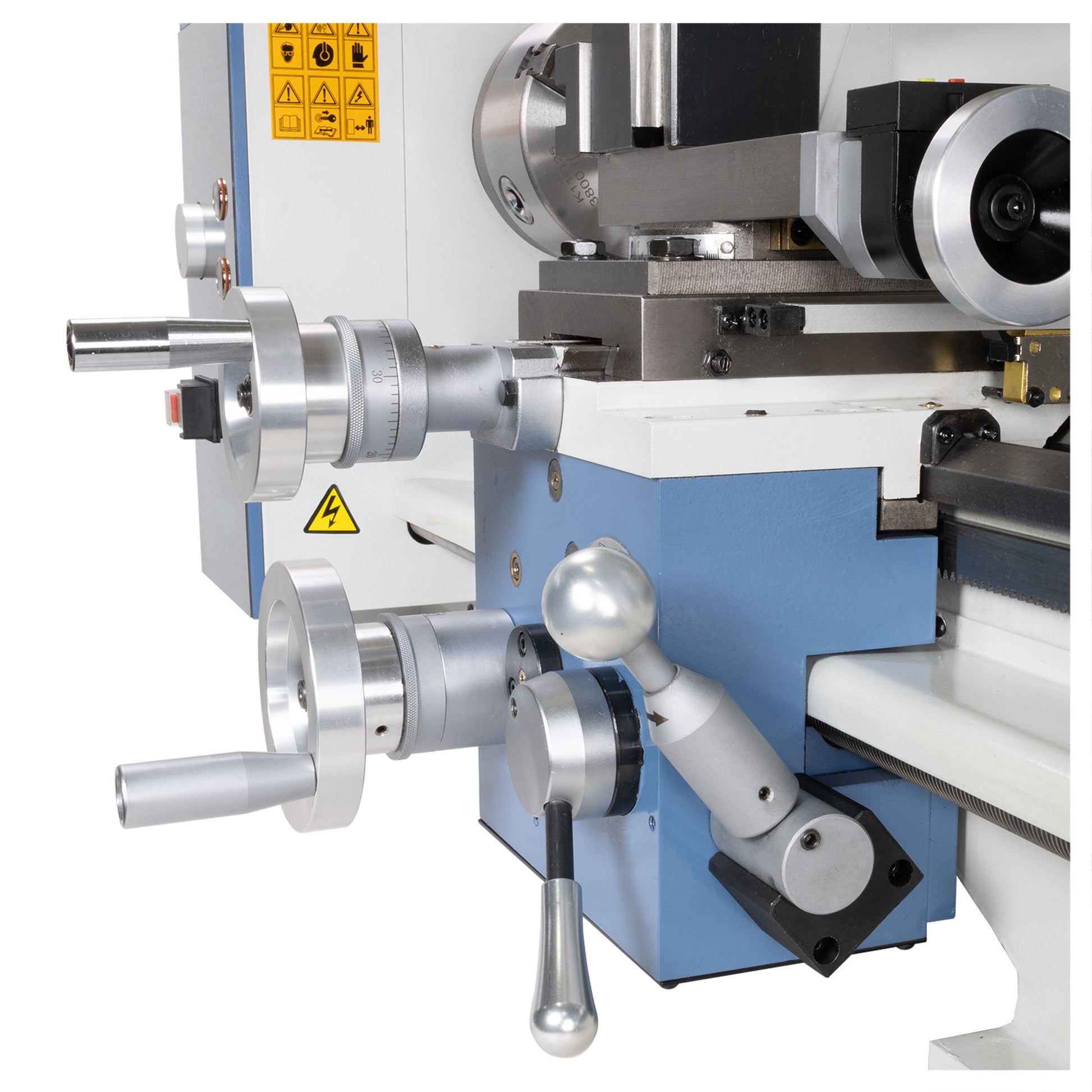

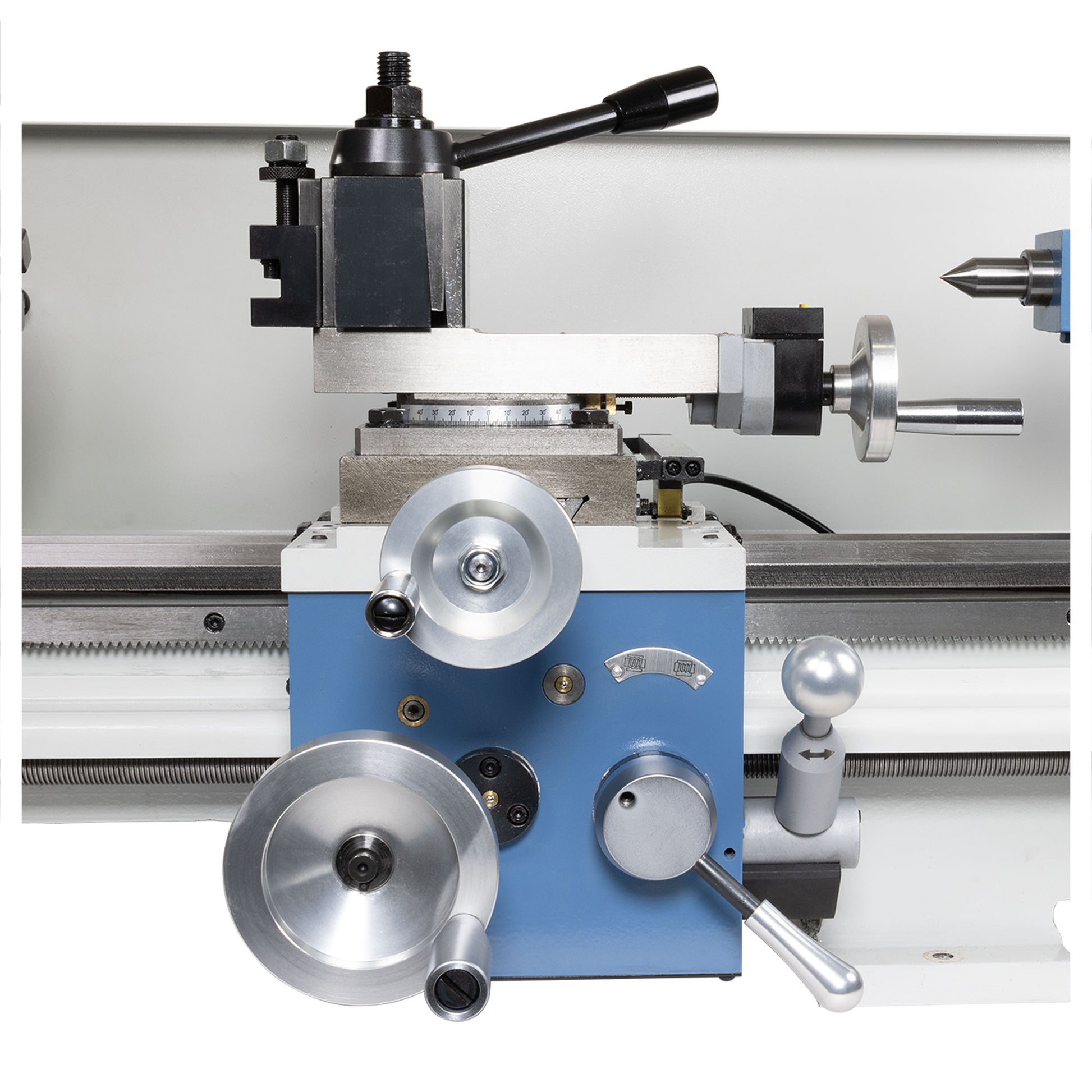

A power cross feed is a feature not found in other lathes of this size. The cross feed and compound rest dials are graduated in 0.001" and advance 0.050" per turn.

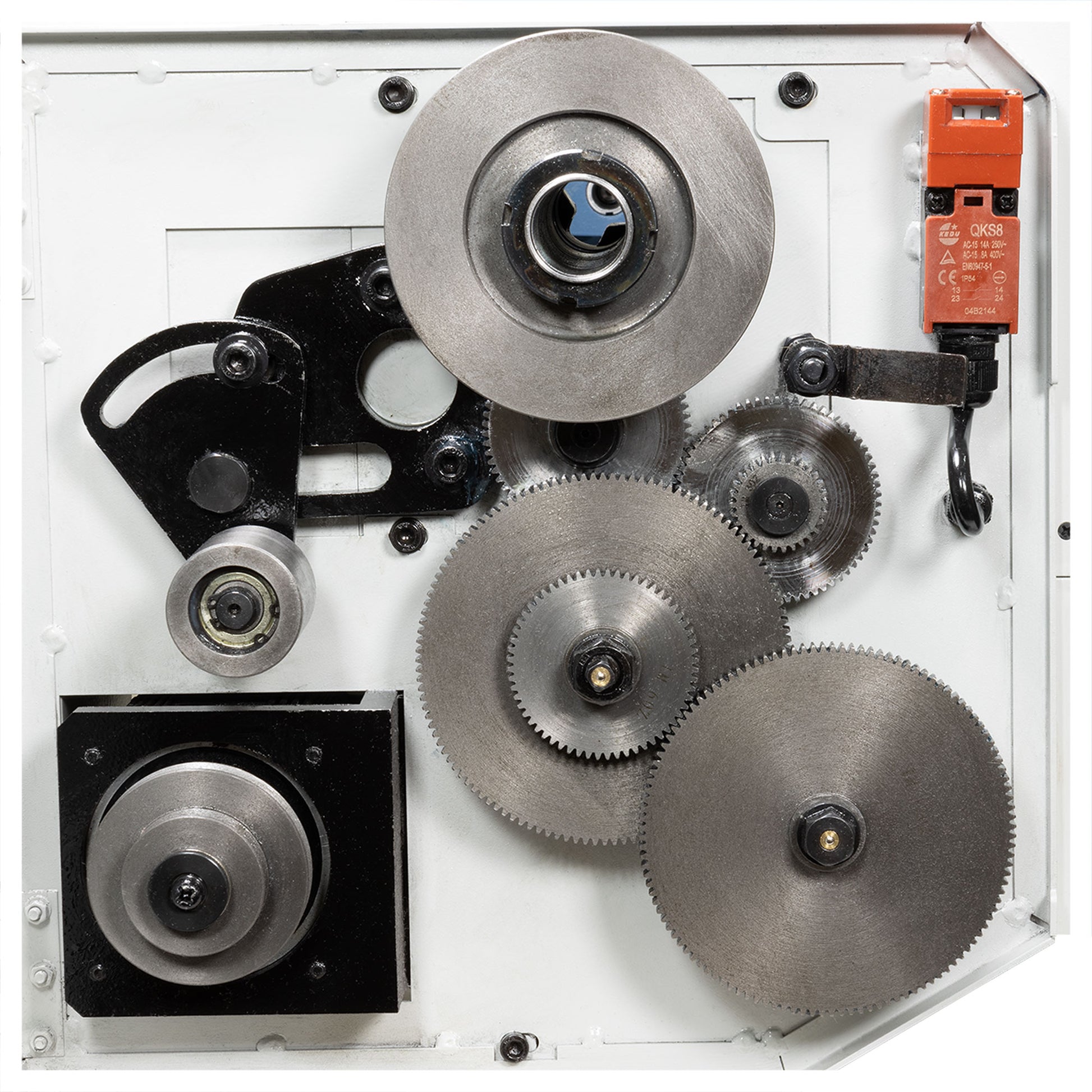

A reversible 2 mm pitch lead screw provide extended threading capability. You can create every American Standard Unified class 2A inch screw thread from 6 to 80 threads per inch, and you can create every American Standard Metric class 6h thread from 0.25 to 4 mm pitch with the change gears that are included. All the gears on this lathe are metal.
  • DRCD digital readout on compound and tailstock
  • All DROs read equally accurately in inches and mm.
  • Power cross feed

  • Zero-resettable dials graduated at 0.001" and advancing 0.050" per turn
  • Cam-lock tailstock

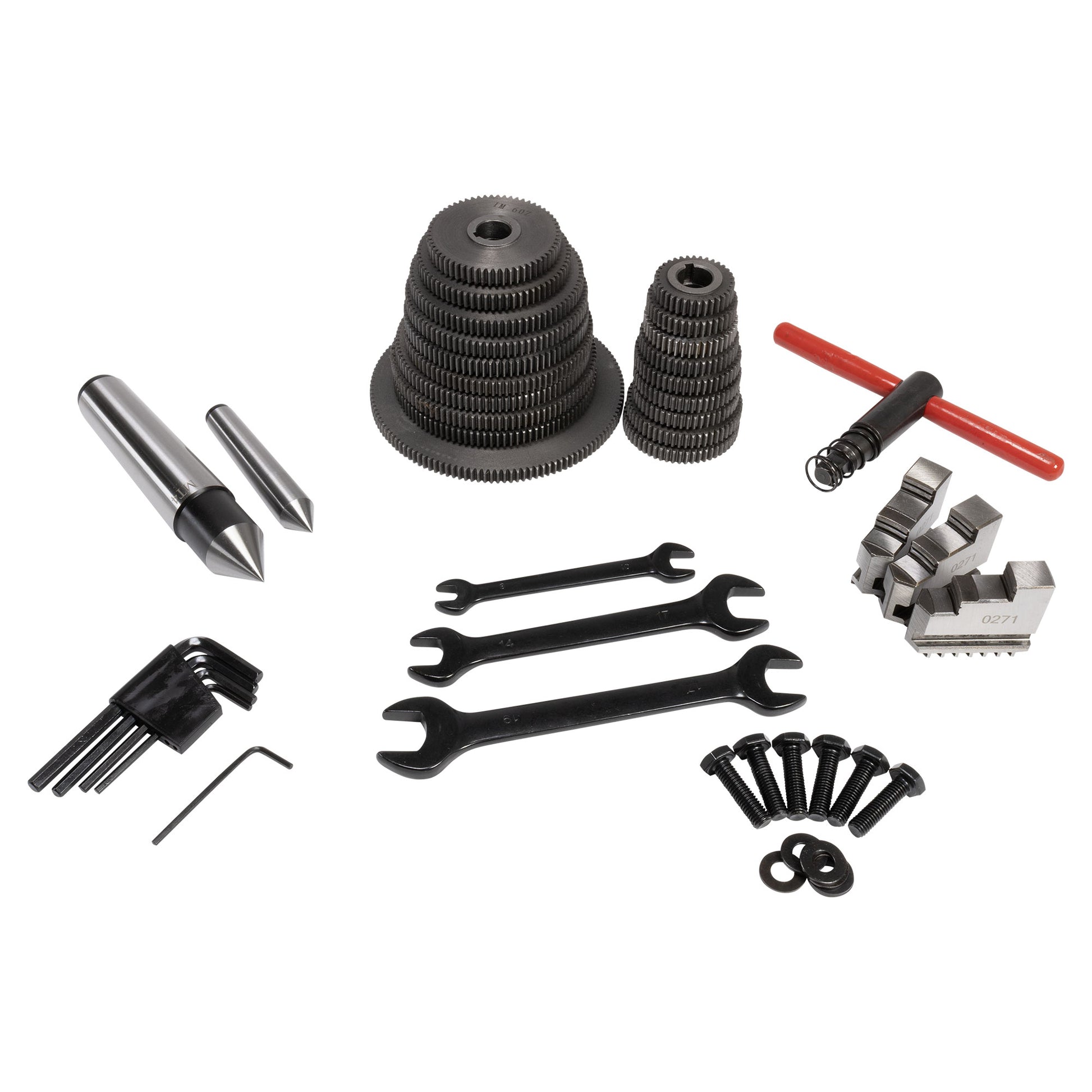

The Bench Lathe comes with the following:
  • 5" (125 mm) 3-jaw self centering lathe chuck with two sets of jaws and a chuck wrench
  • 4-Way rotating tool post
  • A #4 Morse taper dead center for the headstock
  • A #2 Morse taper dead center for the tailstock

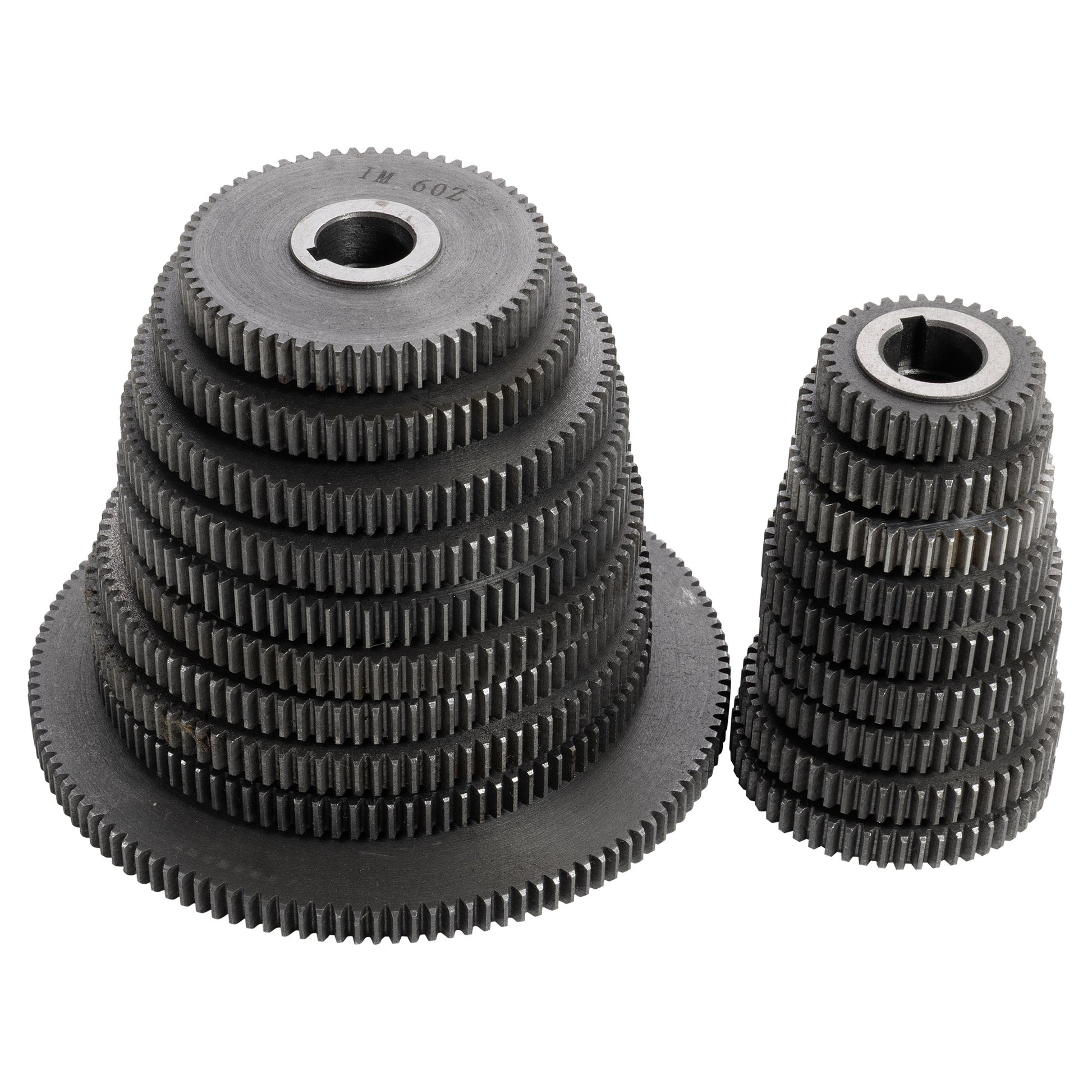

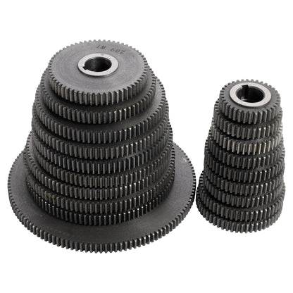

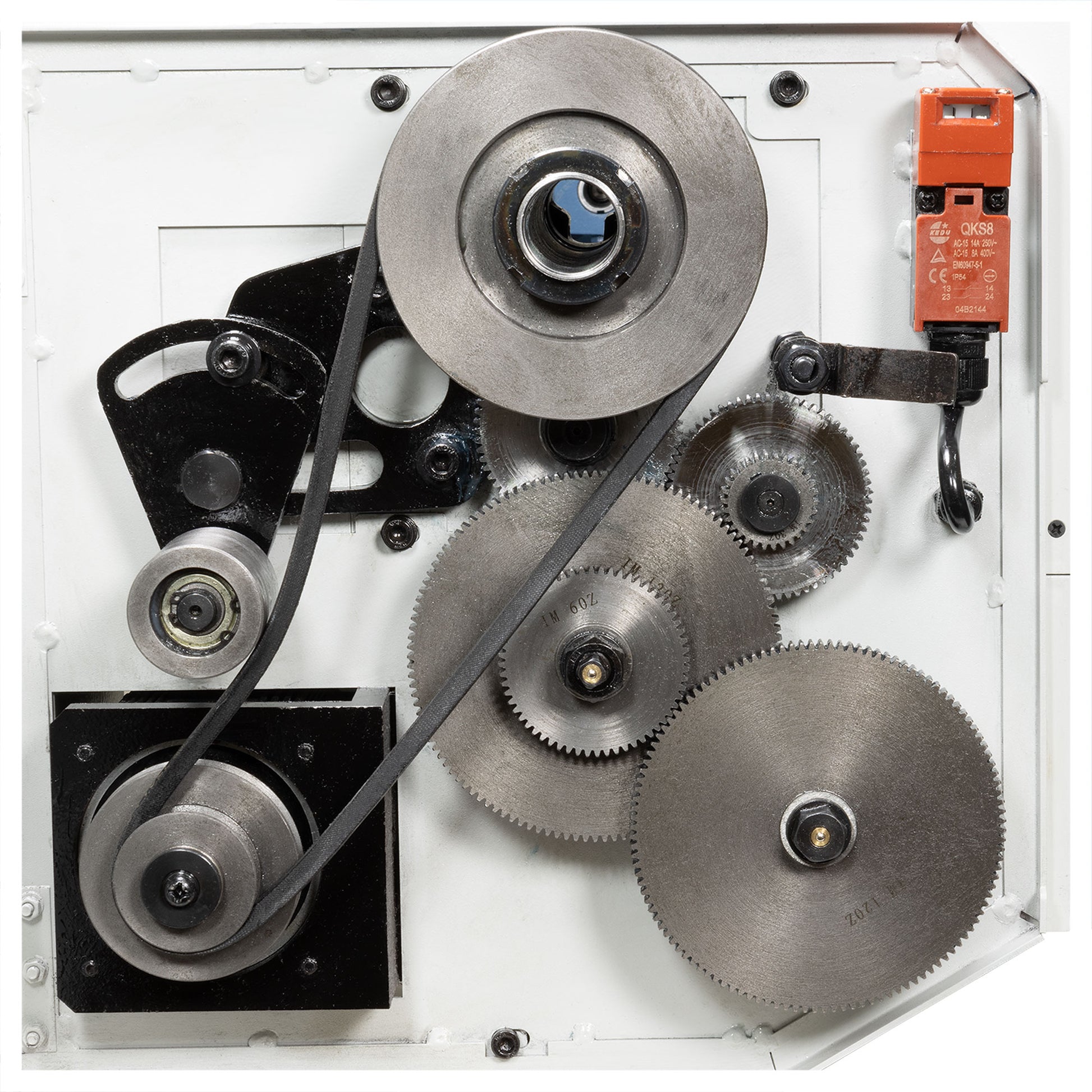

  • Change gear set - 18 Gears - 35, 40, 45, 49, 50(x2), 55, 56, 60, 70, 80, 85, 87, 90, 94, 100(x2), 127 teeth
  • Gears installed on the lathe include 30, 60, 66(x2), 120(x2) teeth
  • Three open end wrenches: 8/10 mm, 14/17 mm, 17/19 mm
  • Five hex (Allen) wrenches: 2, 3, 4, 5, 6 mm
  • User's Manual
  • Inspection Report

With this lathe, you can create every American Standard Unified class 2A inch screw thread from 4 to 100 threads per inch, and you can create every American Standard Metric class 6h thread from 0.25 to 8 mm pitch with the extra 21 tooth change gear that is included.
But you can actually make more thread pitches than that, and there are more change gear combinations than those shown in the user's guide. To see what you can really do, see the Change Gear Calculator.
