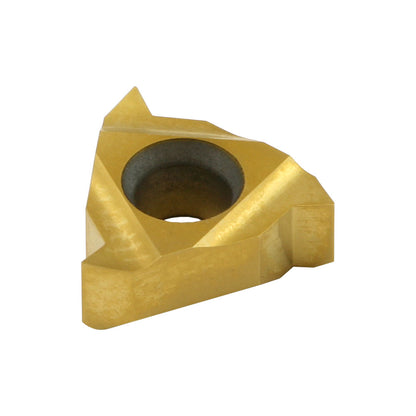

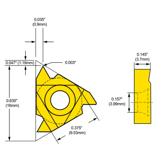

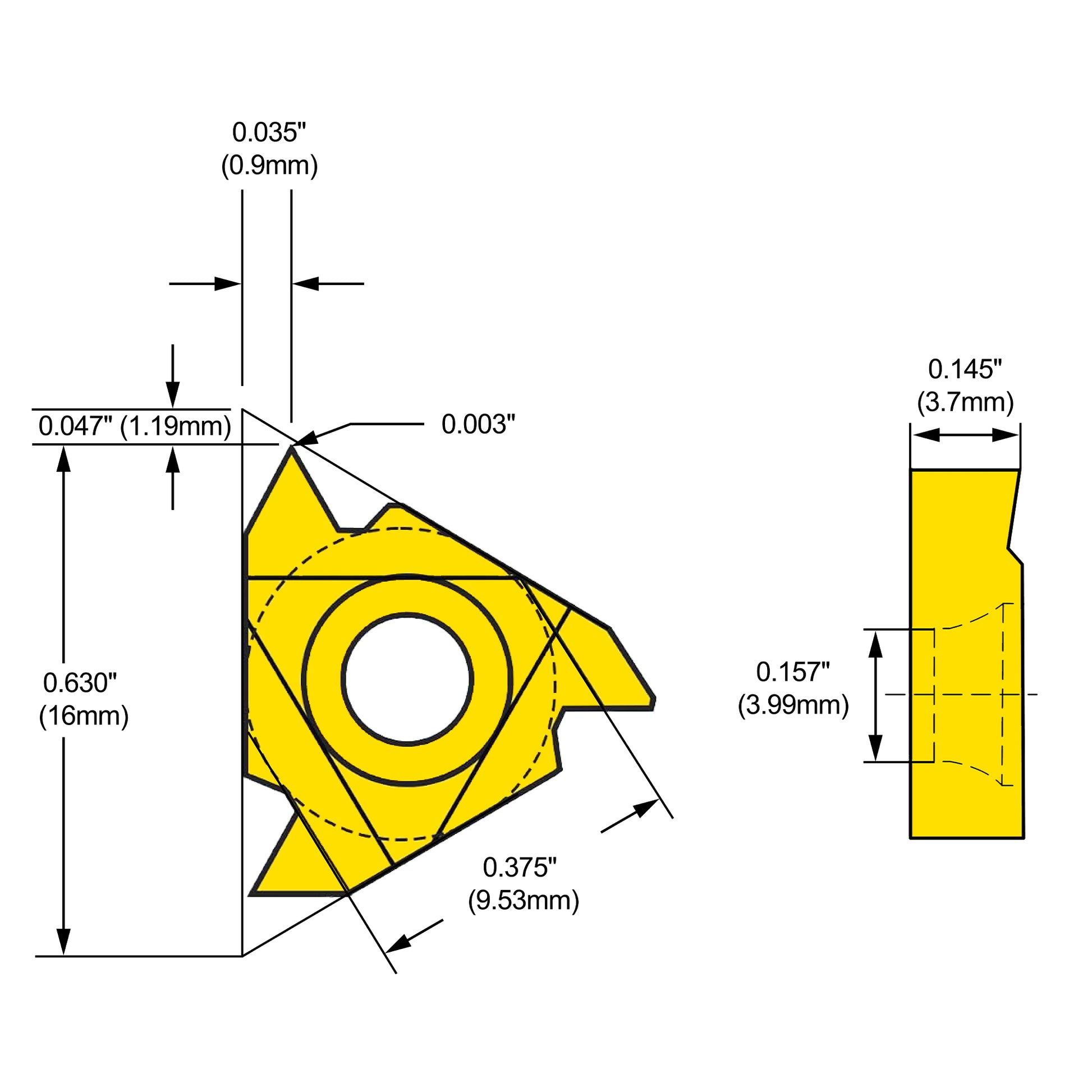

The 16ERA60 TiN Coated external threading carbide Insert. It has a 60° V partial profile, allowing machinists to cut a wide variety of thread pitches without changing inserts.
  • 60° V partial profile threading insert
  • Insert is 16ERAG60
  • I.C. is 3/8"
  • Pitch range is 0.5-3.0
  • TPI is 8-48
The partial profile design (sometimes called non-cresting) only cuts the thread groove. Due to the small nose radius (0.003") a single insert can cut multiple thread pitches providing the profile angle is 60°.
The carbide substrate absorbs the cutting force and vibrations when threading steel, stainless steel and cast iron. The TiN (Titanium Nitrite) coating provides low friction and high surface hardness. Its heat and wear resistance extends the life of your cutting tool.
