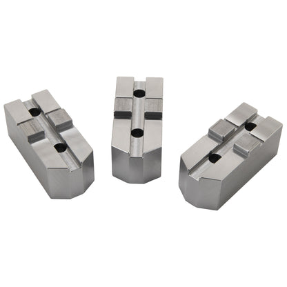

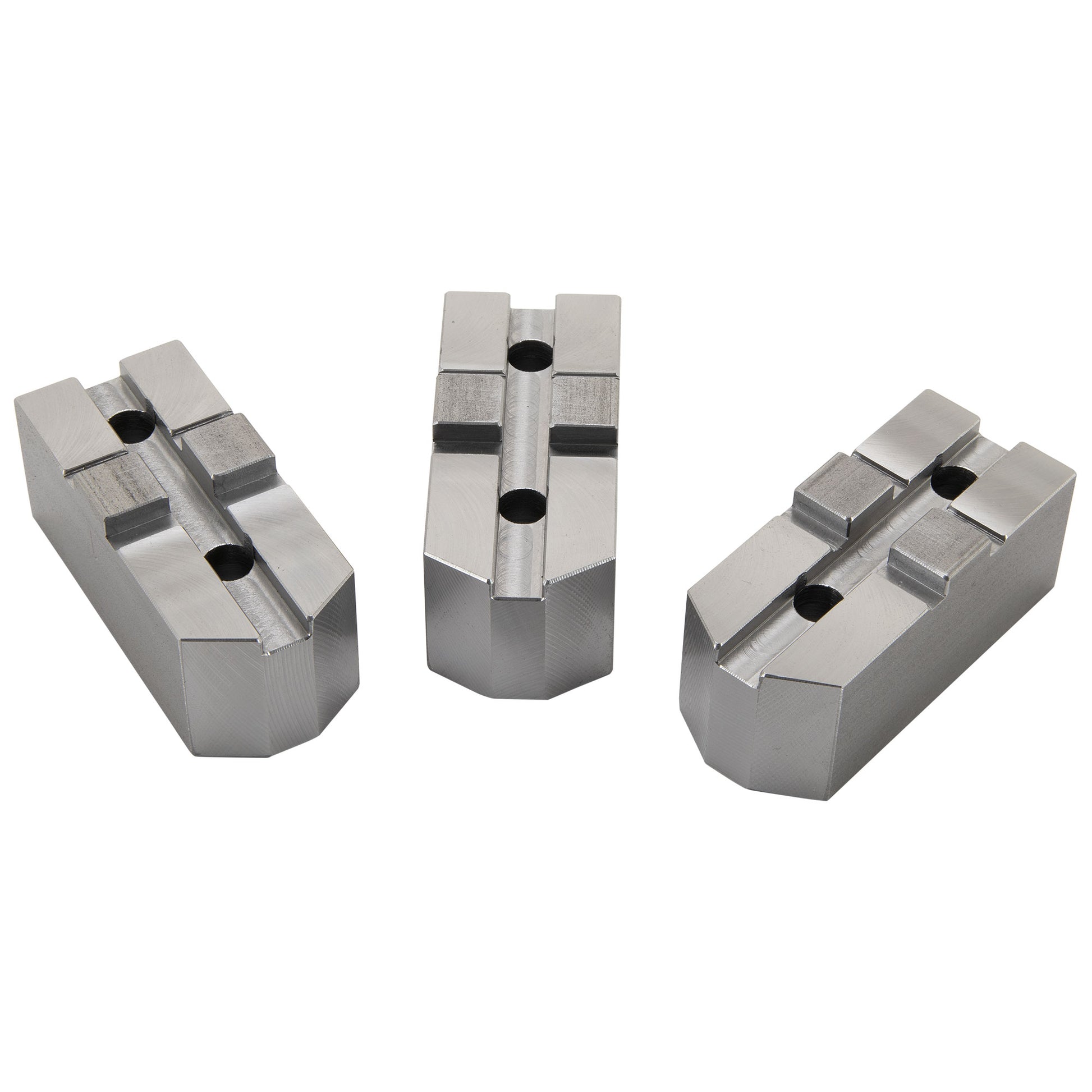

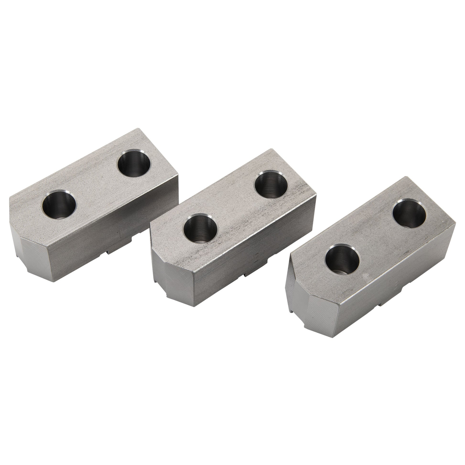

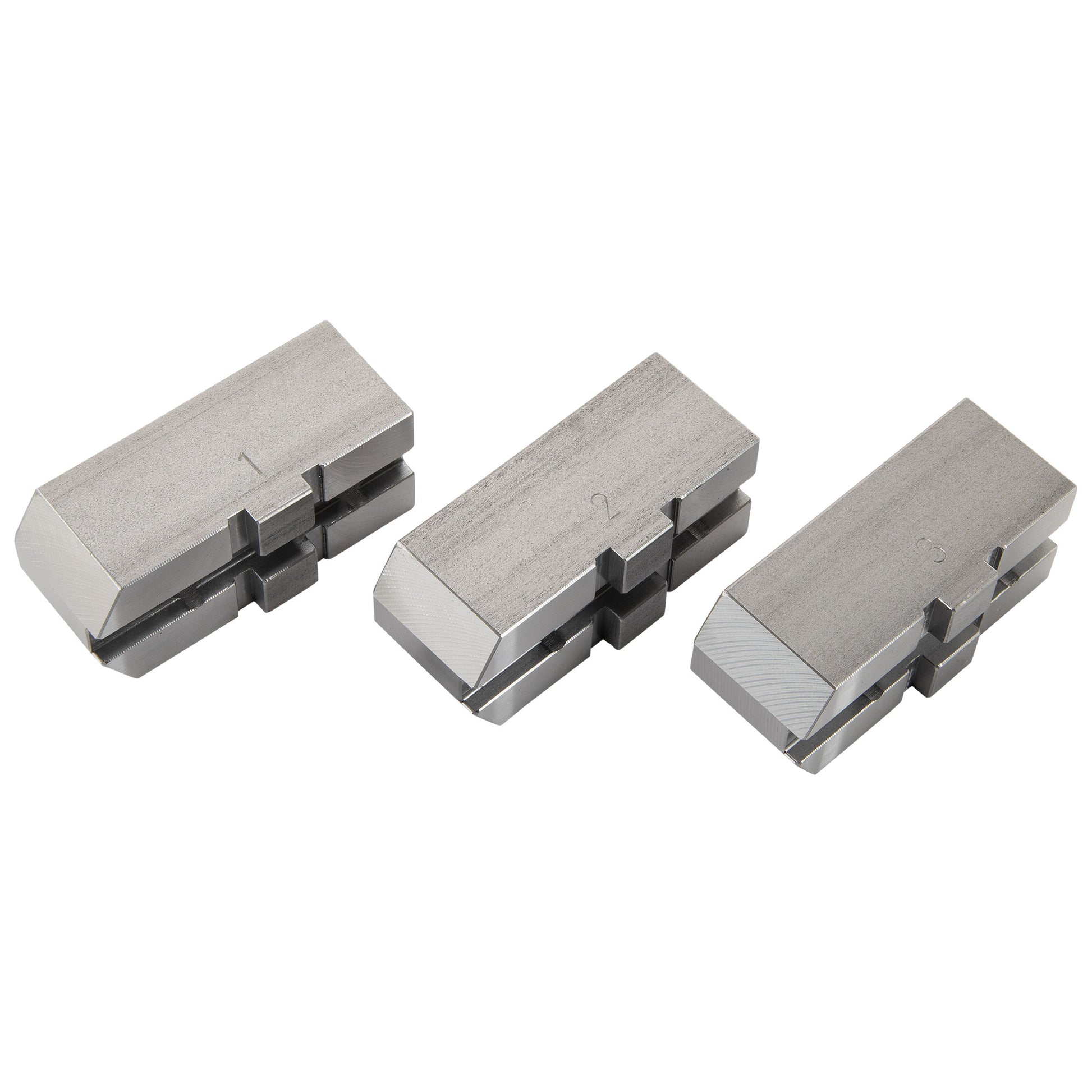

Jaws (SOFT), 6" Lathe Chuck
Regular price $49.95
SKU:1307Shelf Location: (C09 - 03)
  • Set of 3 soft jaws
  • Fits 3-jaw 6" lathe chuck with two-piece jaws
  • Tongue & groove steel soft jaw set
  • Can be bored or turned to fit work piece
Supplies maximum concentricity on finish turning operations.
Can be bored or turned to fit workpiece.
Jaws can be hardened.
Chuck Size 6".
Groove Width D is 0.313
Tongue Width G is 1/2
Screw Size E is 5/16
Hole Space F is 1.500
Tongue to Front H is 0.866
Tongue Position C is Offset
Width Inch A is 1-1/4
Length Inch B is 2-7/8
Height Inch is 1-1/4
For use on Buck, Bison, Cushman, Huron, PBA, Yuasa and Rohm Chucks.
