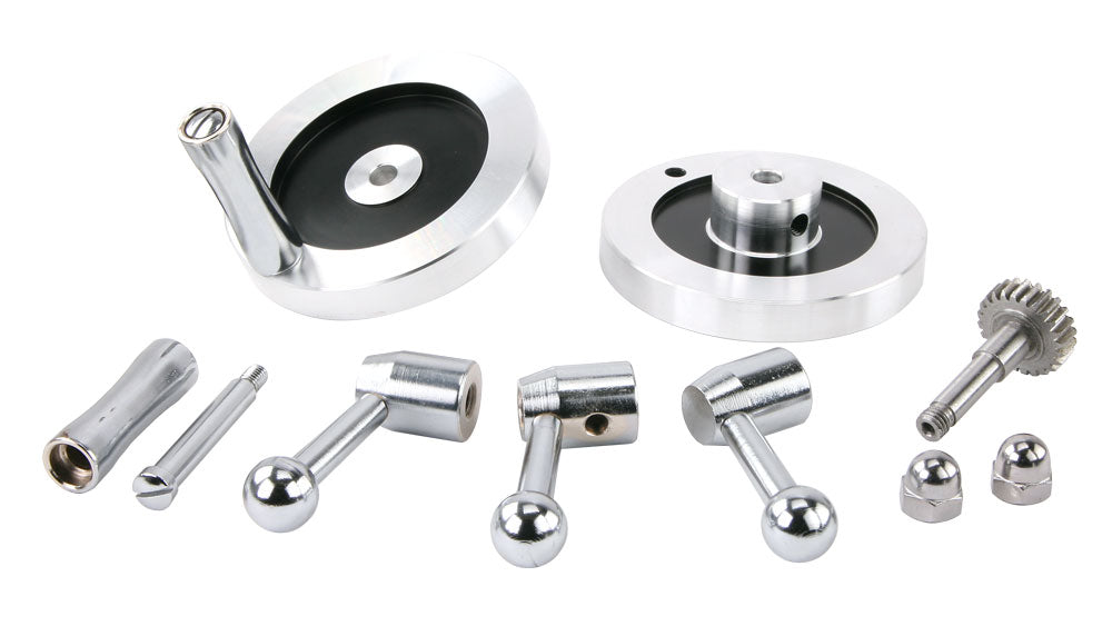

  • Anodized handwheels for apron and tailstock
  • Chrome levers for half-nuts, tool post and tailstock
  • Handwheels: 90 mm OD, 8 mm bore
  • Levers: M8 threading
  • Acron Nuts: M8 threading
The attractive handwheels are all metal, and the levers are chrome. Designed for SIEG C2, SC2 and C3 class of mini lathes as well as HiTorque mini lathes.
The saddle drive gear in this kit is an upgraded version with a threaded end. This allows the handwheel to hold to the gear shaft using one of the chrome acorn nuts. In the factory version of the lathe, the hand wheel was held to the gear using a cone point set screw.
The tailstock handwheel also has an acorn nut for attachment to the tailstock screw. In this application, the chrome acorn nut simply replaces a standard M8 nut.
Mini Lathe Knob and Hand Wheel Kit Contents:
  • Two chrome hand wheels
  • Two chrome handles
  • Two chrome handle bolts
  • Two chrome M8 acorn nuts
  • Three chrome levers with M8 threading
  • One upgraded 24 tooth saddle gear
