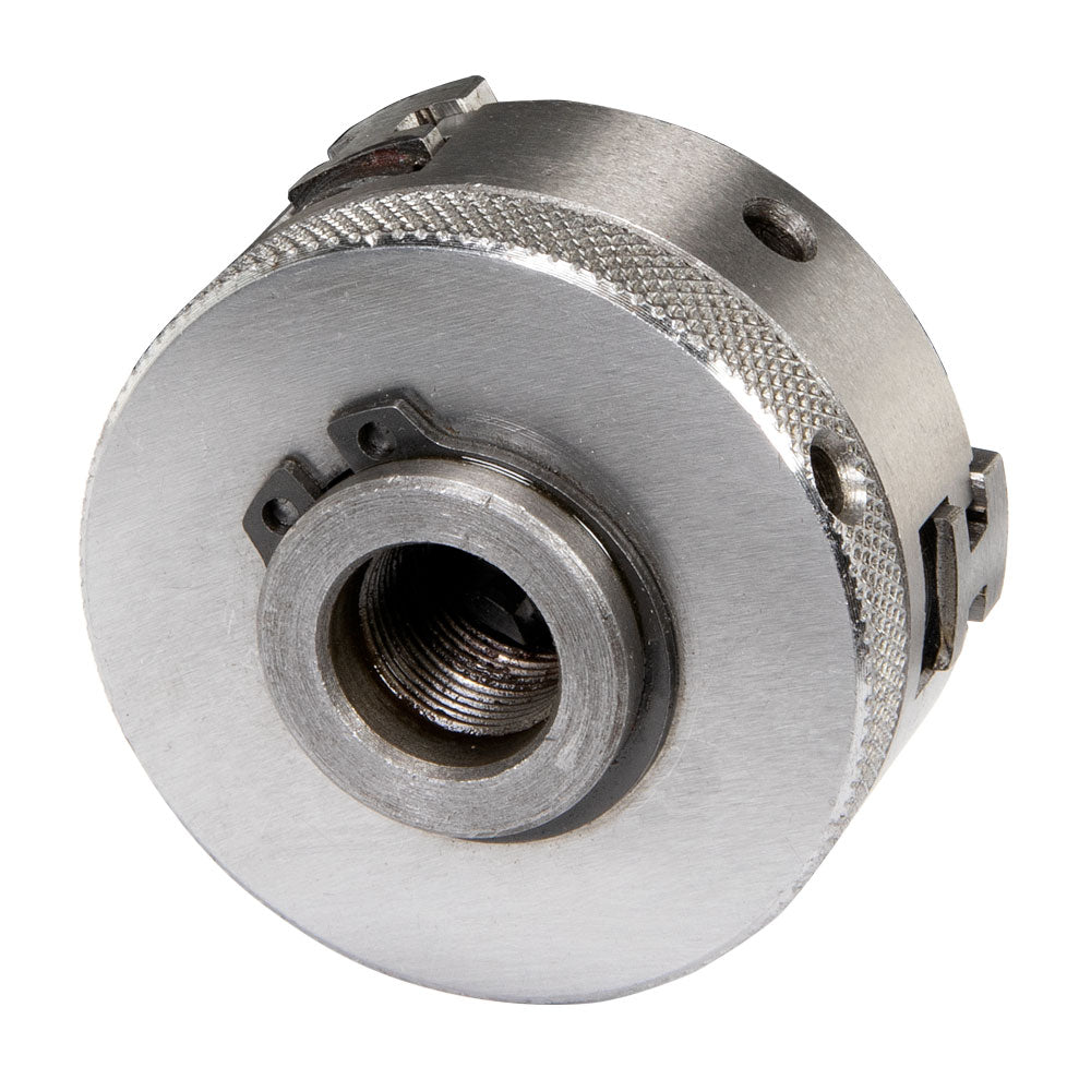

  • 3-jaw self-centering lathe chuck
  • 2" (50 mm) diameter

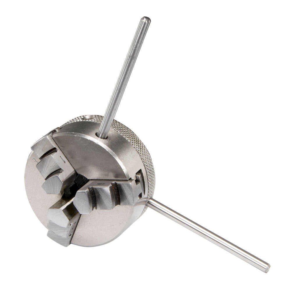

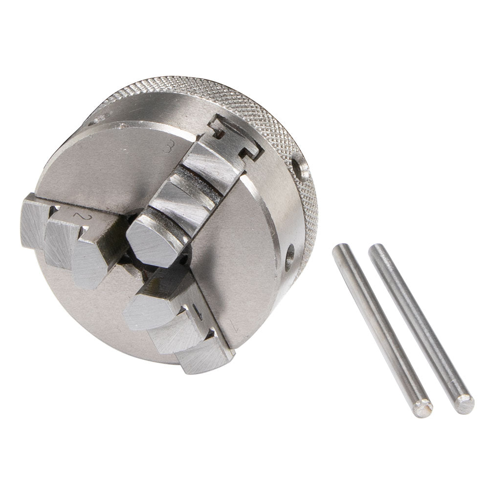

  • Includes reversible jaws and two tommy bars
This 2-inch 3-jaw self-centering lathe chuck fits Unimat 3 and Unimat 4 lathes.
This chuck has a M14x1 threaded through hole (approximately 13 mm). It holds work up to 1.30" (33 mm) in diameter.
This chuck requires a 15 mm OD x 14 mm ID bushing to mount on a Unimat 3 or 4.
Fits the SIEG C0 lathe.
Mount this chuck on a mini lathe with one of our chuck adapters. Or purchase a chuck with an adapter already mounted.
Here is a chart that provides Lathe chuck capacities and mounting dimensions.
Rated Capacity, Inside Jaws: 0.079" - 0.551" (2 mm - 14 mm)
Rated Capacity, Outside Jaws: 0.984" - 1.299" (25 mm - 33 mm)
Diameter, Overall: 1.969" (50 mm)
Registration Recess Diameter: 0.591" (15 mm)
Center Hole Diameter: 0.512" (13 mm)
Height: 0.906" (23 mm)
Jaw Height Above Face: 0.472" (12 mm)
Height with Jaws: 1.378" (35 mm)
