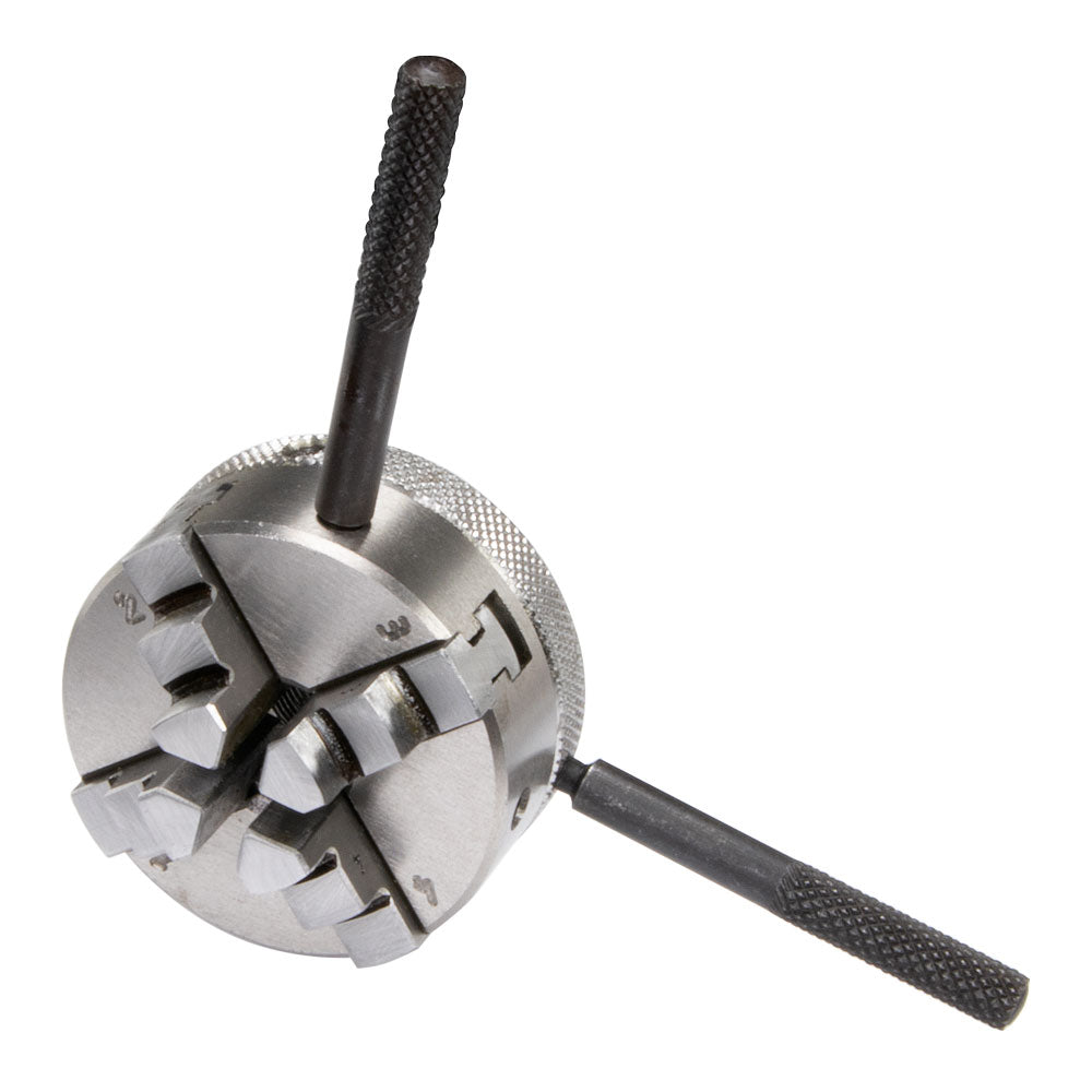

- 4-Jaw Self-Centering lathe chuck.
- 2" (50 mm) diameter
- Includes chuck key, inside and outside jaws

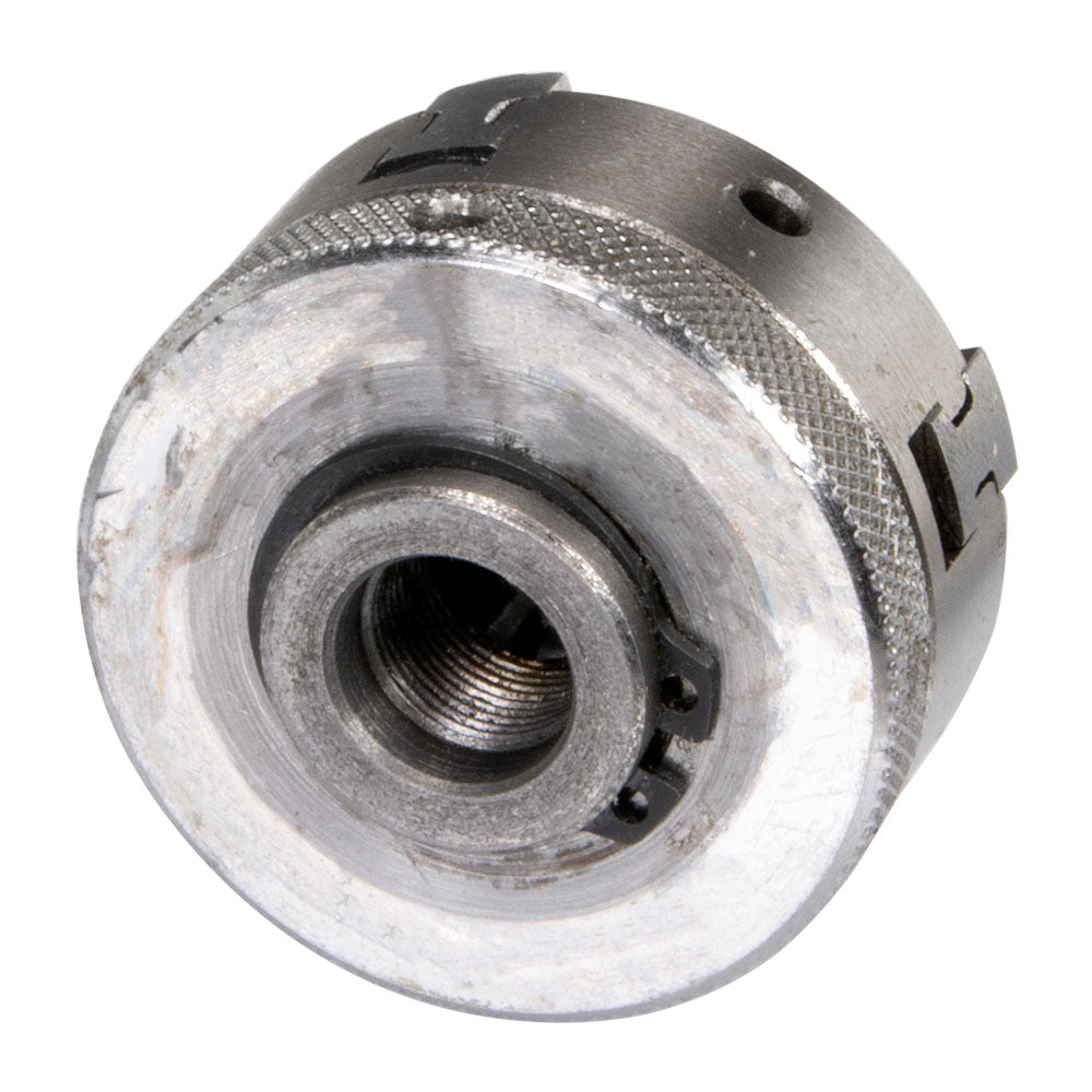

- M14x1 threaded mounting
This 2 inch 4-Jaw self centering lathe chuck fits SIEG C0, Unimat 3 and Unimat 4 lathes. It includes tommy bars, inside and outside jaws, and mounting bolts.
This chuck has a M14x1 threaded through hole (approximately 13mm clearance). It holds work up to 1.89" (48 mm) in diameter.
This chuck requires a 15 mm OD x 14 mm ID bushing to mount on a Unimat 3 or 4.
Mount this chuck on a mini lathe with one of our chuck adapters. Or purchase a chuck with an adapter already mounted.

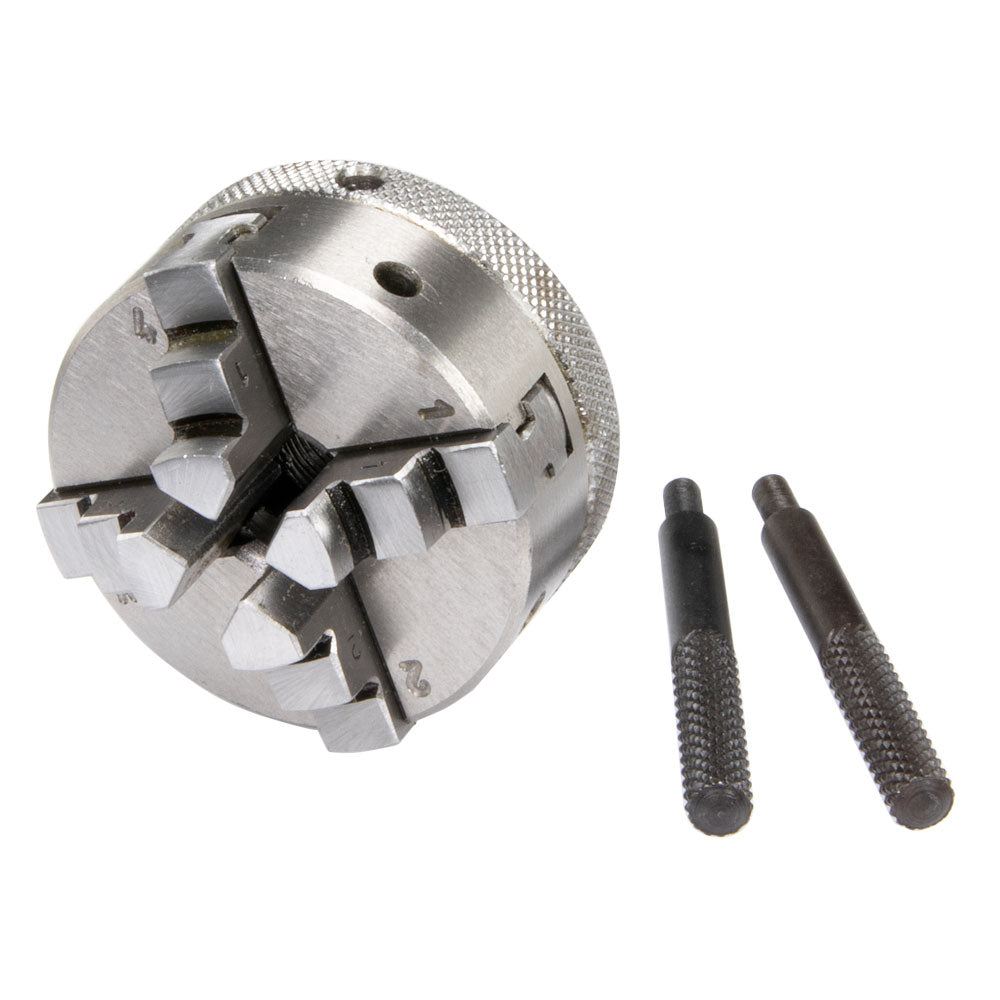

Here is a chart that provides Lathe chuck capacities and mounting dimensions.
Rated Capacity, Inside Jaws: 0.079" - 0.787" (2 mm - 20 mm)
Rated Capacity, Inside Jaws Jamming Range: 0.866" - 1.969" (22 mm - 50 mm)
Rated Capacity, Outside Jaws: 0.787" - 1.890" (20 mm - 48 mm)
Diameter, Overall: 1.969" (50 mm)
Registration Recess Diameter: 0.906" (23 mm)
Center Hole Diameter: 0.512" (13 mm)
Height: 0.906" (23 mm)
Jaw Height Above Face: 0.472" (12 mm)
Height with Jaws: 1.378" (35 mm)
