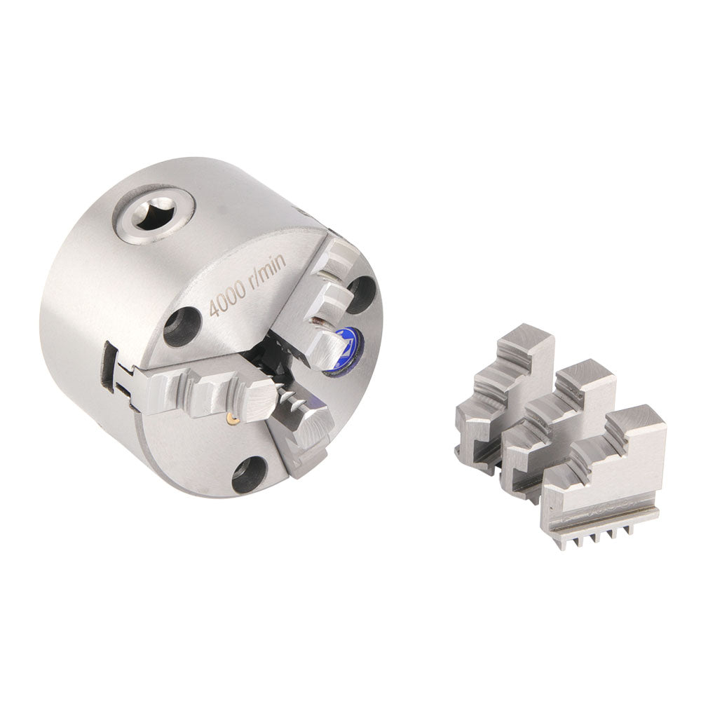

  • 3-jaw Front Mount Lathe Chuck
  • 3" (80 mm) diameter
  • Includes chuck key, inside and outside jaws
  • Plain back mounting with bolts thru from the front
  • High quality steel, hardened and ground
This 3 inch 3-Jaw front mount lathe chuck includes a chuck key, inside and outside jaws, and three M6 mounting bolts.
The chuck has an inside diameter gripping range (outside jaws) of 24-64 mm, and an outside diameter gripping range (inside jaws) of 2-70 mm.
Front mount chucks are designed to be used with rotary tables and other devices where back mounting chucks cannot be used. Easily mount on table, dividing head, fixture, or indexer. This is a plain back chuck and requires a backplate adapter to mount it on a lathe.
Rated Capacity, Inside Jaws: 0.079" - 0.866" (2 mm - 22 mm)
Rated Capacity, Jamming Range: 0.984" - 2.756" (25 mm - 70 mm)
Rated Capacity, Outside Jaws: 0.945" - 2.520" (24 mm - 64 mm)
Diameter, Overall: 3.150" (80 mm)
Registration Recess Diameter: 2.165" (55 mm)
Registration Recess Depth: 0.138" (3.5 mm)
Bolt Circle Diameter: 2.598" (66 mm)
Center Hole Diameter: 0.630" (16 mm)
Height: 1.969" (50 mm)
Jaw Height Above Face: 0.591" (15 mm)
Height with Jaws: 2.598" (66 mm)
Number and Size of Bolts: 3 M6x55
Chuck Key: 0.315" (8 mm)
Chuck Designation: K11-80
