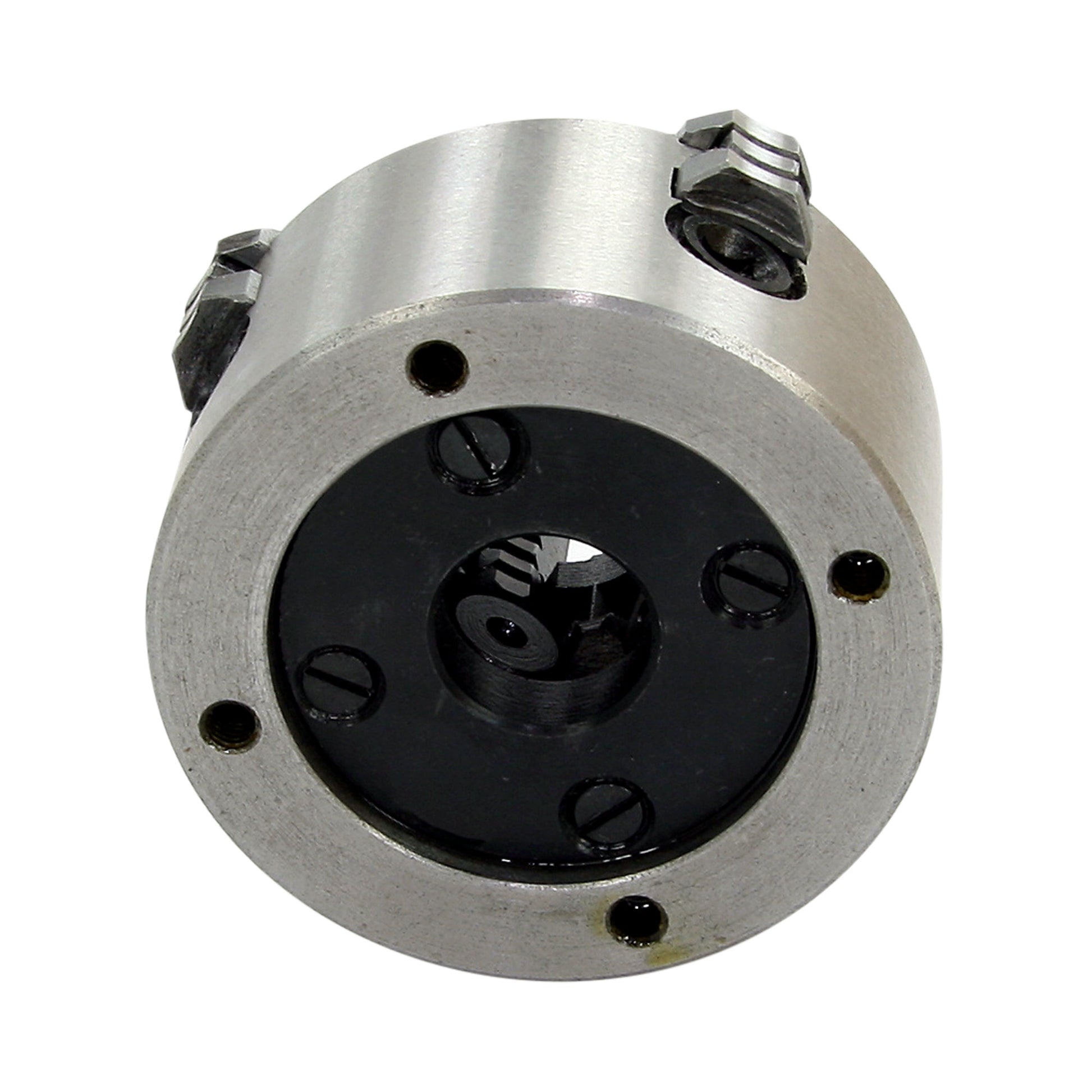

  • 4-jaw lathe chuck
  • 3" (80 mm) diameter
  • Each jaw is independently adjustable and reversible
  • Plain back mounting
  • High quality steel, hardened and ground

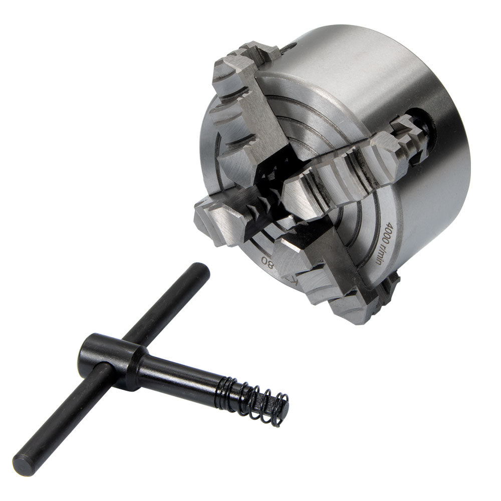

This 4-jaw 3" lathe chuck comes with a chuck key and reversible jaws.
This chuck has a 0.87" (22 mm) through hole. It holds work up to 3.15" (80 mm) in diameter.
*NOTE: * Note Don't forget to purchase a set of Studs & Nuts to accommodate changes in chuck or adapter configurations.
Mount this chuck on a mini lathe with one of our chuck adapters. Or purchase a chuck with an adapter already mounted.
Here is a chart that provides Lathe chuck capacities and mounting dimensions.
Here is a chart that provides lathe chuck capacities and mounting dimensions.
Rated Capacity, Inside Jaws: 0.197" - 1.378" (5 mm - 35 mm)
Rated Capacity, Outside Jaws: 1.378" - 3.150" (35 mm - 80 mm)
Practical Maximum Capacity, Inside Jaws: 2" (50.800 mm)
Practical Maximum Capacity, Outside Jaws: 4" (101.600 mm)
Diameter, Overall: 3.150" (80 mm)
Registration Recess Diameter: 2.165" (55 mm)
Registration Recess Depth: 0.118" (3 mm)
Bolt Circle Diameter: 2.598" (66 mm)
Center Hole Diameter: 0.866" (22 mm)
Height: 1.693" (43 mm)
Jaw Height Above Face: 0.669" (17 mm)
Height with Jaws: 2.362" (60 mm)
Number and Size of Bolts: 4 M6
Chuck Key: 0.236" (6 mm)
Max RPM: 4800 RPM
Chuck Designation: K72-80
