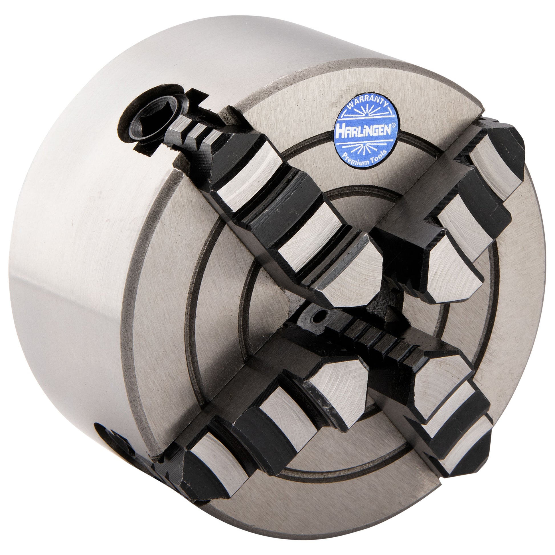

  • Independent 4-Jaw lathe chuck
  • 3" (80 mm) diameter
  • Radial runout maximum of ≤ 0.002" (0.05 mm)
  • High quality components for enhanced wear-resistance

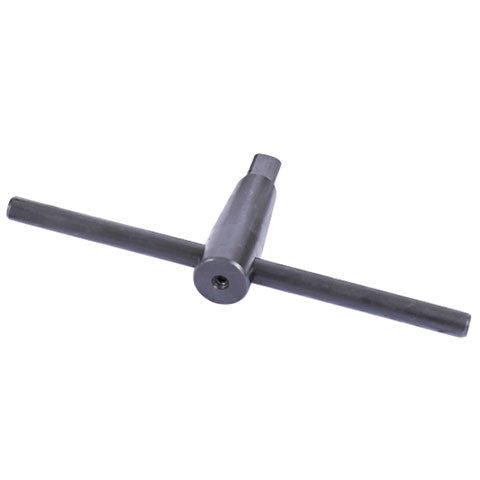

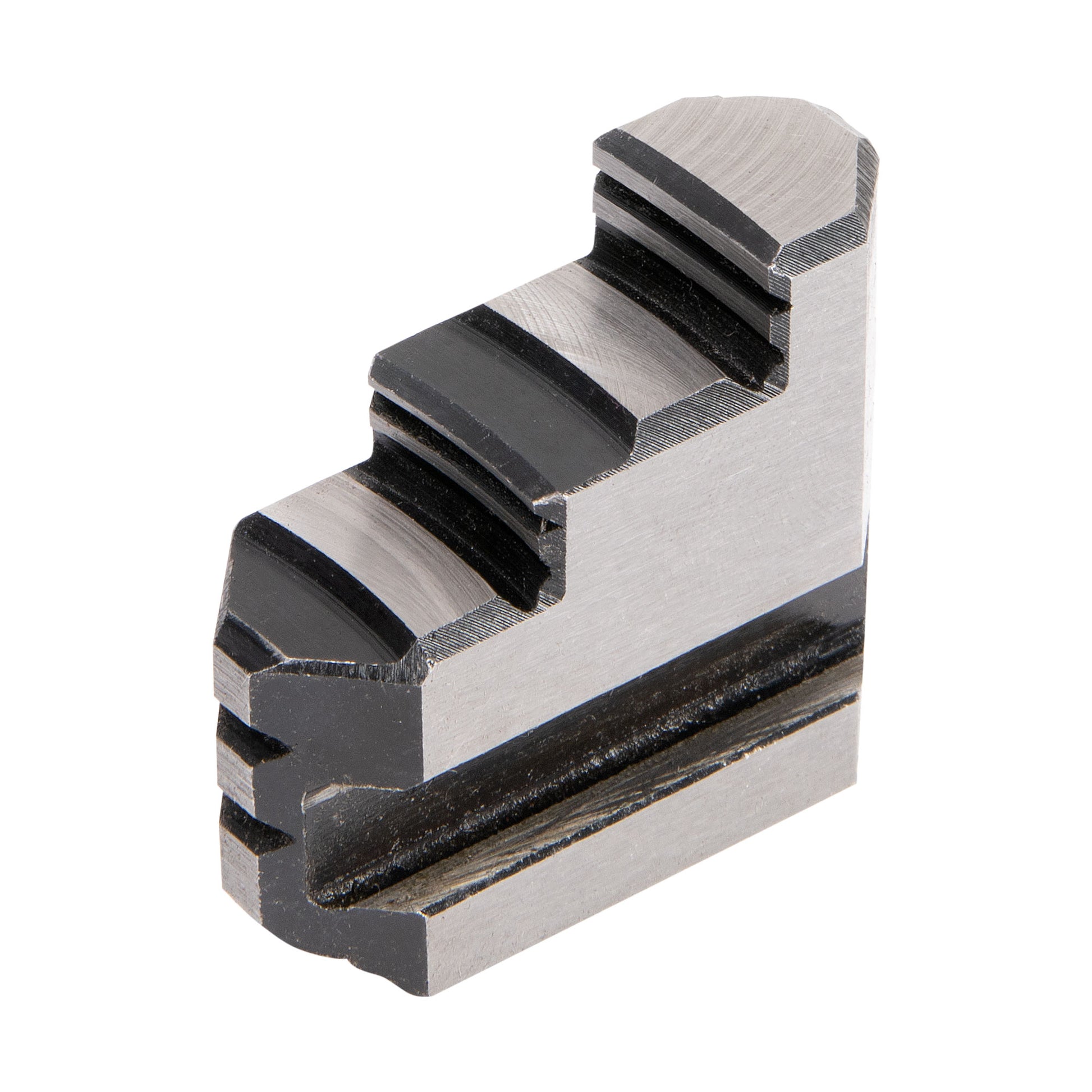

  • Includes chuck key, inside and outside jaws
Harlingen 3 inch 4-jaw independent lathe chuck. The Harlingen chucks have similar specifications to our other lathe chucks in terms of clamping range however they have a better runout and the material construction of the chuck is better.

The jaws are made of 1045 hardened carbon steel and manufactured for precise fit and clamping performance.

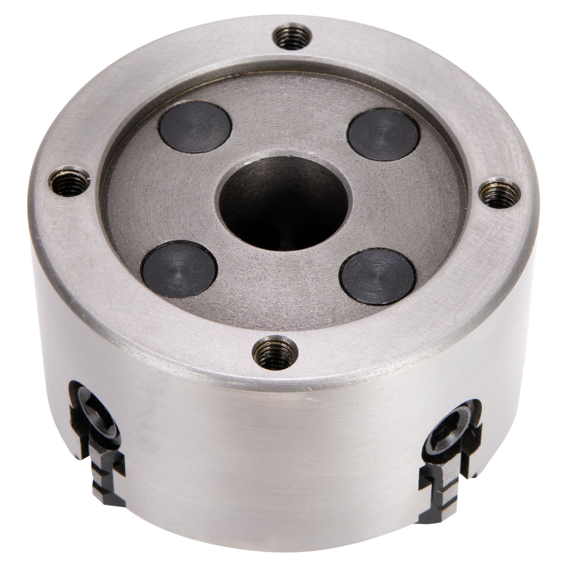

Mount this chuck on a mini lathe with one of our chuck adapters. Or purchase a chuck with an adapter already mounted.

Registration Recess Diameter: 2.165" (55 mm)
Registration Recess Depth: 0.138" (3.5 mm)
Bolt Circle Diameter: 2.598" (66 mm)
Center Hole Diameter: 0.866" (22 mm)
Height: 1.654" (42 mm)
Jaw Height Above Face: 0.551" (14 mm)
Height with Jaws: 2.205" (56 mm)
Number and Size of Bolts: 4 M6
Chuck Key: 0.315" (8 mm)
