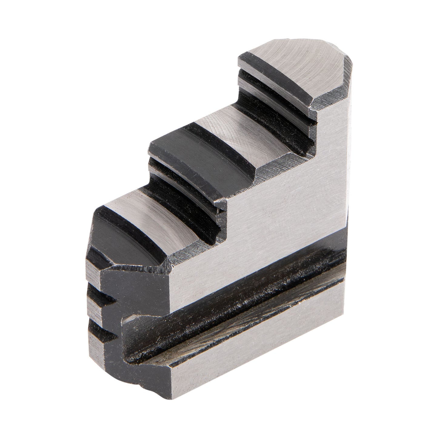

  • Includes chuck key, inside and outside jaws

The jaws are made of 1045 hardened carbon steel and manufactured for precise fit and clamping performance.
