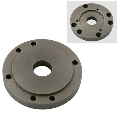

5 inch, 3-Jaw self-centering lathe chuck with adapter mounted for the mini lathe. Includes chuck key, inside and outside jaws.
This 5 inch lathe chuck can hold work up to 4.33" (110 mm) in diameter and comes with an adapter for the HiTorque mini lathe spindle as well as other lathes with a 4" (100mm) spindle flange.

Here is a chart that provides lathe chuck capacities and mounting dimensions.
Rated Capacity, Inside Jaws: 0.098" - 1.575" (2.5 mm - 40 mm)
Rated Capacity, Jamming Range: 1.496" - 4.921" (38 mm - 125 mm)
Rated Capacity, Outside Jaws: 1.496" - 4.331" (38 mm - 110 mm)
Practical Maximum Capacity, Inside Jaws: 2" (50.800 mm)
Practical Maximum Capacity, Outside Jaws: 4" (101.600 mm)
Runout (Max): ≤ 0.003" (0.076mm)
Diameter, Overall: 4.921" (125 mm)
Registration Recess Diameter: 3.740" (95 mm)
Registration Recess Depth: 0.138" (3.5 mm)
Bolt Circle Diameter: 4.252" (108 mm)
Center Hole Diameter: 1.181" (30 mm)
Height: 2.283" (58 mm)
Jaw Height Above Face: 1.102" (28 mm)
Height with Jaws: 3.386" (86 mm)
Number and Size of Bolts: 3 M8
Chuck Key: 0.374" (9.5 mm)
Chuck Designation: K11-125
