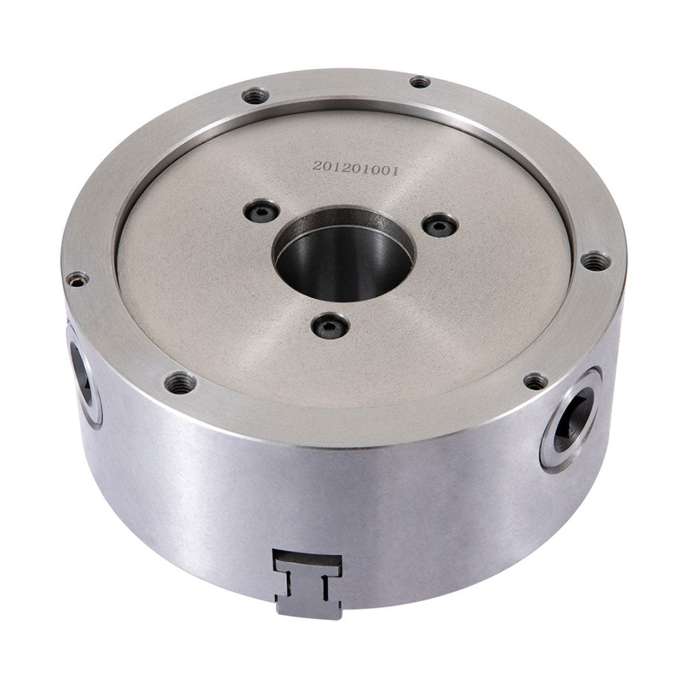

  • Self-centering 3-Jaw lathe chuck
  • 5" (125 mm) diameter
  • Radial runout maximum of ≤ 0.002" (0.05 mm)
  • High quality components for enhanced wear-resistance

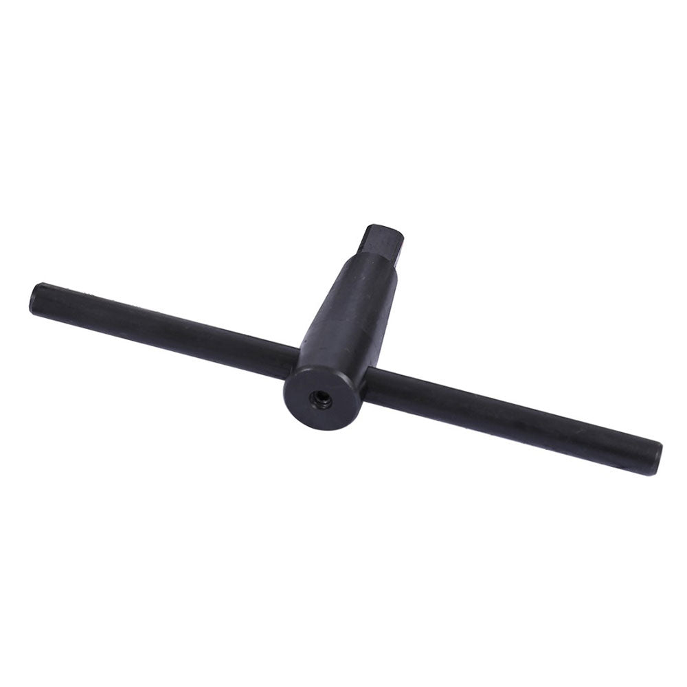

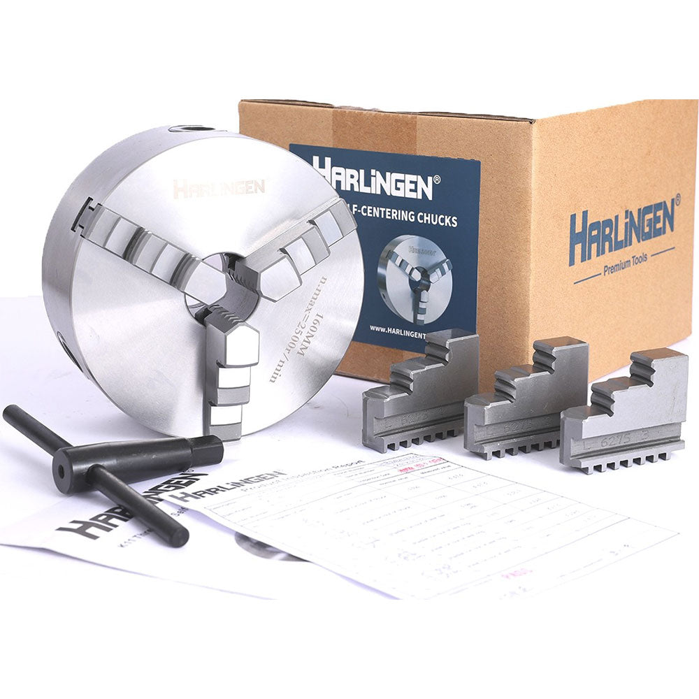

  • Includes chuck key, inside and outside jaws
Harlingen 5 inch 3-jaw self-centering lathe chuck. The Harlingen chucks have similar specifications to our other lathe chucks in terms of clamping range however they have a better runout and the material construction of the chuck is better.
The runout of these chucks is rated at ≤ 0.002" vs ≤ 0.003" for other chucks in this class.
The chuck body is made of wear-resistant cast iron with a higher hardness than similarly made lathe chucks.

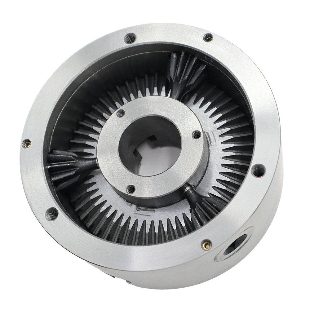

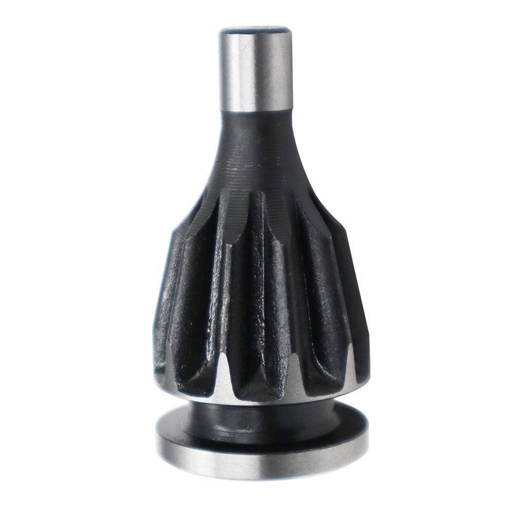

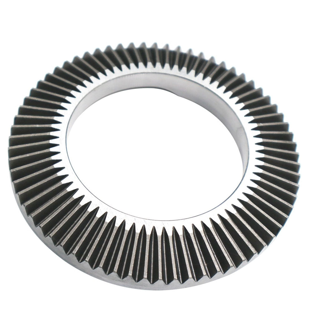

The cover plate, scroll plate and pinions are all constructed of higher quality steels for added strength and resistance to wear.
The jaws are made of 1045 hardened carbon steel and manufactured for precise fit and clamping performance.
Each chuck has in individual serial number and inspection report.
*NOTE: * Note Don't forget to purchase a set of Studs & Nuts to accommodate changes in chuck or adapter configurations.
Mount this chuck on a mini lathe with one of our chuck adapters. Or purchase a chuck with an adapter already mounted.
Here is a chart that provides Lathe chuck capacities and mounting dimensions.
Here is a chart that provides lathe chuck capacities and mounting dimensions.
Rated Capacity, Inside Jaws: 0.094" - 1.575" (2.4 mm - 40 mm)
Rated Capacity, Jamming Range: 1.496" - 4.921" (38 mm - 125 mm)
Rated Capacity, Outside Jaws: 1.496" - 4.331" (38 mm - 110 mm)
Runout (Max): ≤ 0.002" (0.051mm)
Diameter, Overall: 4.921" (125 mm)
Registration Recess Diameter: 3.740" (95 mm)
Registration Recess Depth: 0.138" (3.5 mm)
Bolt Circle Diameter: 4.252" (108 mm)
Center Hole Diameter: 1.181" (30 mm)
Height: 2.283" (58 mm)
Jaw Height Above Face: 1.102" (28 mm)
Height with Jaws: 3.386" (86 mm)
Number and Size of Bolts: 3 M8
Chuck Key: 0.374" (9.5 mm)
Max RPM: 5000 RPM
Chuck Designation: K11-125
