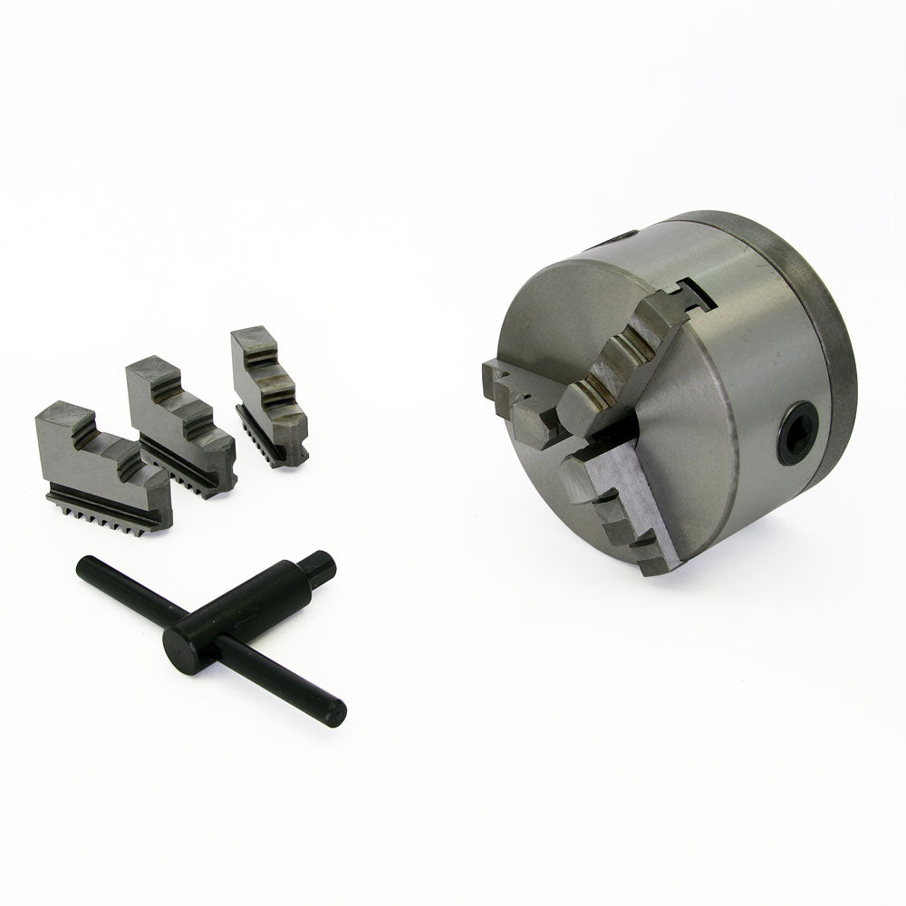

  • 3-jaw self-centering lathe chuck
  • 5" (125 mm) diameter
  • Includes chuck key, inside and outside jaws

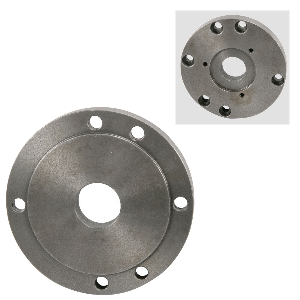

  • Includes an adapter to mount on a 3" (80 mm) flange
  • High-quality steel, hardened and ground
5 inch, 3-Jaw self-centering lathe chuck with adapter mounted for the mini lathe. Includes chuck key, inside and outside jaws.
This 5 inch lathe chuck can hold work up to 4.33" (110 mm) in diameter and comes with an adapter for the mini lathe so that you can bolt it on in place of a 3" (80 mm) chuck.
The radial runout of a test bar held in this chuck, when the chuck is mounted true, is 0.003" maximum.
*NOTE: * Note Don't forget to purchase a set of Studs & Nuts to accommodate changes in chuck or adapter configurations.
