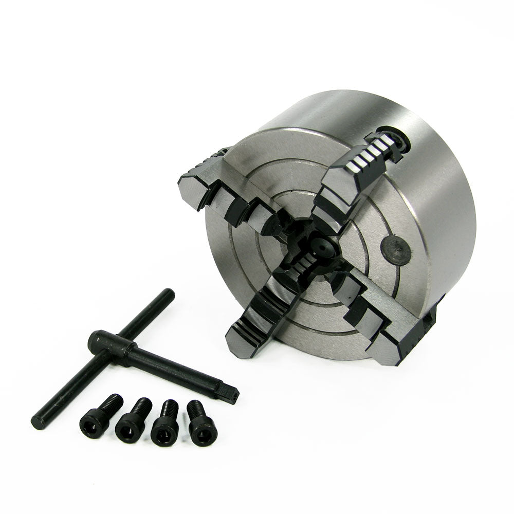

  • 4-Jaw Lathe Chuck
  • 5" (125 mm) diameter
  • Each jaw is independently adjustable and reversible
  • Plain back mounting
  • High quality steel, hardened and ground
5 inch, 4-Jaw independent lathe chuck. Each jaw is independently adjustable and reversible.
The through bore of this chuck is 30 mm (1.18"). The chuck can hold work up to 125 mm (4.92") in diameter.
This is a plain back chuck and requires a backplate adapter to mount it. If purchasing for HiTorque Bench Lathe, please add 6806 Chuck Adapter
*NOTE: * Note Don't forget to purchase a set of Studs & Nuts to accommodate changes in chuck or adapter configurations.
Mount this chuck on a mini lathe with one of our chuck adapters. Or purchase a chuck with an adapter already mounted.
Here is a chart that provides Lathe chuck capacities and mounting dimensions.
Here is a chart that provides lathe chuck capacities and mounting dimensions.
Rated Capacity, Inside Jaws: 0.276" - 2.244" (7 mm - 57 mm)
Rated Capacity, Outside Jaws: 1.890" - 4.921" (48 mm - 125 mm)
Diameter, Overall: 4.921" (125 mm)
Registration Recess Diameter: 3.740" (95 mm)
Registration Recess Depth: 0.177" (4.5 mm)
Bolt Circle Diameter: 4.252" (108 mm)
Center Hole Diameter: 1.181" (30 mm)
Height: 2.205" (56 mm)
Jaw Height Above Face: 0.827" (21 mm)
Height with Jaws: 2.638" (67 mm)
Number and Size of Bolts: 4 M8
Chuck Key: 0.274" (6.95 mm)
Chuck Designation: K72-125
