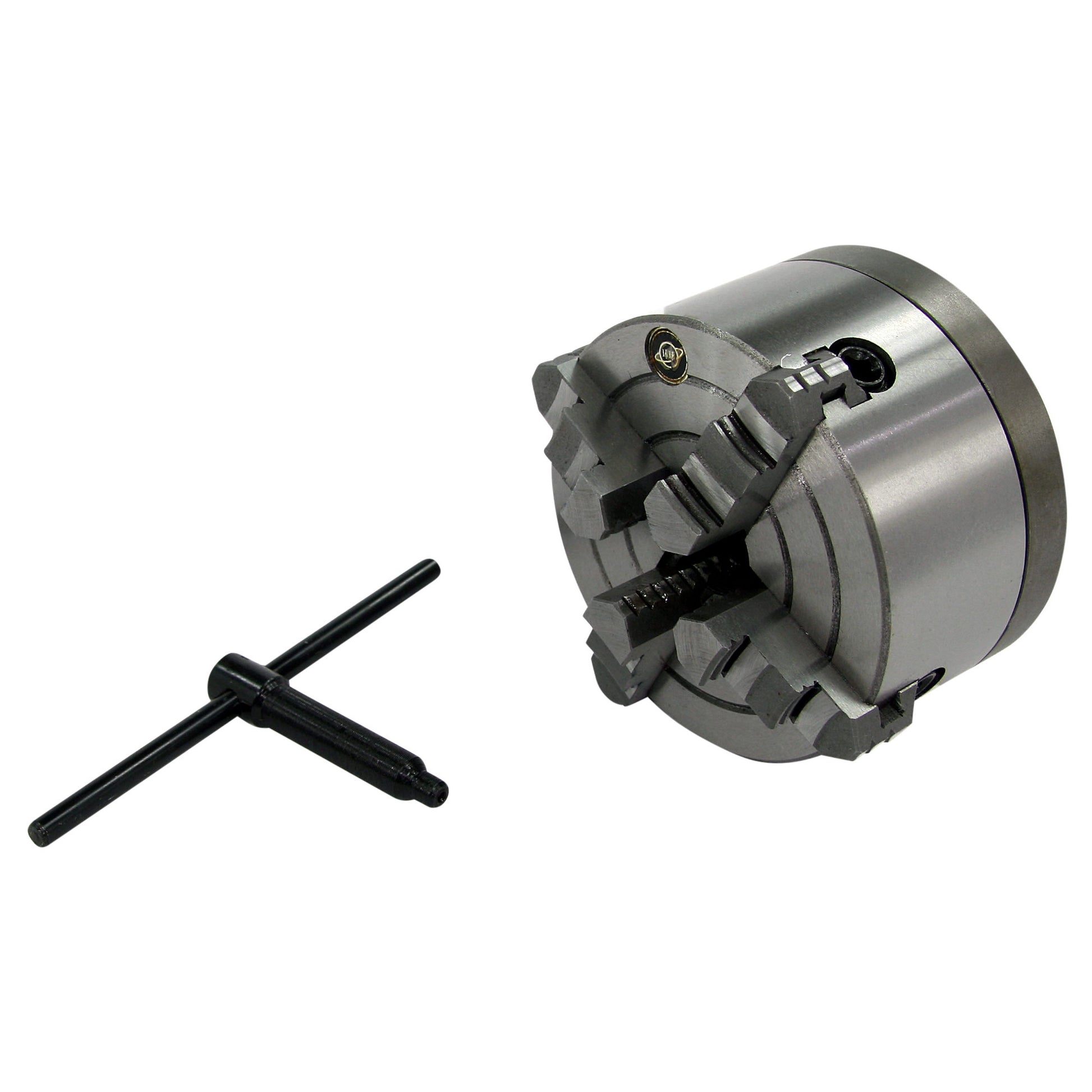

  • 4-Jaw Lathe Chuck for Sale
  • 5" (125 mm) diameter
  • Each jaw is independently adjustable and reversible
  • Includes an adapter to mount on a 4" 100 mm) flange
  • Plain back mounting
This 5-inch chuck (2338) can hold work up to 125 mm (4.92") in diameter and comes with an adapter (2961) for the HiTorque mini lathe spindle as well as other lathes with a 4" (100mm) spindle flange. The through bore of this chuck is 30 mm (1.18"). Each jaw is independently adjustable and reversible.
*NOTE: * Note Don't forget to purchase a set of Studs & Nuts to accommodate changes in chuck or adapter configurations.
Here is a chart that provides lathe chuck capacities and mounting dimensions.
Rated Capacity, Inside Jaws: 0.276" - 2.244" (7 mm - 57 mm)
Rated Capacity, Outside Jaws: 1.890" - 4.921" (48 mm - 125 mm)
Diameter, Overall: 4.921" (125 mm)
Registration Recess Diameter: 3.740" (95 mm)
Registration Recess Depth: 0.177" (4.5 mm)
Bolt Circle Diameter: 4.252" (108 mm)
Center Hole Diameter: 1.181" (30 mm)
Height: 2.205" (56 mm)
Jaw Height Above Face: 0.827" (21 mm)
Height with Jaws: 2.638" (67 mm)
Number and Size of Bolts: 4 M8
Chuck Key: 0.274" (6.95 mm)
Chuck Designation: K72-125
