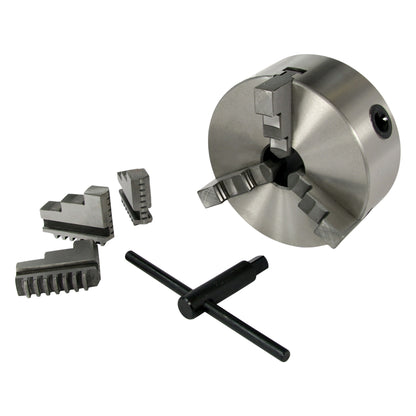

5", 3-jaw lathe chuck (2337) with adapter (6741) designed exclusively for the HiTorque 9x20 bench lathes models 7600 and 7650. Three mounting studs and nuts included.
Here is a chart that provides lathe chuck capacities and mounting dimensions.
Rated Capacity, Inside Jaws: 0.098" - 1.575" (2.5 mm - 40 mm)
Rated Capacity, Jamming Range: 1.496" - 4.921" (38 mm - 125 mm)
Rated Capacity, Outside Jaws: 1.496" - 4.331" (38 mm - 110 mm)
Practical Maximum Capacity, Inside Jaws: 2" (50.800 mm)
Practical Maximum Capacity, Outside Jaws: 4" (101.600 mm)
Runout (Max): ≤ 0.003" (0.076mm)
Diameter, Overall: 4.921" (125 mm)
Registration Recess Diameter: 3.740" (95 mm)
Registration Recess Depth: 0.138" (3.5 mm)
Bolt Circle Diameter: 4.252" (108 mm)
Center Hole Diameter: 1.181" (30 mm)
Height: 2.283" (58 mm)
Jaw Height Above Face: 1.102" (28 mm)
Height with Jaws: 3.386" (86 mm)
Number and Size of Bolts: 3 M8
Chuck Key: 0.374" (9.5 mm)
Max RPM: 4900 RPM
