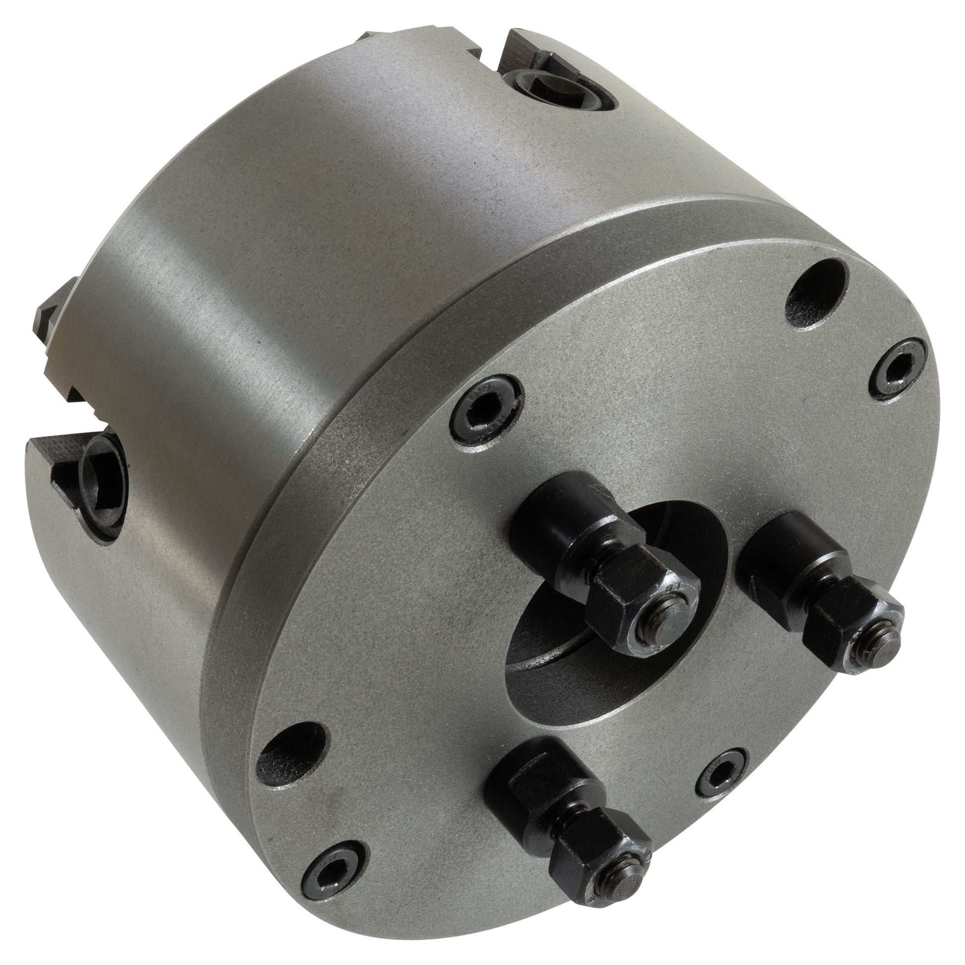

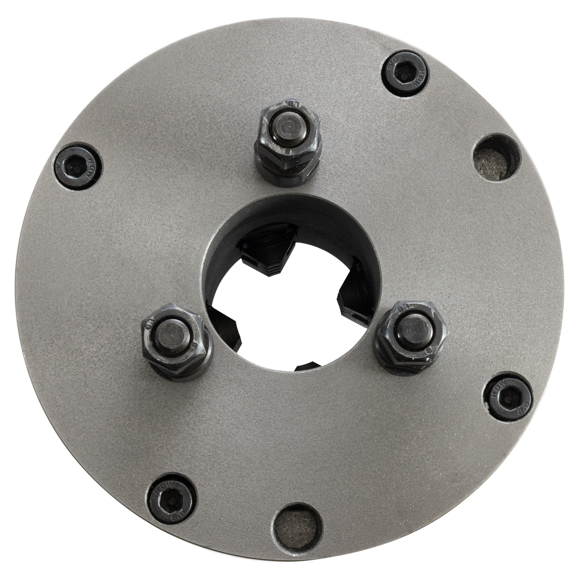

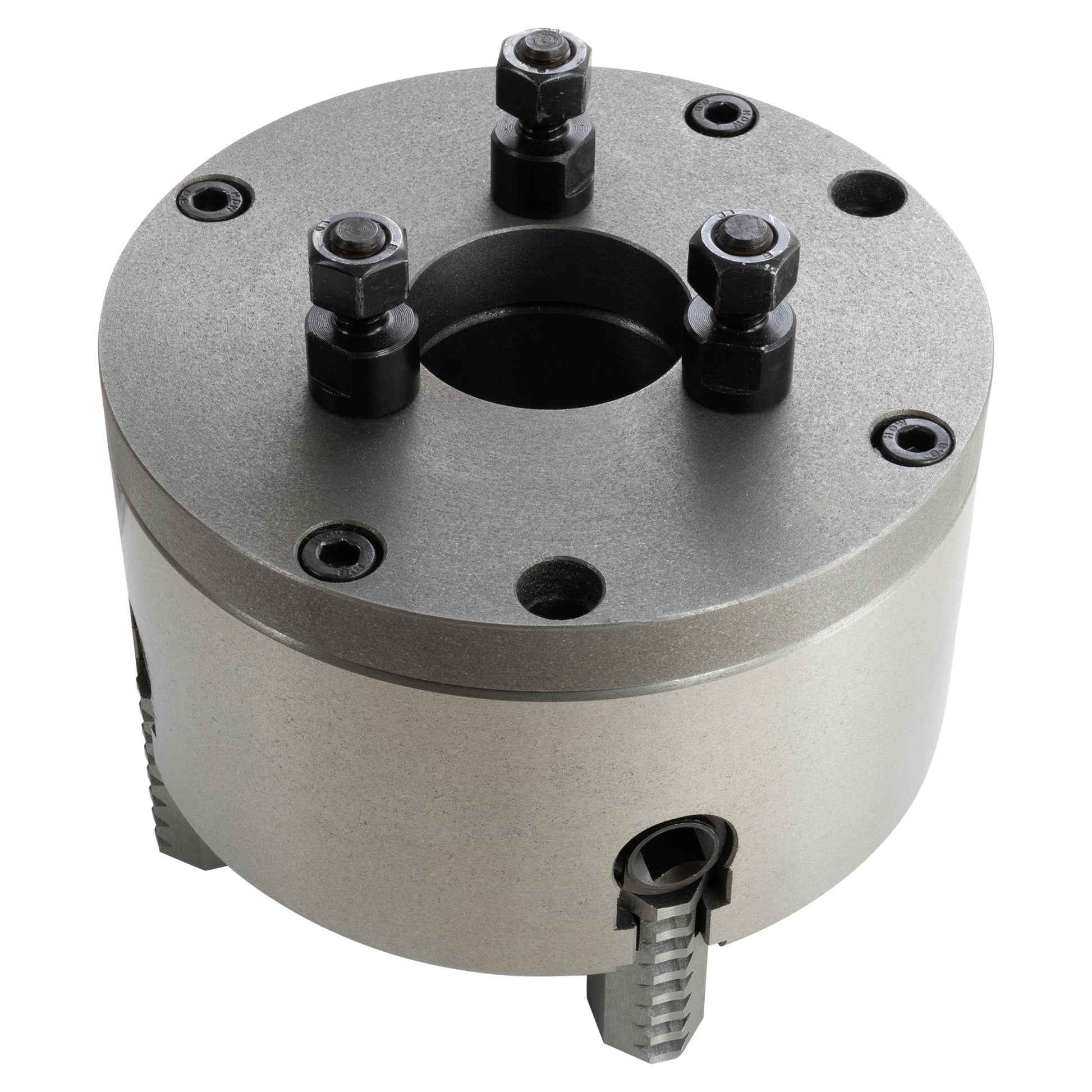

  • 6 Inch, 4-jaw independent lathe chuck
  • Adapter plate and mounting bolts
  • Fits only the HiTorque 9x20 bench lathes, models 7600/7650
6", 4-jaw lathe chuck (2038) with adapter (4912) designed exclusively for the HiTorque 9x20 bench lathes models 7600 and 7650. Three mounting studs and nuts included.

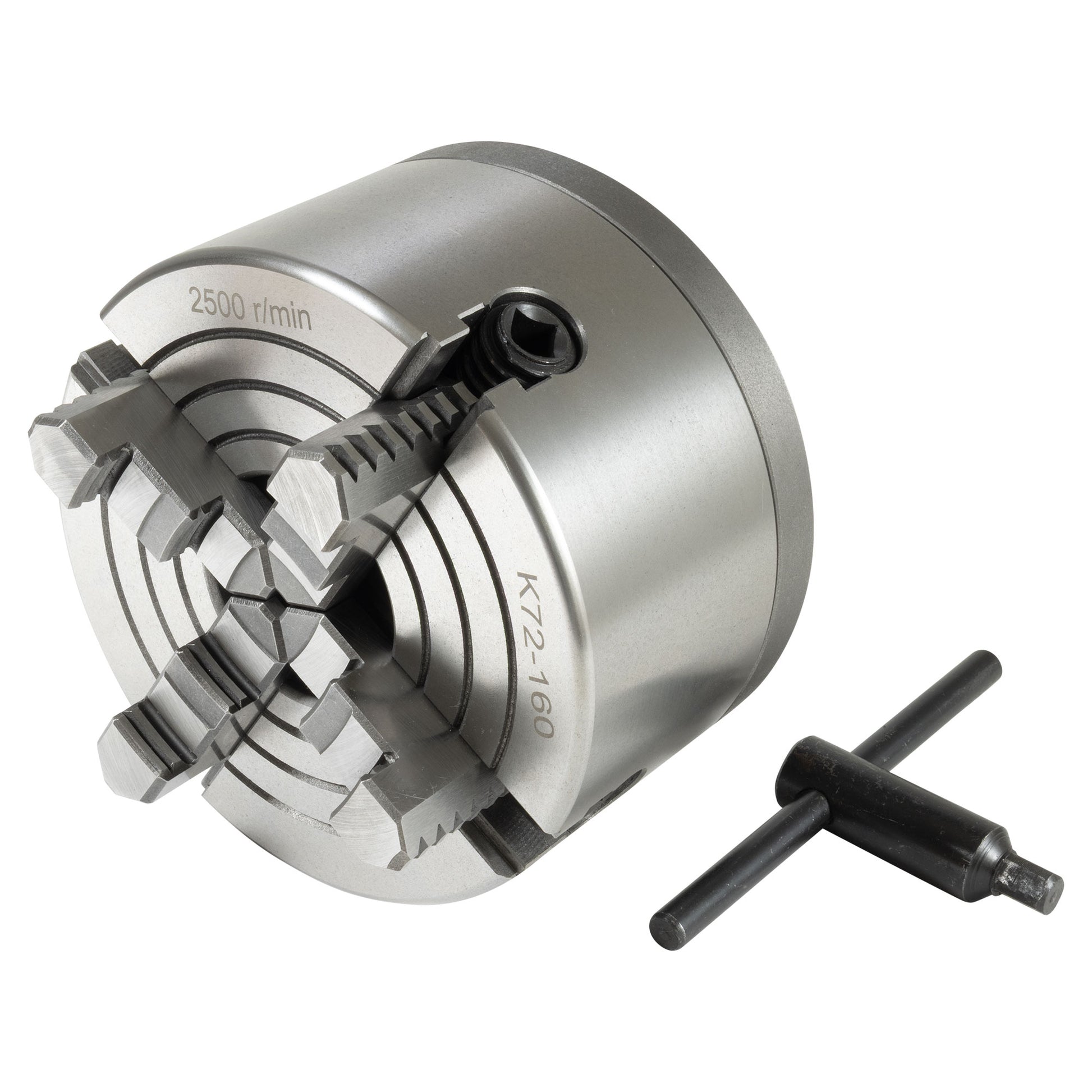

Here is a chart that provides lathe chuck capacities and mounting dimensions.
Rated Capacity, Inside Jaws: 0.315" - 3.150" (8 mm - 80 mm)
Rated Capacity, Outside Jaws: 1.969" - 6.299" (50 mm - 160 mm)
Diameter, Overall: 6.299" (160 mm)
Registration Recess Diameter: 5.118" (130 mm)
Registration Recess Depth: 0.197" (5 mm)
Bolt Circle Diameter: 5.709" (145 mm)
Center Hole Diameter: 2.165" (55 mm)
Height: 2.953" (75 mm)
Number and Size of Bolts: 4 M8
Max RPM: 3800 RPM
Chuck Designation: K72-160
