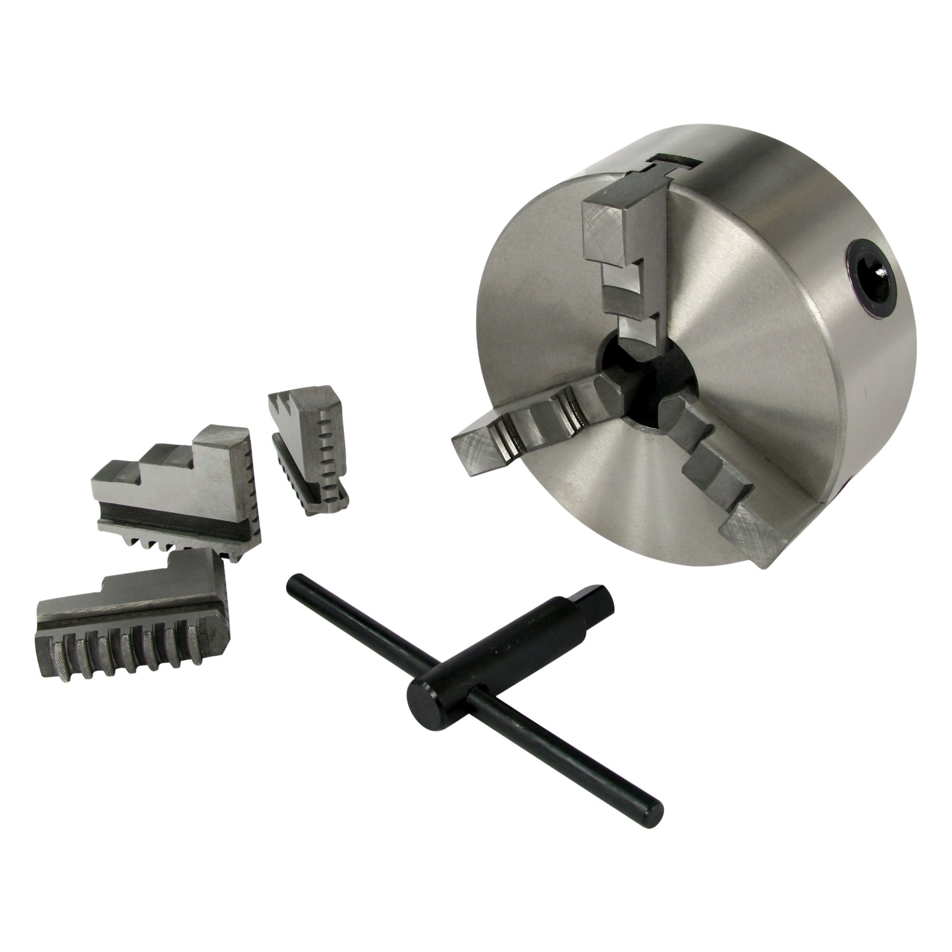

  • 3-jaw self centering lathe chuck
  • 6" (160 mm) diameter
  • Includes chuck key, inside and outside jaws
  • Plain back mounting
  • High quality steel, hardened and ground
This 6 inch 3-Jaw self-centering lathe chuck includes a chuck key, inside and outside jaws, and mounting bolts.
This chuck has a 1.57" (40 mm) through hole. The chuck can hold work up to 5.70" (145 mm) in diameter.
This is a plain back chuck and requires a backplate adapter to mount it.
The radial runout of a test bar held in this chuck, when the chuck is mounted true, is 0.003" maximum.
*NOTE: * Note Don't forget to purchase a set of Studs & Nuts to accommodate changes in chuck or adapter configurations.
Mount this chuck on a mini lathe with one of our chuck adapters. Or purchase a chuck with an adapter already mounted.
