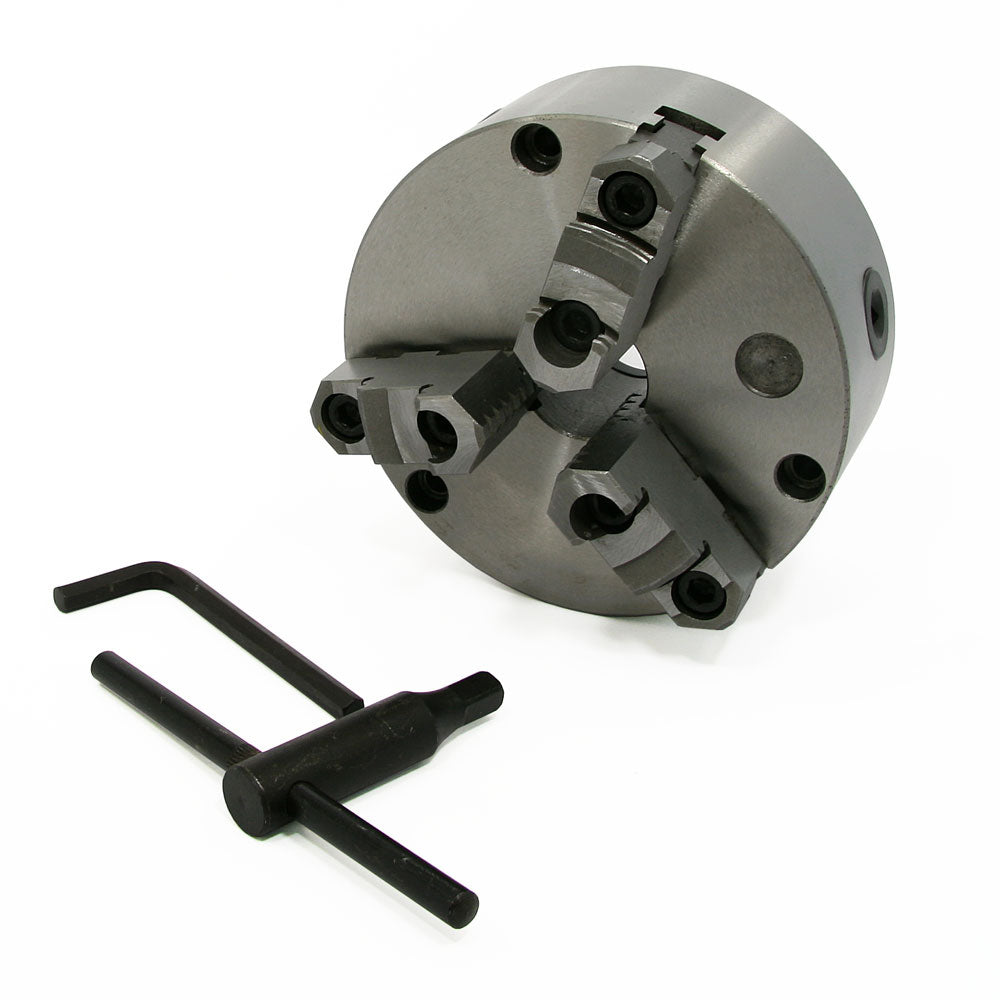

  • 3-jaw self centering lathe chuck
  • 6" (160 mm) diameter
  • Includes chuck key and reversible top jaws
  • Plain back mounting with bolts thru from the front
  • High quality steel, hardened and ground
This 6 inch 3-Jaw self-centering lathe chuck includes a chuck key, reversible top jaws, and mounting bolts.
This chuck has a 1.57" (40 mm) through hole. The chuck can hold work up to 5.70" (145 mm) in diameter.
This is a plain back chuck and requires a backplate adapter to mount it. Front mount chucks are designed to be used with rotary tables and other devices where back mounting chucks cannot be used.
The radial runout of a test bar held in this chuck, when the chuck is mounted true, is 0.004" maximum.
Here is a chart that provides lathe chuck capacities and mounting dimensions.
Rated Capacity, Inside Jaws: 0.118" - 2.165" (3 mm - 55 mm)
Rated Capacity, Jamming Range: 1.969" - 6.299" (50 mm - 160 mm)
Rated Capacity, Outside Jaws: 2.165" - 5.709" (55 mm - 145 mm)
Runout (Max): ≤ 0.003" (0.081mm)
Diameter, Overall: 6.299" (160 mm)
Registration Recess Diameter: 5.118" (130 mm)
Registration Recess Depth: 0.197" (5 mm)
Bolt Circle Diameter: 5.591" (142 mm)
Center Hole Diameter: 1.772" (45 mm)
Height: 2.559" (65 mm)
Jaw Height Above Face: 1.181" (30 mm)
Height with Jaws: 3.740" (95 mm)
Number and Size of Bolts: 3 M8
Chuck Key: 0.374" (9.5 mm)
Max RPM: 3600 RPM
Chuck Designation: K11-160
